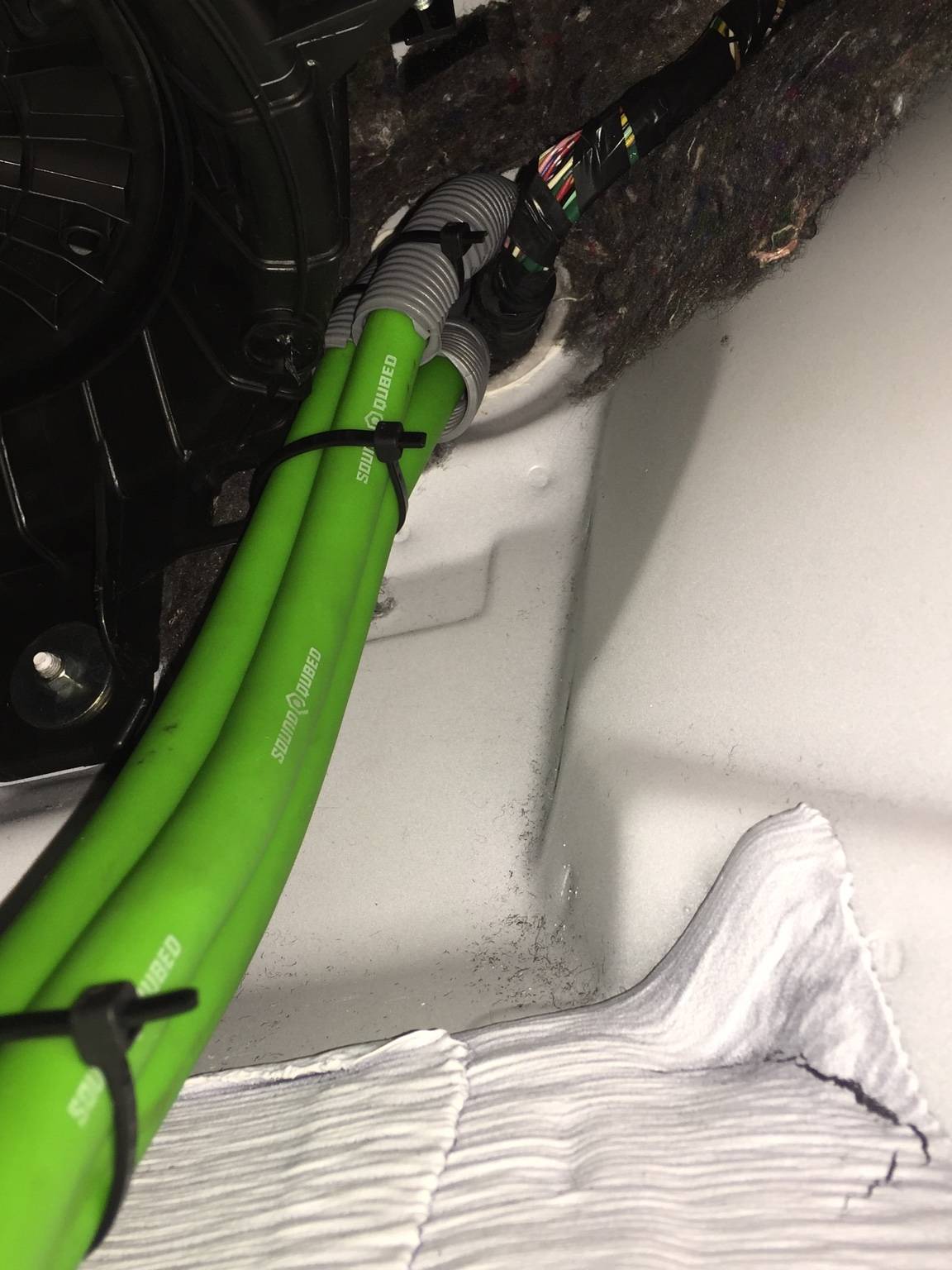

Here is how I did mine in my 2011 Camry.

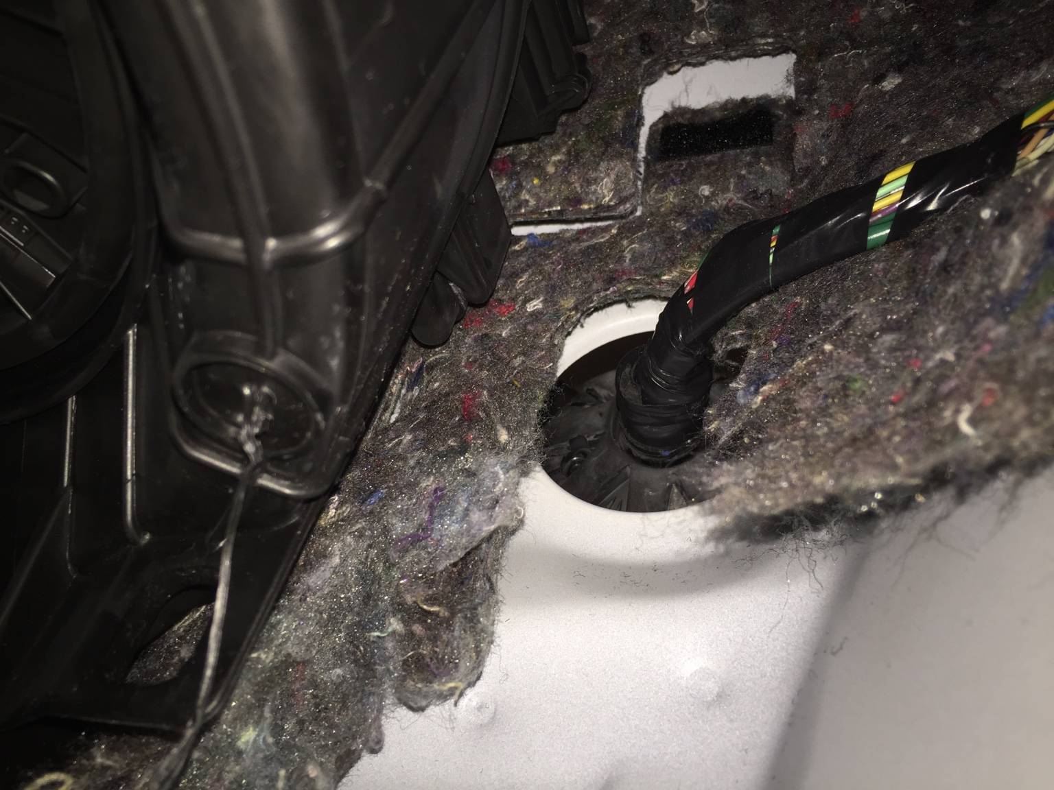

Passenger side grommet where the stock wires run through

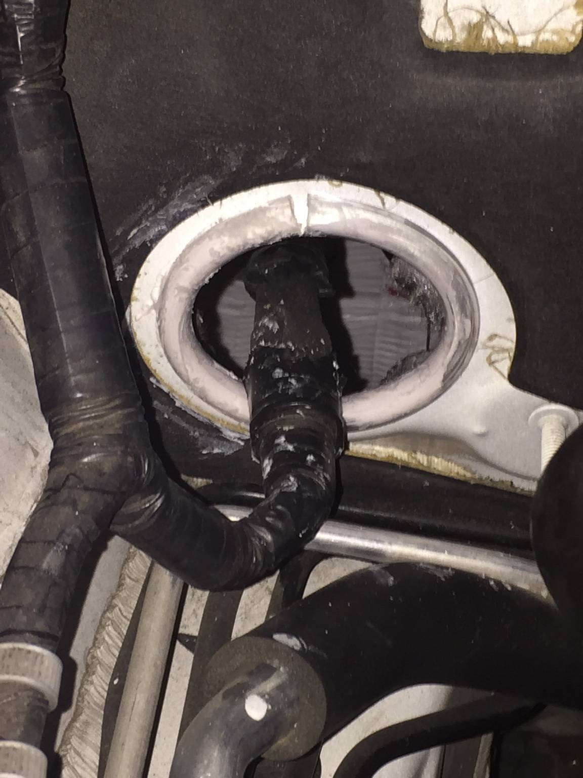

I removed the grommet, took vinyl tubing and cut a slit down it then filled it with silicone and put it around the metal to protect the wires
All done
