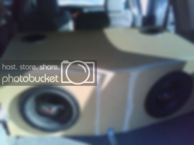

Did I make my box to big?
I have 12s seeing 5cu+ each after displacement. Don't let people tell you that you are free airing. If you are clipping you have one of two problems: you have a bad input signal, or you are under voltage on the amp/overpower on your subs
not clipping just starving them of port area, plus that box is too big for the power (and in general for that matter)
I should slap you for saying something like that Sac...
Ok what if I got 2 15s and made the port bigger? If that will work what 15s would be good on a budget?
No need to go with larger subs until you've tried gaining port. If you still have issues, you can always upgrade cone area/or motor strength.
