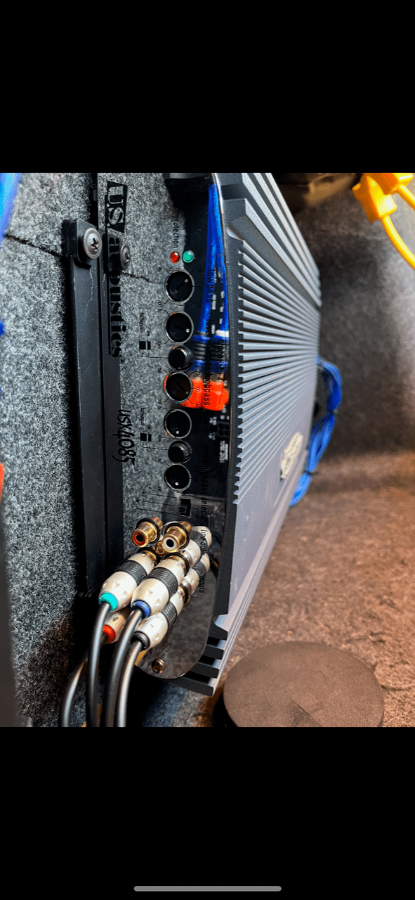

Hello Everybody,
Due to an incorrect install from a local stereo shop one the channels of my Alpine PDX-F4 is no longer working.
I was told something may be lose inside. Anyhow I have a 4ga power and ground cables and have just had my back up amp US Acoustics USX4085 amp installed.
Previously I have all 8ga power and ground when I had this same US Acoustics amp installed and it sounded great and even at very high volumes and kept the same settings, gain is at about 3/4. Currently it sounds great, crystal clear and detailed until i play music at high volumes for over 5 minutes (Volume 25 of 40 ) from my Kenwood Excelon XR997 heaunit. The Sound qulaity, dimishes and loses some clarity almost blury and no longer clean and detailed. After the instal i did notice right away that this amp sounded more powerful and louder at lower to high volumes compared to previously with all 8ga power and ground. Should I start by lowering the gain on this amp or ?

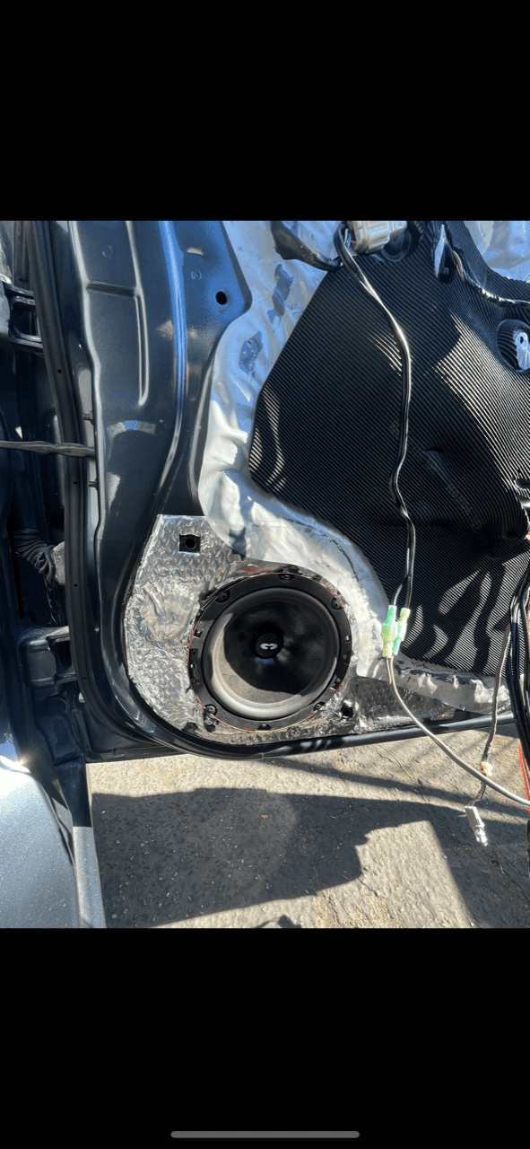

I believe the x-over from my 6.5” components (driver’s side) is faulty and not producing clean, clear sounds like front passenger’s side.
I did have 8ga previously and now 4ga. The Alpine Mono amp didn’t get too warm and neither the US Acoustics. Last night i turn down the gain on the US Acoustics from 3/4 to a gair over 1/2 and it sounds better.

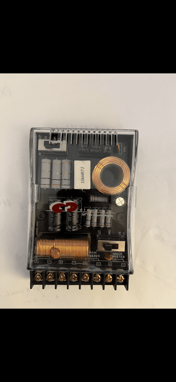

***PROBLEM FOUND AND SOLVED***
After so much trouble shooting I decided to take a chance and replace my driver's side door CDT Audio component x-over since i had noticed an obvious sound quaity issue. I got the front driver's side replaced and my sounds were restored to crystal clean sound once again and the issue with the overall diminishing sound quality was resolved!
The new CDT X-overs are an upgraded version so i decided to changed the front passanger's side as well.
My sound quality and detail are back to how its was for years and very happy this was finally figured out and fixed. Never knew that one faulty X-Over can would affect both sides of the door creating that drastic SQ to diminish.
