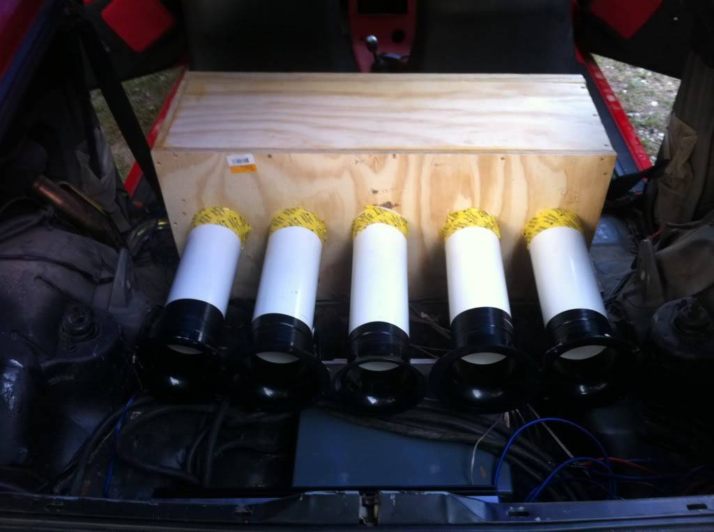

Lol. Has nothing to do with the vehicle. Externally mounting a port makes it more efficient. To get the most out of your port, they should all be mounted like that. But because of the length and the fact that it looks stupid, it's hardly ever the case.
Tou answer your question specifically, 6" inside and 24" outside is just like 30" inside... but better. Lol. I mount ALL of my SPL ports externally and most of my dailys. IDGAF what it looks like as long as it's loud.
Just a few examples. Lol.

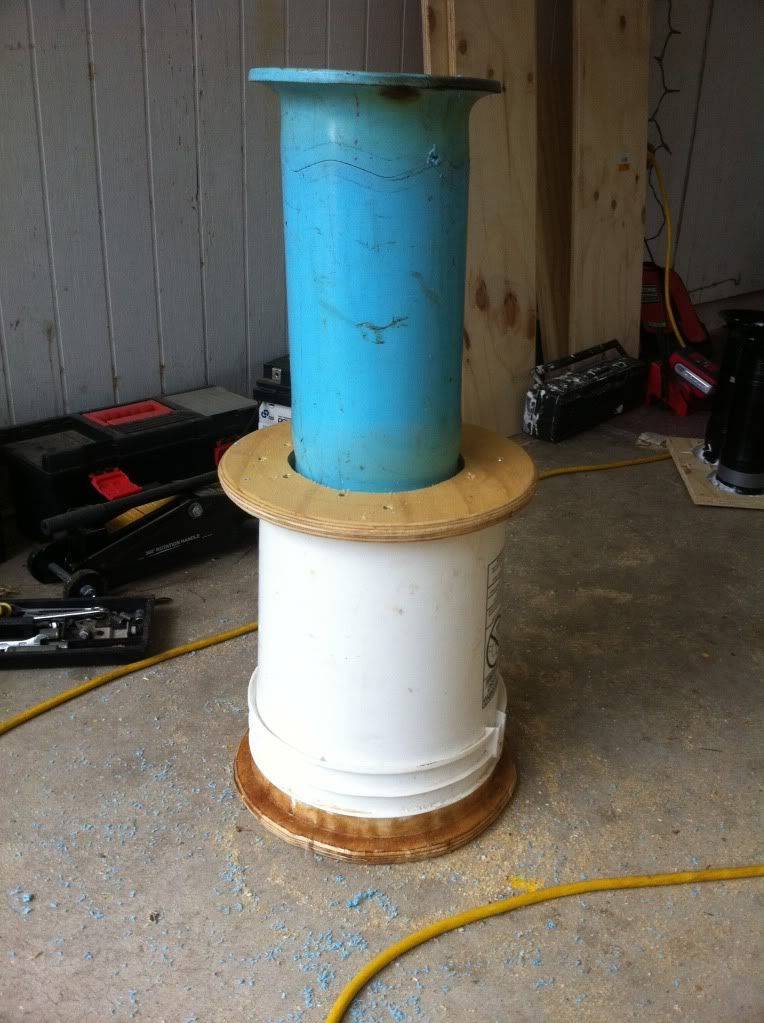

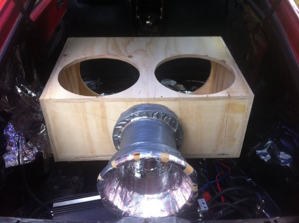

**** taylor.....that last pic with the 8 American Bass subs is sick.....how did you make that port on that one and how did you mount it to the box?
Also good to know that this is possible and actually better....learn something new everyday lol.....plus opens up whole new design possibilities for me now....

The PVC flares you see were done by making a form for whatever size port we were making. Then we heated a big *** pot of cooking oil to 350*. Soak the PVC in that oil for a minute or so and it gets pretty buttery. Push it down onto that form and voila, instant aero. Well, after it cools, of course. It's messy business, but makes some pretty sweet ports.
On that port (it's an 8"), I made one side flared, but pushed down on it a little further to flatten it out essentially making it a mounting flare.
Should be noted that I rarely mount the actual flare to the box. Normally, I make the cutout juuuuust big enough to beat the tube into and then mount the flares on either side. This makes manipulating tuning and/or impedance rise easier because you can just slide it in and out and test how much in and out is the best combo.
