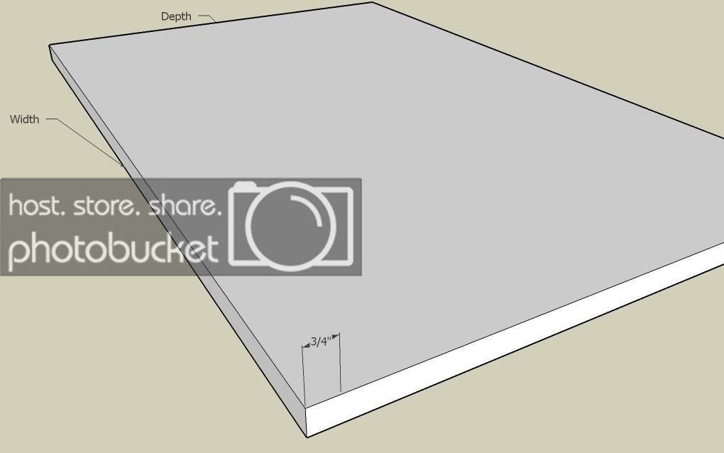

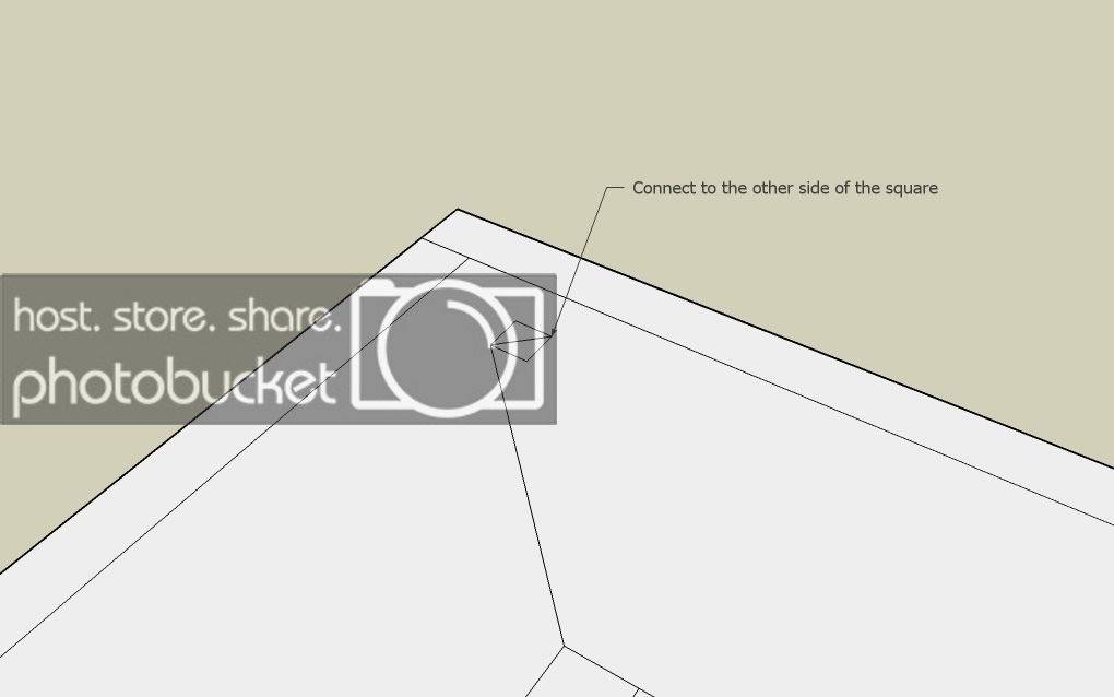

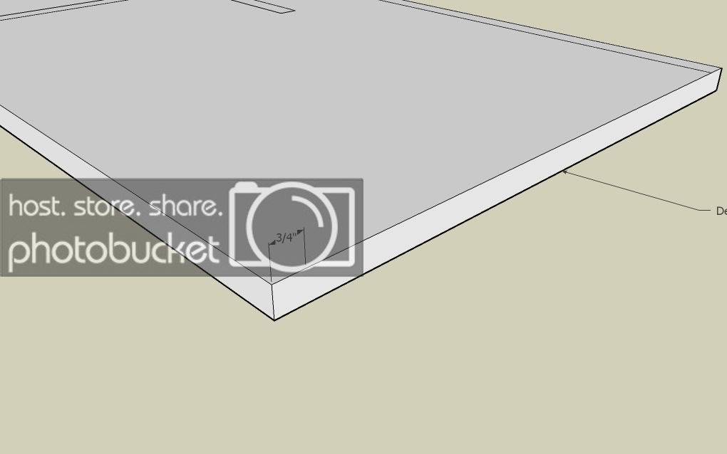

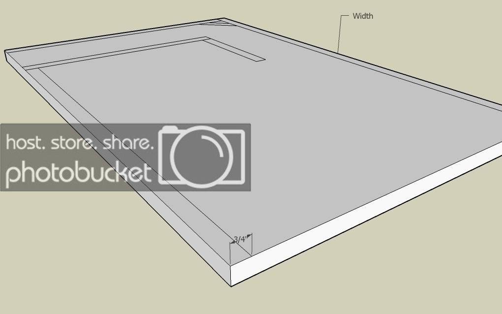

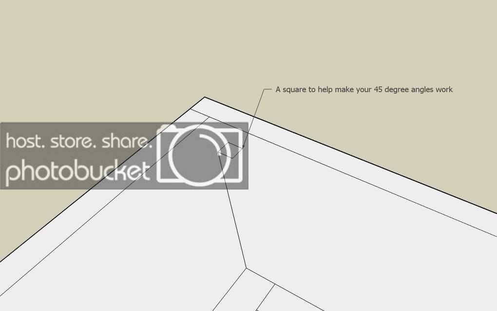

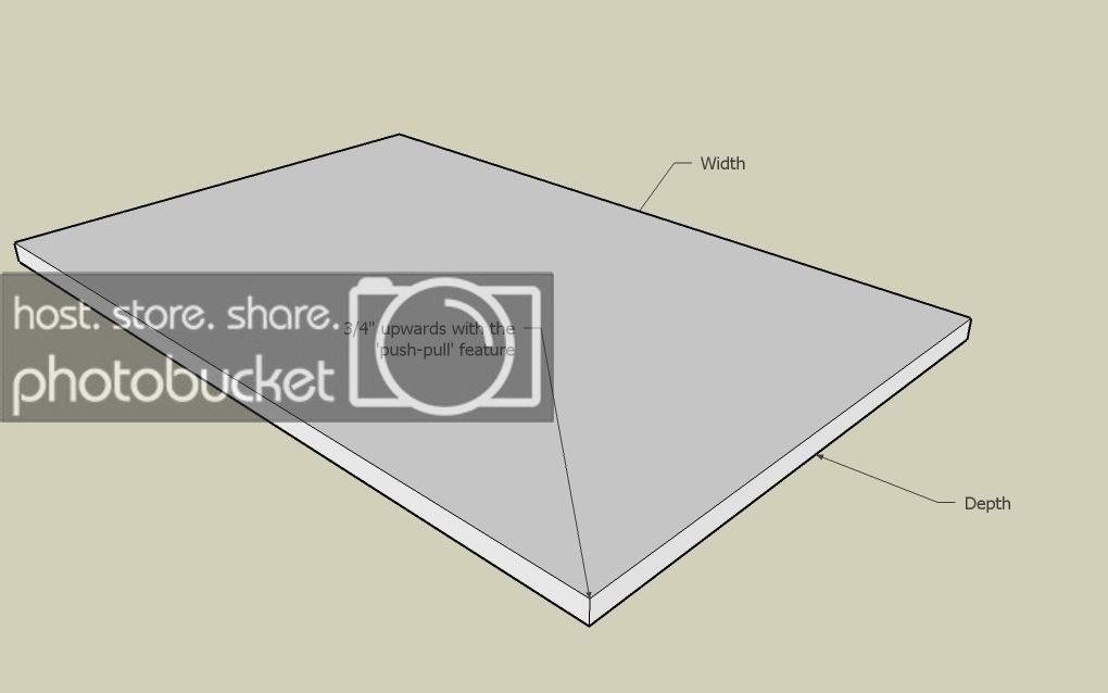

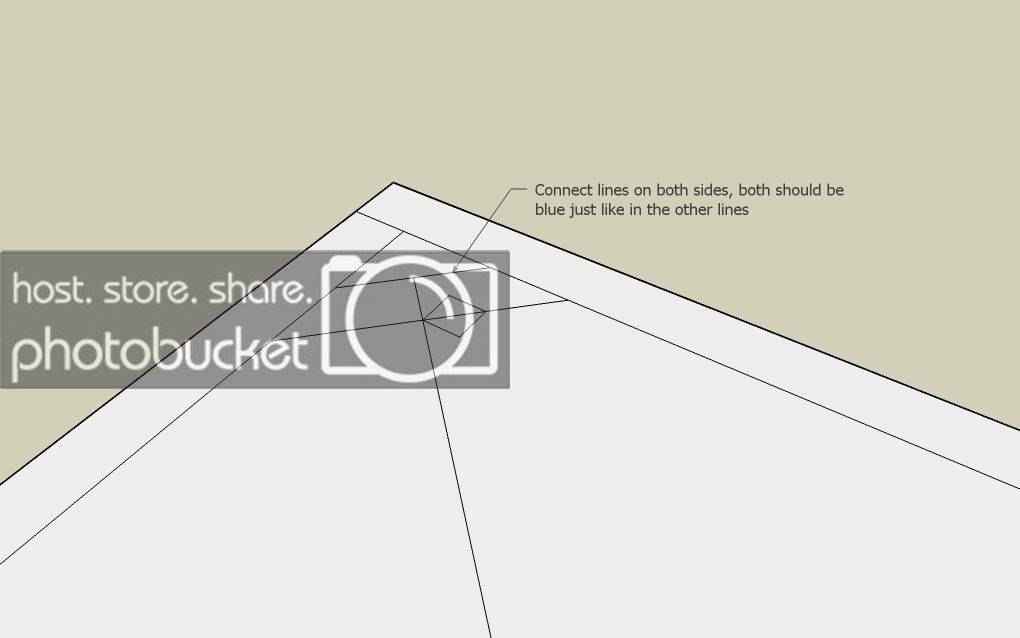

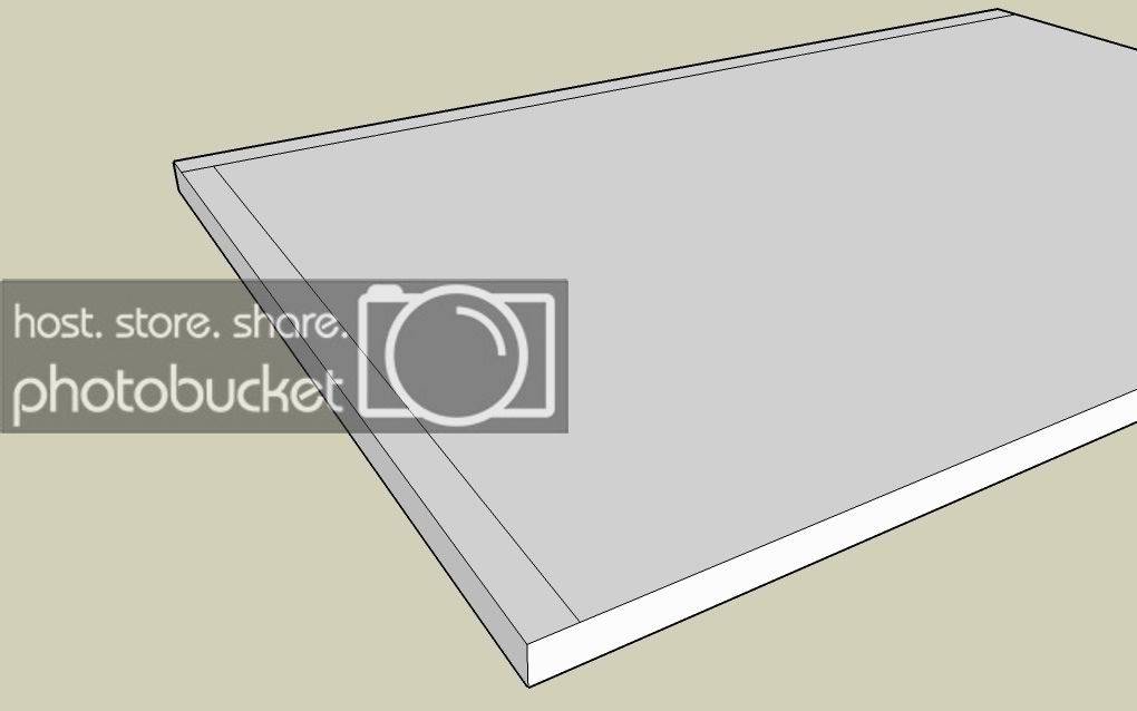

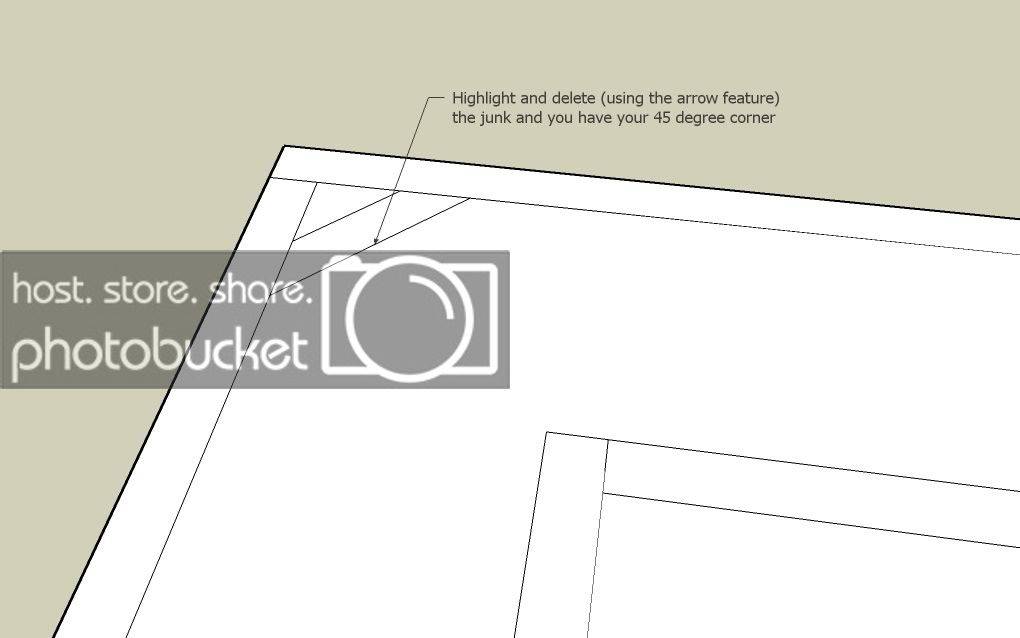

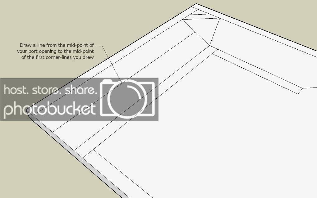

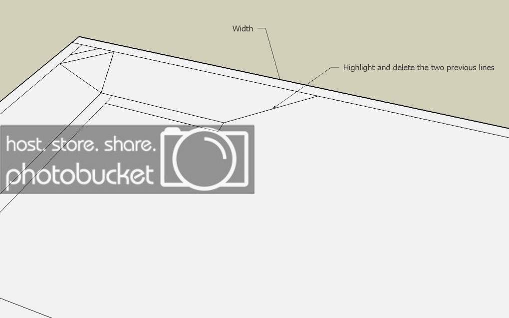

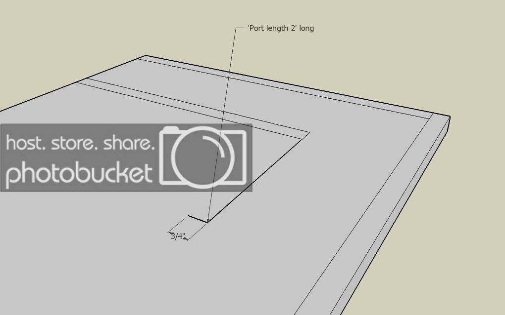

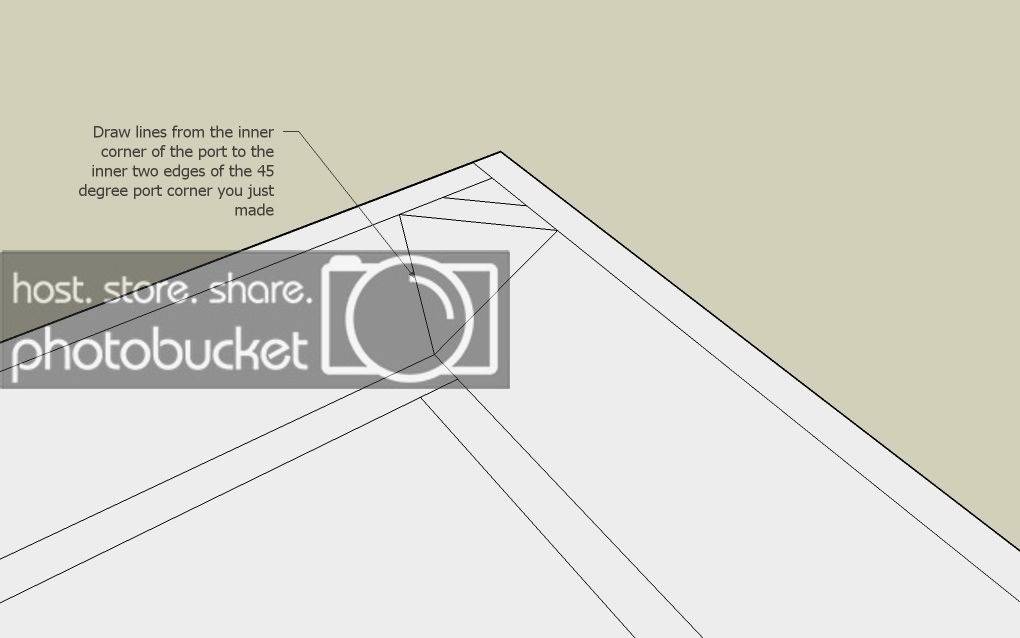

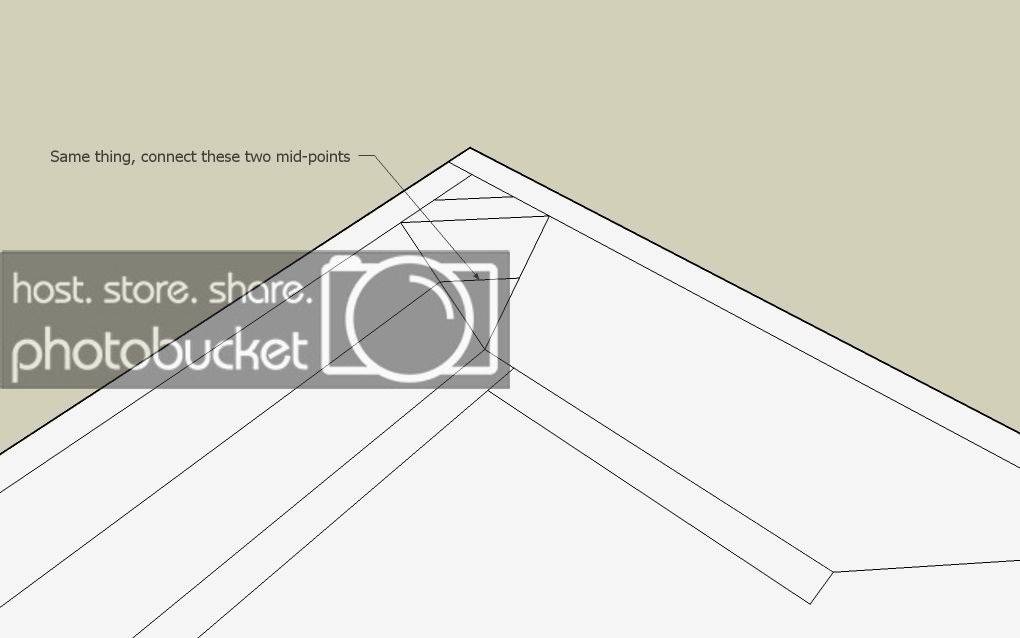

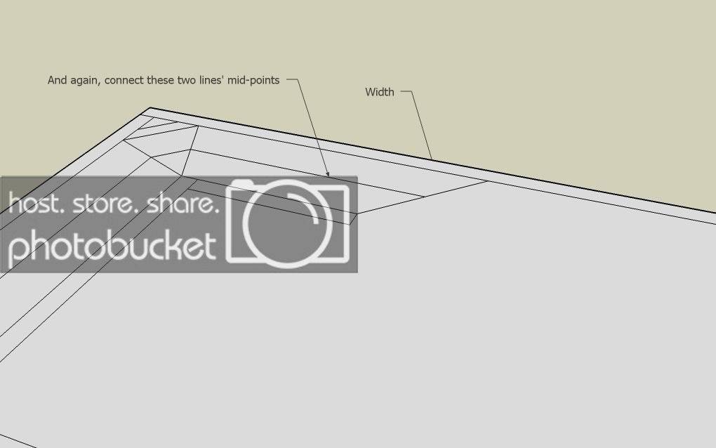

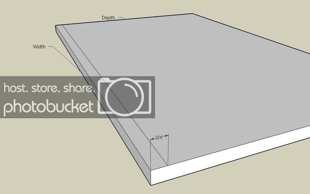

Now you will need to go to your Google Sketch-Up window, using a blank page, to begin drawing up your enclosure
The upcoming posts will be a step-by-step guide on what to do to draw up your enclosure and how to do calculations for tuning...enjoy //content.invisioncic.com/y282845/emoticons/smile.gif.1ebc41e1811405b213edfc4622c41e27.gif

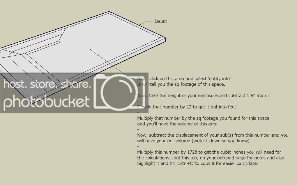

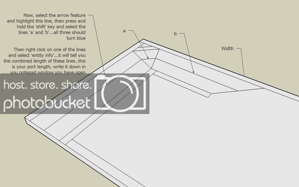

Now that you have the port's length written down along with the cubic inches of net airspace (that you should copy so you can easily paste it later, it comes in very handy rather than typing it...because it should be a moderately large number) you will just simply need to multiply your ports width x height to get your port area.
With all three pieces of info mentioned above you can start your calc's for the final tuning of your enclosure.
Start by:
-Square-root of the the port area
-Multiply this by .823
-Add the length of the port
-Multiply this by the cubic inches of net airspace (which you can just hit ctrl + V to paste it to your calculator for quicker calcs)
Now copy the number you have after these steps
Next step:
-184000000 x port area
-Devide this by the number you came up with in the last step (just hit ctrl+V to paste it for faster calcs)
-Square root this number
-Multiply this number by .159
And you should now have the tuning for your enclosure //content.invisioncic.com/y282845/emoticons/smile.gif.1ebc41e1811405b213edfc4622c41e27.gif
