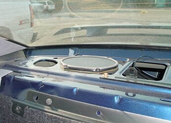

Thinking about doing an IB setup for my Mustang. My first question would be how hard is it to seal these holes in the rear deck? A cheap option would be multiple layers of cardboard sealed with duct tape with CLD over top, but not sure if that would be adequate. Maybe 1/8 ABS plastic, tape, and CLD? Does it need to be 100 percent completely sealed?
2nd I know IB is a more SQ oriented build that requires much less power, what kind of power and size/amount of drivers would be necessary to get a good 130ish DBs? I know thats a variable answer question but not sure if anyone else with IB setups could advise their general experience. Also, Subsonic filter: unneeded or necessary?

I mean technically I think it'll be like large sealed if you seal off the trunk. You want to get drivers designed for IB or free air where they don't need mechanical loading / air cushioning from the box. I haven't done IB specifically but done t-lines which can be super similar with the lack of chamber loading compared to ported. What I'd do is just try to maximize cone area, find woofers designed for IB that has Fs that'll allow you to play it where you want to.
Yeah I'd say you want it as sealed as possible because if it's not then the leaking bass from the trunk may cancel out the bass in the cabin. You might check out HPDE plastic to fill holes, you can buy sheets of it, or just use wood and a wood to metal adhesive, just cut the wood to fit. Seal the trunk good and the rest is up to the woofers. I'm not an expert in IB-supporting woofers but I know you want a woofer designed to handle rms power free air, which many audio woofers people use in car audio aren't specifically designed to do so. If I was going to do this as well as possible to be loud as possible, I'd aim for completely hard sealed trunk and the most cone area with the most rms rating and xmax, try to get the best combo of those.

I'd just use MDF or plywood to seal the holes. You want high QTS. Anything above .45-.5 will do. If this is for SQ, then you don't need a ton of xmax. FS doesn't need to be particularly low either since you cabin gain will kick in early in small coupe. Mechanical power handling will suffer.

People cringe when told modifying the structure of the parcel shelf or the permanence of the modification. Last one I was involved in was 2 15s and required the entire lip of the parcel shelf removed for the cone height. Then 3/4" material was used in place of that wimpy crap the factory uses for the rear deck. Foamed into the remaining metal structure with gussets on the bottom inside the trunk /w/ a 1/8' medite upholstered trim panel covering everything. It was permanent make no mistake.

Im not afraid to do any small modifications. Just dont want to be cutting a whole into the body of the trunk like Nicks 24 inch IB setup.
Rear stage delete is easy on the mustangs. I just need to know the best and most cost effective way to seal the front and back waves from eachother.

IB is tempting to me because of the ease of installation, atleast in terms of a baffle thats a couple of cuts then sealed to the trunk hole vs a box designed and then cut and glued together by hand myself (isolating sound waves is obv a whole other deal), as well as the efficiency and SQ that is talked about with these builds.
