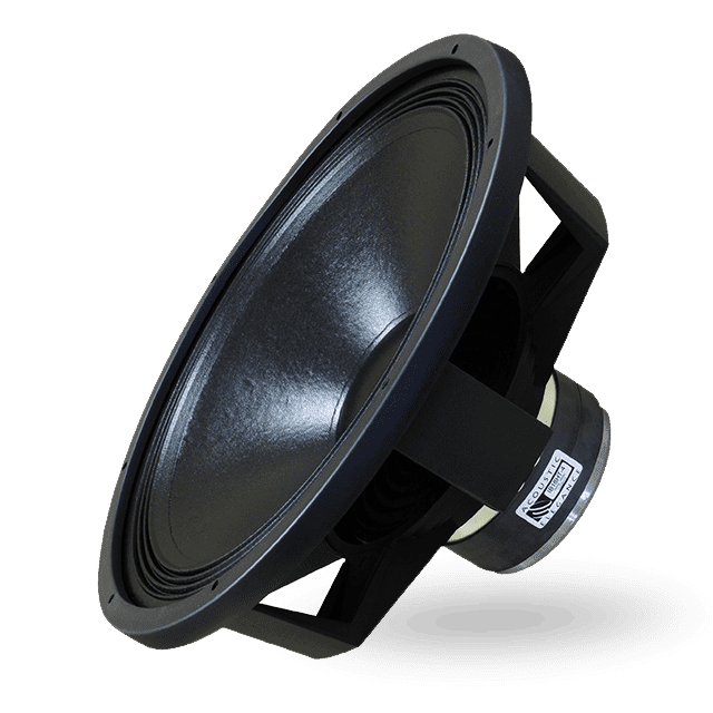

This was one of tbe first ones that popped up when I searched IB woofers. The price point kinda scared me away cause I was looking at getting at least two of them snd thats would be over $500 after taxes with two.
You think one 15 would be good if itd fit?
If I was doing a single ib sub, I'd lean towards an 18 tbh
