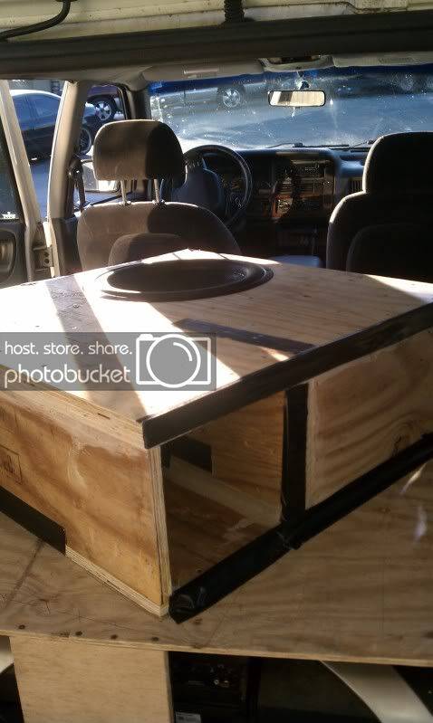

So i got a hand me down sub a couple days ago (my buddy upgraded to a sa12) and decided to build a box for all three lol. So now i have 2 batteries, one 140a gm alternator, one stock 90a alternator, big three, 1/0g wire, 3 pa gothic 12s wired at 2.6ohms, a hifonics bre2500.1d (yes, i know its junk), and a box that i designed and built at 7.6cft, tuned at 33htz with 13.8sqin of port area per foot. It has a triple baffle, and 2 center supports of 3" dowel rod. All in the rear trunk space of my 95 jeep xj. Just making this post for the hell of it. I think it turnout out pretty good. So, how does it look?
I think you should have used more screws to hold it together //content.invisioncic.com/y282845/emoticons/crazy.gif.c13912c32de98515d3142759a824dae7.gif
i would but i ran out hahahahaha. I dont have a brad gun so i just use a whole bunch of screws and glue lol

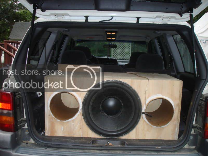

Mine did very poorly once you crowded the subs too close to the roof. Did better 3 12s just a couple inches above the seat backs than 4 12s with the extra height to add 3 cube airspace.
This one was my loudest (pre-wall)
This one was the best sounding (firing up) and only a few tenths difference between firing up and side firing ports from my testing. I used to build a new box every week or two when I was competing in non-wall class. The ones that didn't work I'd often blow up the subs and throw the box in the dumpster at a show.

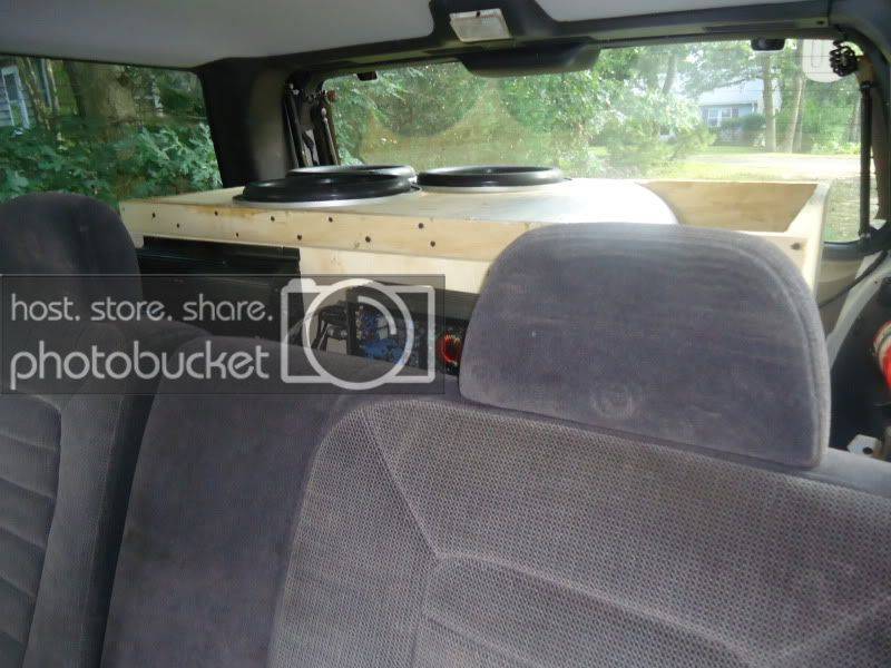

This one was rather sad.... regret selling the sub. Prototype Shocker/4hp

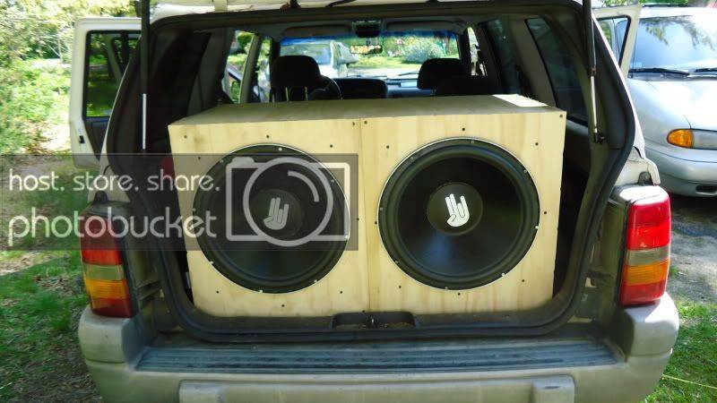

Ditto, this one, (port to the side) wasn't so great:
And another failure
And another failure

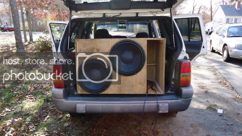

I did one with a pair of 18s subs firing one to each side and port firing up that worked surprisingly well. Can't find pics though.
To maximize the transfer function you want to keep the same shape as the cabin. The single 18 with the offset box/port definitely has the best coupling.
Keep the height low go wide as you can and stay 4" away from the hatch..
To maximize the transfer function you want to keep the same shape as the cabin. The single 18 with the offset box/port definitely has the best coupling. Keep the height low go wide as you can and stay 4" away from the hatch..
That was a single 15 and I tested every possible position of the box and port. Built that one the day before a show, added some length to the port with some PVC and duct tape to lower tuning a little won a couple trophies then threw it away. I could heat the house half a winter with all the wood I've thrown away in old boxes.
I did a handful of other single sub with port to the side for various size woofers and all worked quite well for daily then gained a little for the meter angling the port to the passenger side corner.
