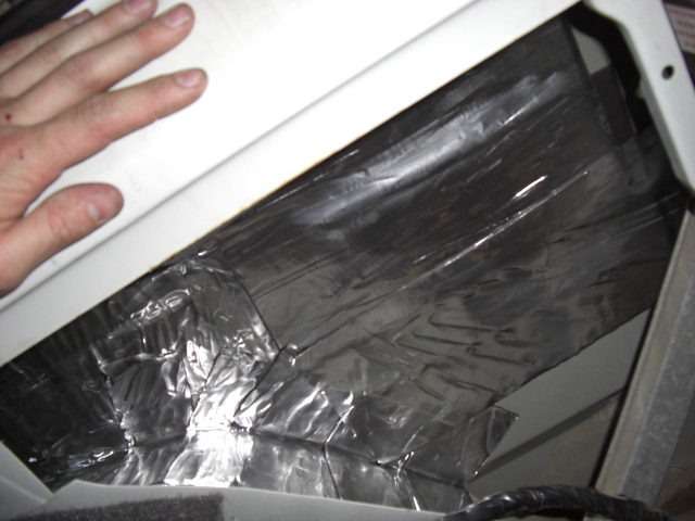

My 152.1 won't come back - maybe it was a fluke perfect hit on the mic or something to that effect.
I am hitting 152.0 over and over... no effect from deadening the internal areas in the rear quarter panels. I have not sealed up the holes yet - just dampening the outer skin of the vehicle from the inside. I did both sides and 152.0 it still is.
I'll post pics of the dampening I did in these areas tomorrow.

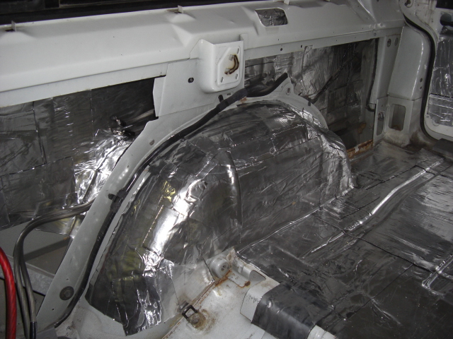

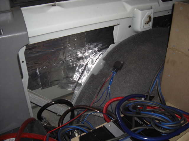

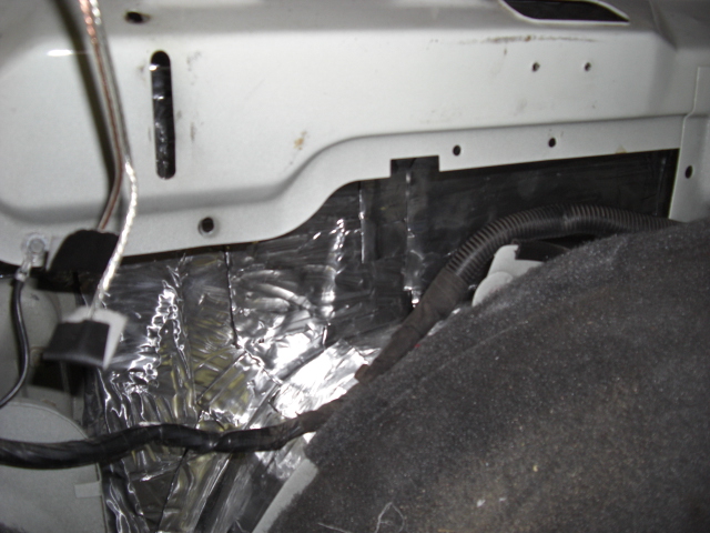

* Driver Side Rear Quarter Panel Pic 1
* Driver Side Rear Quarter Panel Pic 2

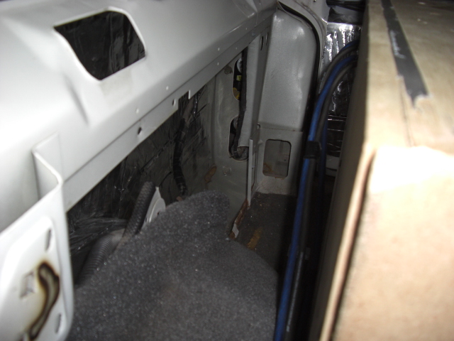

* Passenger Side Rear Quarter Panel Pic 1
* Passenger Side Rear Quarter Panel Pic 2

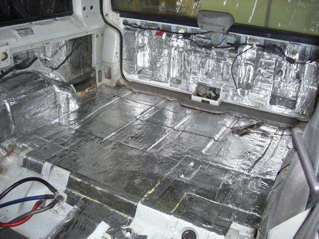

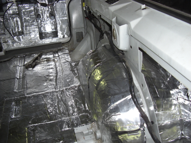

This is what I did to the floor in the back :

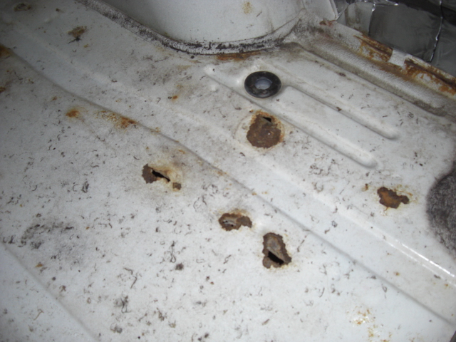

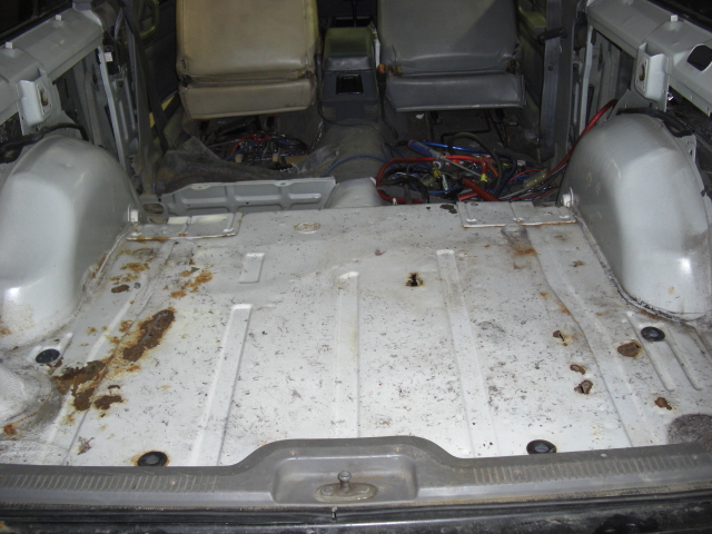

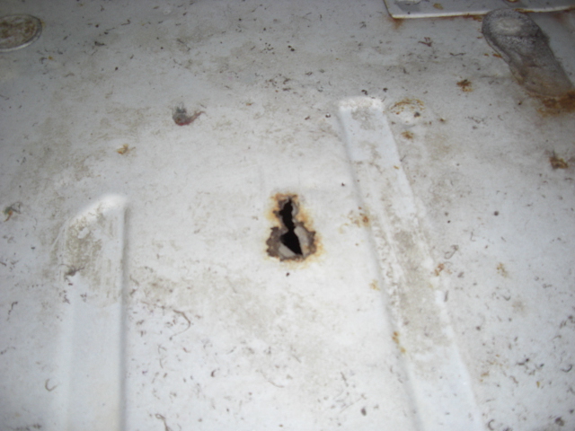

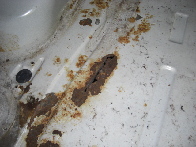

This is what I found when I pulled up the rear carpet (WOW):
My Jeep came right off of a farm when I got it... when I burp it a bunch of "dirt" always falls off. Well, I inspected some of this dirt in my shop and it is actually rusted metal flakes mixed with old mud *laughs*
So... lets hope the Jeep lasts long enough to reach my SPL goals //content.invisioncic.com/y282845/emoticons/smile.gif.1ebc41e1811405b213edfc4622c41e27.gif :)
