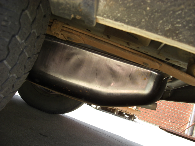

* Nice shiny new gas tank!

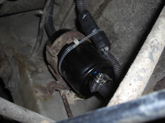

* New fuel filter as well... the old one was almost rusted apart *laughs*
Now... I can get back to work on my testing since I am not leaking gas all over the place!

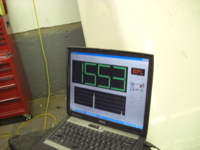

155.0 dB -- Base-Line Score this morning

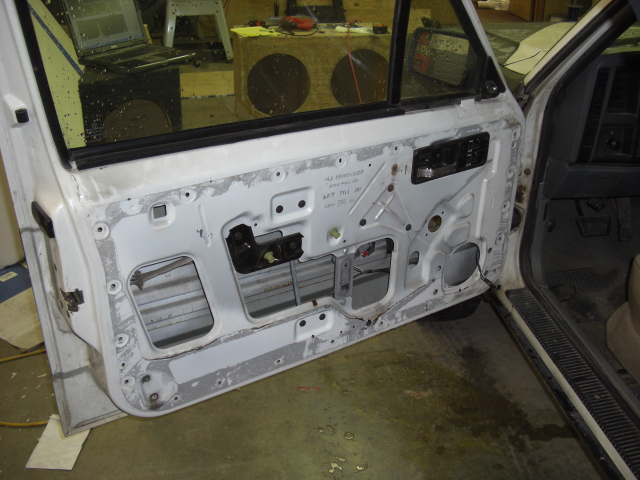

154.9 dB -- Base-Line with door panel and vapor guard off

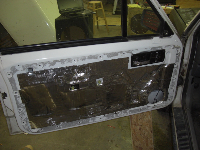

Since the holes in my door are TINY I decided that it would be nearly impossible to do meaningful dampening to the outside skin... so I am going to use both layers INSIDE.
* Small access holes - and there is alot of crap blocking access to the front 1/2 of the door and top half of the door.
* I used two full sheets of dampener and one small piece from another sheet.
*DRUM ROLL*

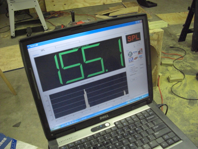

HOLY CRAP. I gained 0.4 dB compared to the door skin off score and 0.3 dB from the base-line score with the door skin on from this morning.
Even going by the high 155.1 dB from the other day that is still 0.1 dB PER SHEET of Damplifier Pro!
Apparently my Jeep likes to have these holes sealed up.
With the Jeep liking the holes sealed I also think it will be best to use both layers to strengthen the areas covering the holes on the inside rather than splitting it up.
