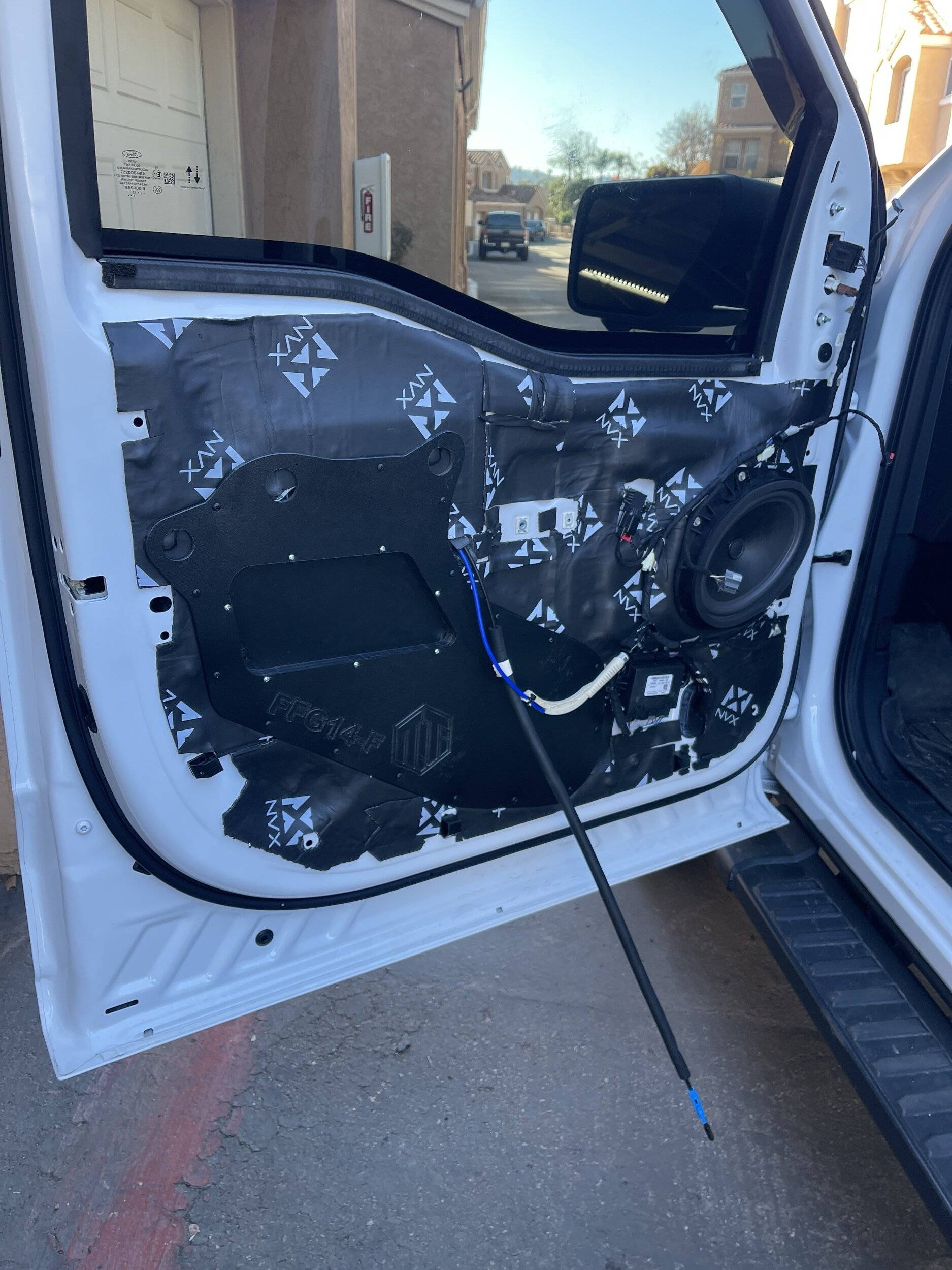

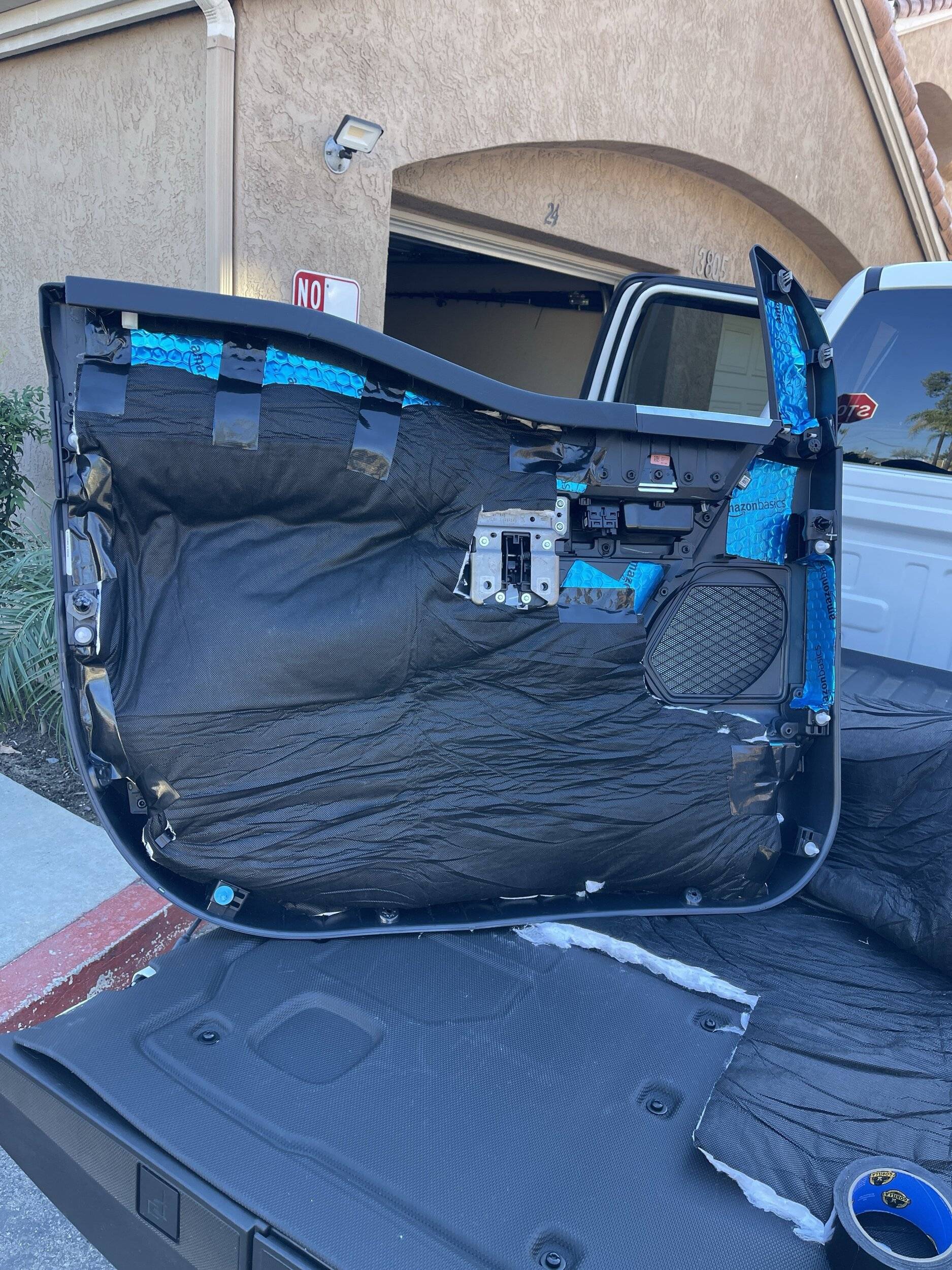

getting ready to finish the doors on the new f150...
Doing sm600 thinsulate on the door cards, already butyl roped the gaps & seems in the cards, along with some cld on the large areas to add some weight.
Cant decide if I want to run the NVX tri layer combo stuff which is butyl, foil, close cell foam, on the inner panel...
or just run cld. & call it done..
doing everything I can as the one time I heard one of these trucks with a system in it, the door panels to the door where an absolute rattly mess as he had zero deadener...

Not sure the tri layer would benefit much?
If you are putting the thinsulate
Unless there are surfaces you think might rattle together?
The ccf could help cussion them but won't really help with any sound suppression, thinsulate is pretty good at that
Yeah im torn....
You see all these videos showing the tri-layer stuff on the inner skin, like second skin, sound shield, etc, like its a huge bonus....
Even my installer said, he wasnt a fan & prefers just foil / butyl CLD...
But yes, thats my main concern the door card rattling on the inner panel.
But even so, not looking forward to covering every inch of inner door skin to get full coverage, theres tons of contours, holes, wires, obstacles, modules, etc...
Not looking forward to it.

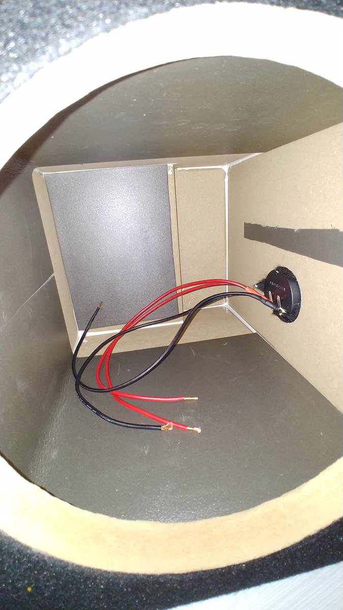

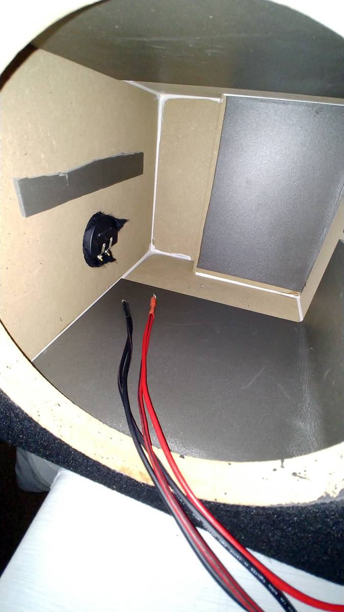

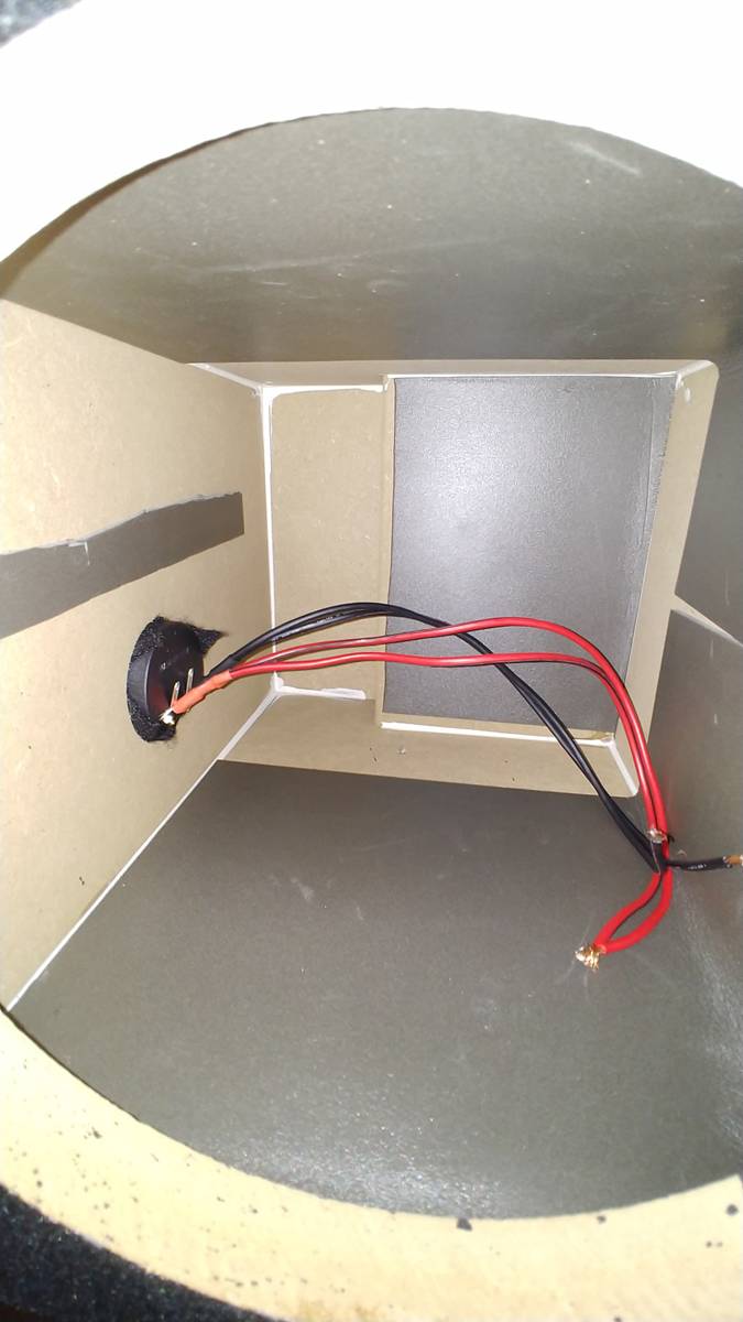

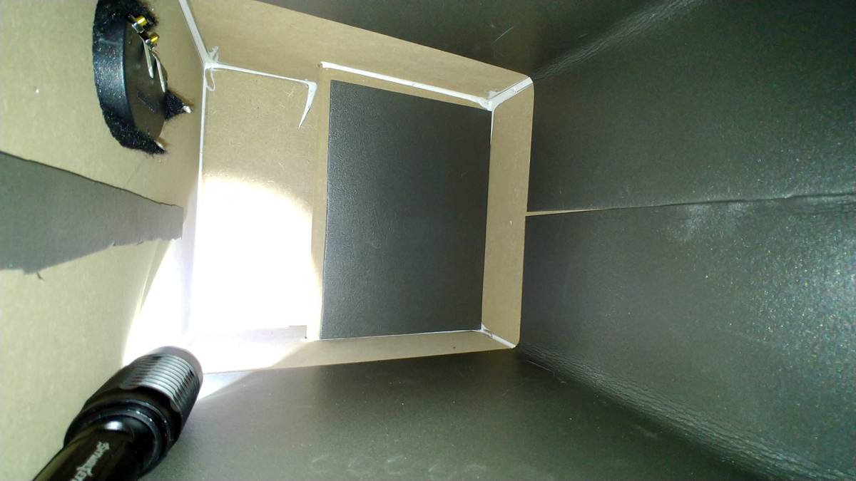

When I worked at DOW Stereo, in San Diego, I had a pretty large wood shop. I used to mess around and build/modify all kinds of sub boxes. They would also allow me to take subs back and try to blow them up. Anyhow, I took a prefab box and lined it with Dynamax. It made the sub hit harder and sound smoother. I did the same with Bazooka tubes, and the same difference happened. You can also use sound deadener on plastic ports. It gets rid of the hollow port sound.
My installer lined the inside back wall of my pre-fabbed ground shaker box for the JL 12tw3 with some of my left-over amazon basic cld, on my 24 tacoma build...
must be normal practice for those that know...

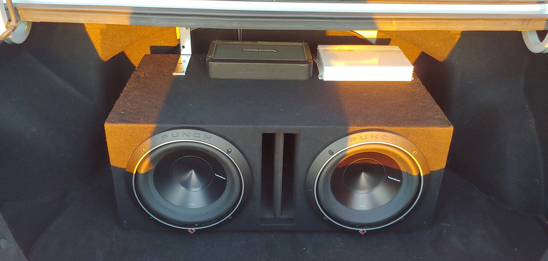

That is so weird that you mentioned this. I did this to my enclosure that has my RF Punch P3 10's in it. I used NOICO 150mil CCD.
I did this back in 1997. I started working at Best Buy in 2001. I introduced this to the district manager, who then posted on the Best Buy Installer site. It took off from there. Later, I saw other companies doing the same.
I put it like this... If it vibrates, it's probably producing unwanted sound and/or interfering with the sound I want. To prevent this unwanted sound, I put sound deadening material on it.

installed the thinsulate on all 4 door cards...
Did the tri-layer on both front door inner panels...
Installed the front block off plates.
I did majority cover of foil cld nvx 91mil on the outer panels a different day on all 4 doors.
Tomorrow I need to deaden the inner door panels on the rear doors & install the block off plates...
Not liking the NVX tri-layer but im sure it will do what it needs to do...
Just doesnt seem as dense as just foil / butyl cld.
Im thinking lay some foil CLD on the ABS block off plates?
