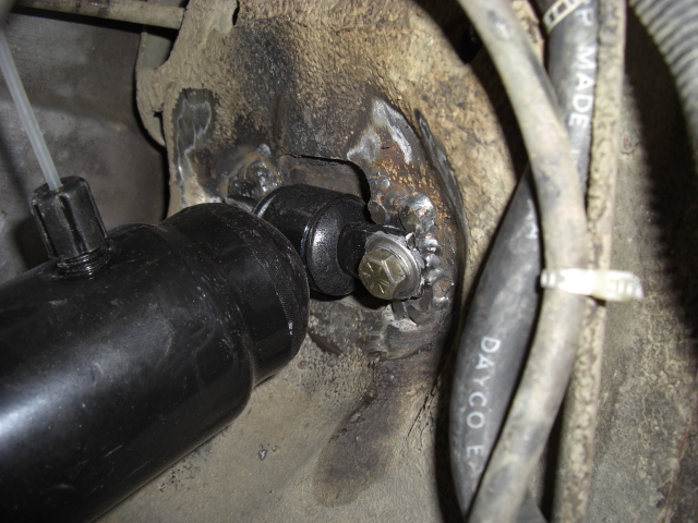

Got it //content.invisioncic.com/y282845/emoticons/smile.gif.1ebc41e1811405b213edfc4622c41e27.gif We torched the bolts out and got some weld-in pieces with threads from a local specialty fastener store that worked great. All new Grade-8 and/or Stainless steel fasteners used as well.

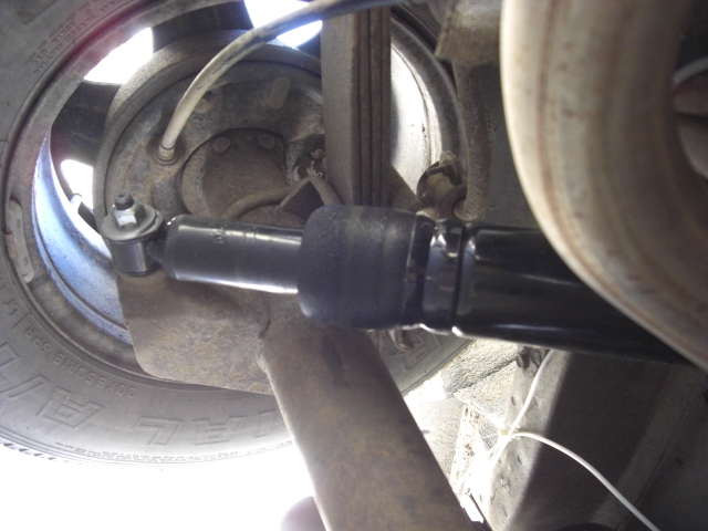

* Normal ride height restored!
* New threaded pieces welded in with shock bolted to them.
* Bottom of air shock

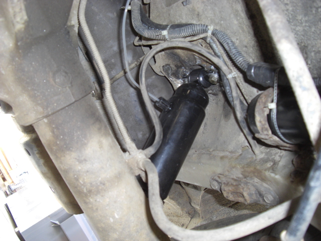

* Another view

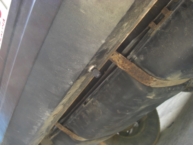

* Valve on rear bumper.
