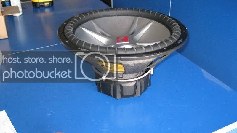

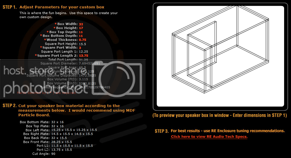

Today I'm going to start on the enclosure for a 15" CVR. The box is 3.1 ft^3 and tuned to 33Hz. It's going in the back of a E39 bimmer. It will be powered by a MRP-M500 amp @ 500W RMS. I'll keep you guys posted on pics!
Here is the design of it:

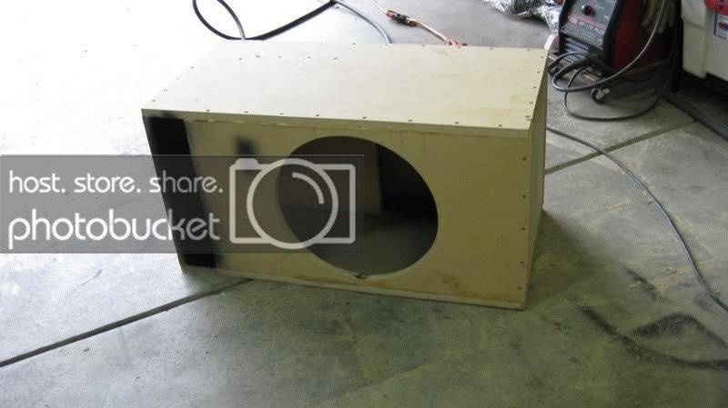

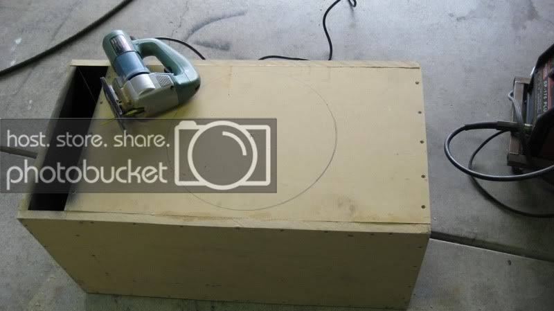

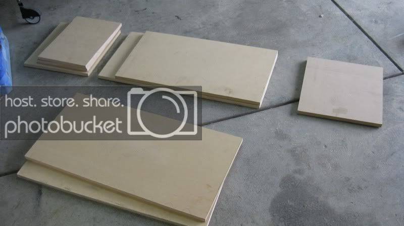

Well the box is pretty much finished. Here's some pics. BTW, this was my first box build and, well, it's not perfect //content.invisioncic.com/y282845/emoticons/biggrin.gif.d71a5d36fcbab170f2364c9f2e3946cb.gif. I learned a lot though, the next one will be much better!

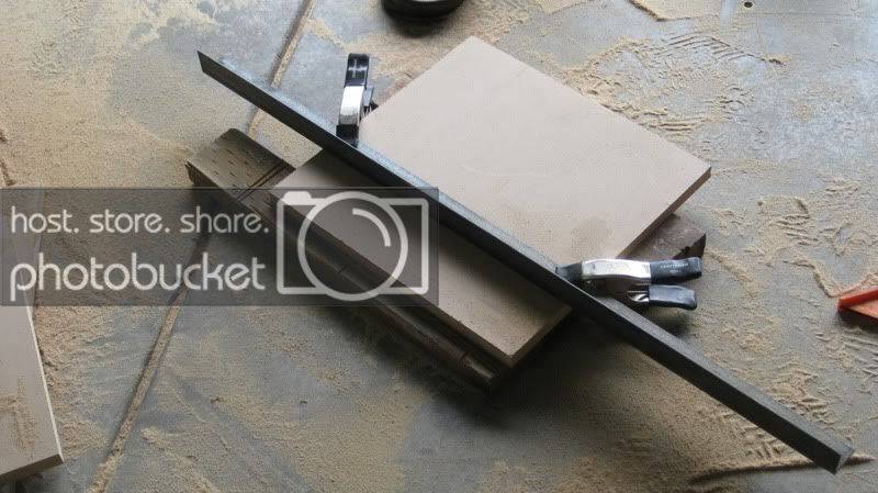

Homemade table-saw
Everything cut

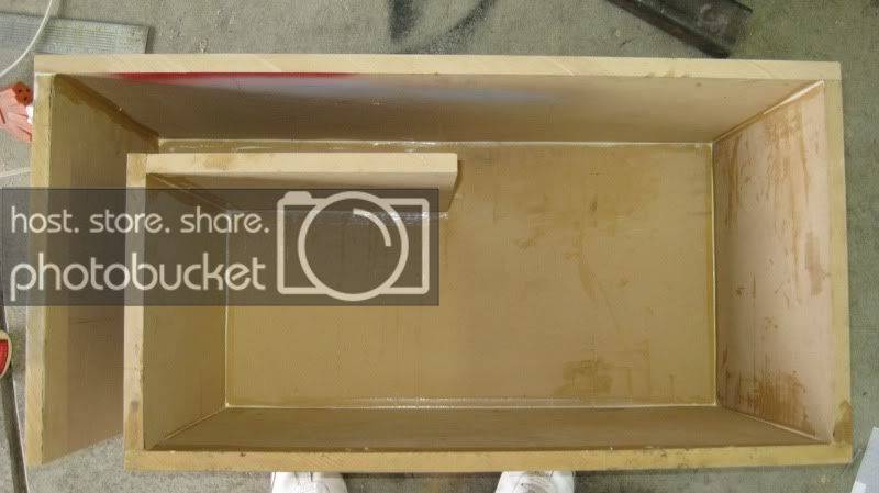

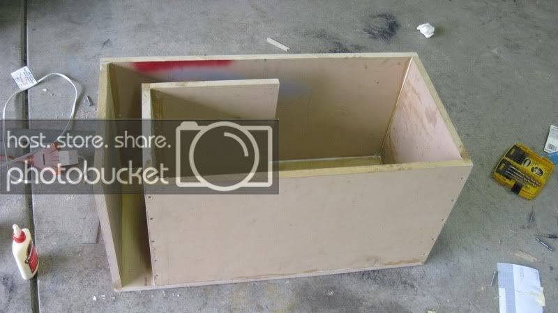

Gettin' there...

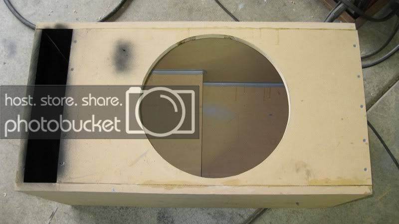

Ready for that 13-7/8" hole to be cut
All done (except for carpet and speaker terminals)

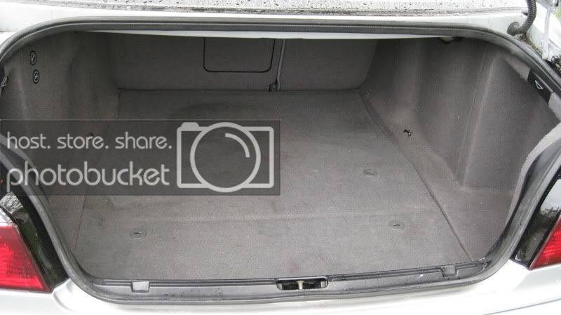

Here's what it's going in
Lot's of trunk space!

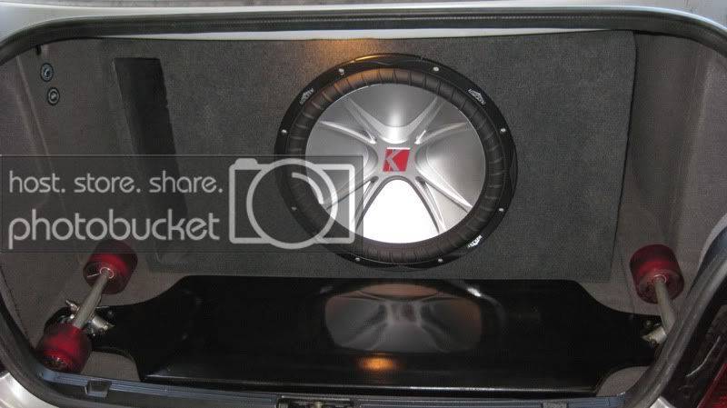

Little update on the build. Box is ready to go in. Power/Ground wire is ran. Thing is a b.i.t.c.h to get it though; barely fits through the trunk opening.

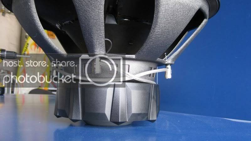

D4 wired to 2 ohms

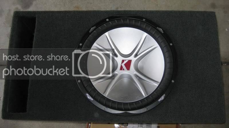

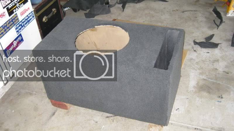

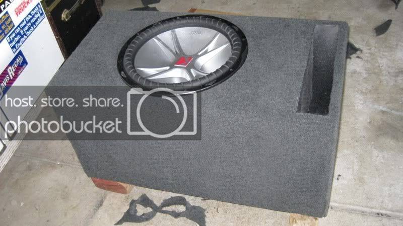

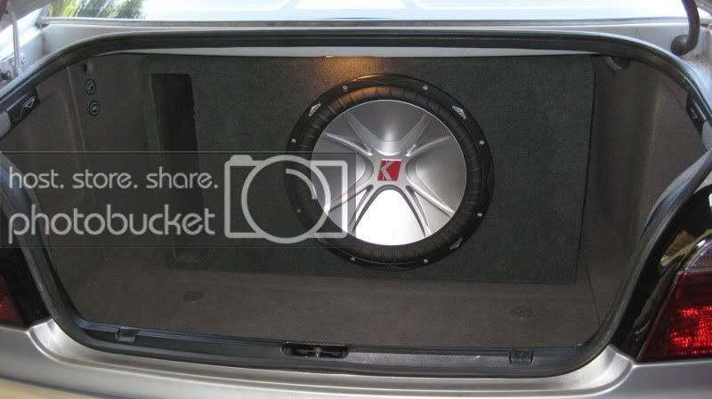

Carpteted

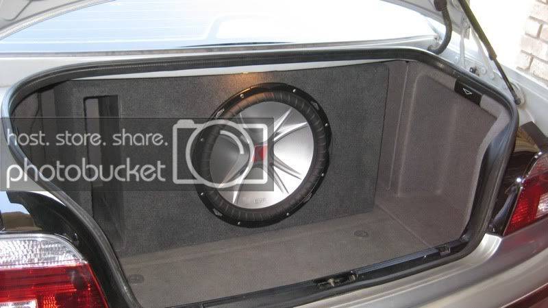

Well, I'm pretty much finished with the install. All I have left to do is tune the amp, securely fasten down the box, and try and de-rattle it. This thing is LOUD. Much louder than my previous system (12" L7 in a sealed box).
This is as close as I could get to matching the carpet color.
