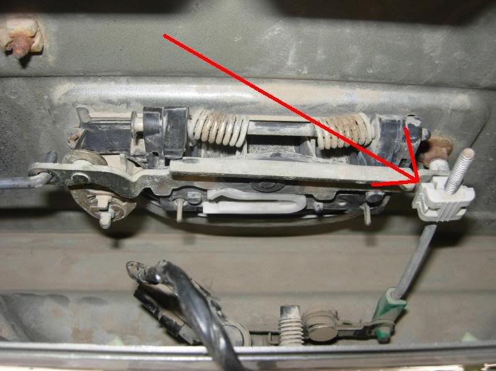

well, whats actually rattling is I think its a real heavy spring. Its in the hatch mechanism, but that basically what it is, is a big spring.
like this? (disregard the arrow)
if it's the spring, you might be able to slide a sliver of rubber, deadener, or pliable foam in between the pin and spring,.. if it's something other than that, i would watch the assembly while
it rattles and tie/bind whatever moves up with rubber bands, grommets, or o-rings as long as it doesnt hinder operation.
might as well lube it up while you're in there if it looks like ^that, lol.
I beleive thats exactly what it is! That pictures not from a cherokee is it?
indeedily-eedily it is, neighbor.
excellent, thank you I appreciate it. I think ill try getting a rubber sleeve under it, and Also, I have not deadened the sides of the jeep. I might spray some foam up in there since my box is in, and its going to be difficult to get to. But thank you very much sir
Make sure you have researched spray foam before using it. It can attract moisture, which will cause rust. Though on a 98 cherokee im not sure how worried about rust you will be!
