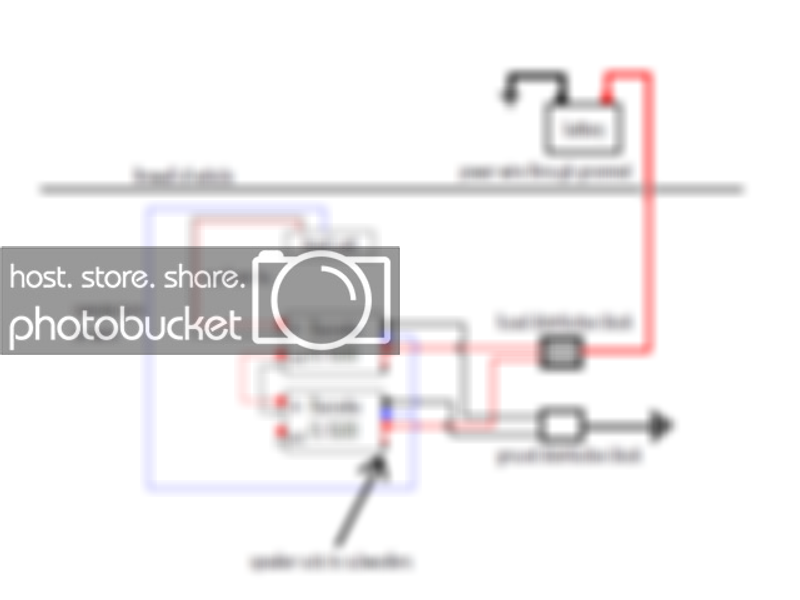

If you look on your amp, there is a "remote" terminal next to the power and ground. That connects to your head unit's remote or ignition and will turn on the amp when you have the key to the "on" position. So no, the amp will not drain the battery because the amp will not be on.
Your wiring should look something like this.
