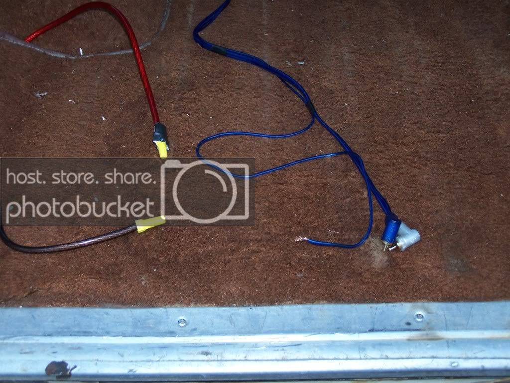

i looked and tested some more and concluced the same as you guys its definitley a fuse or i just blew the whole ******* amp :/ ill be posting some pics in a few min as there is two of the blue cables that im unsure of where they go.

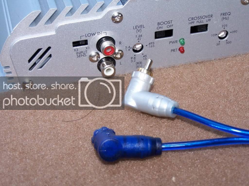

which cable goes in which slot i know for sure they both go in there i just cant remember for the life of me which one goes in which slot. I dont even know what those ones do tbh :/ so if you could tell me what they do while your answering which slot they go in thatd be really helpful lol.

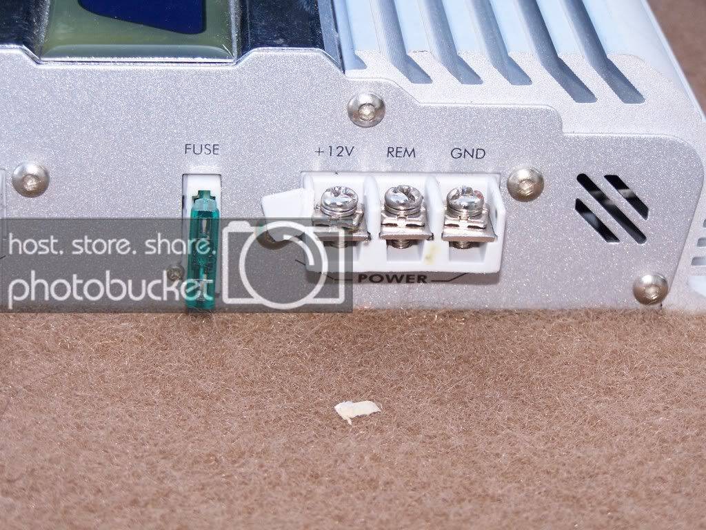

that blue thing is the fuse as you can see in pic but how do i pull it and where do i buy a new one?
refer to above picture for this question
black wire=ground
red wire=power
blue wire=deck
going from right to left is this order correct to hook up these cables
black(ground wire),blue(deck wire),red (8 gauge power wire)
You just pull the fuse out with your hang look at it to see if the metal inside is burnt or separated. You can get them anywhere (autopart store, hardware store, Wal-mart). Also check your fuse on the power wire and chech the fuses in your fuse box in your car to see if your radio fuse is blown (should be a 10amp fuse). For the RCAs it depends on which one is on red/white on your deck and just match that up with the ones on the amp.
Yes those wire that go in the red and white spots are the RCAs. The 12v wire is the remote wire that goes from the radio to the amp. This wire tells the amp whento turn on and off. Asfar as the RCAs go just match the positive on the radio one to the positive on the amp and Same thing with negative.
thanks guys i have a few new conundrums as i look further into this. My deck's removable face wont come on at all. However once i take off the removable face theres a tiny red light that flashes every 15 seconds which is still flashing. So i blew up the face but not the deck? as there is obviously still an intact power source to keep making that tiny light flash. Additionally the fuse in my amp wont come out is there a trick to it?
Pliers
pull while wiggling/rocking it back and forth.
