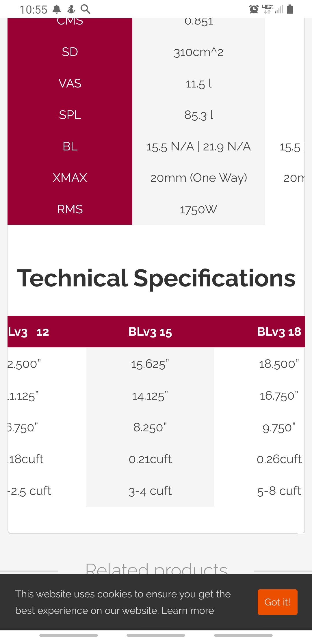

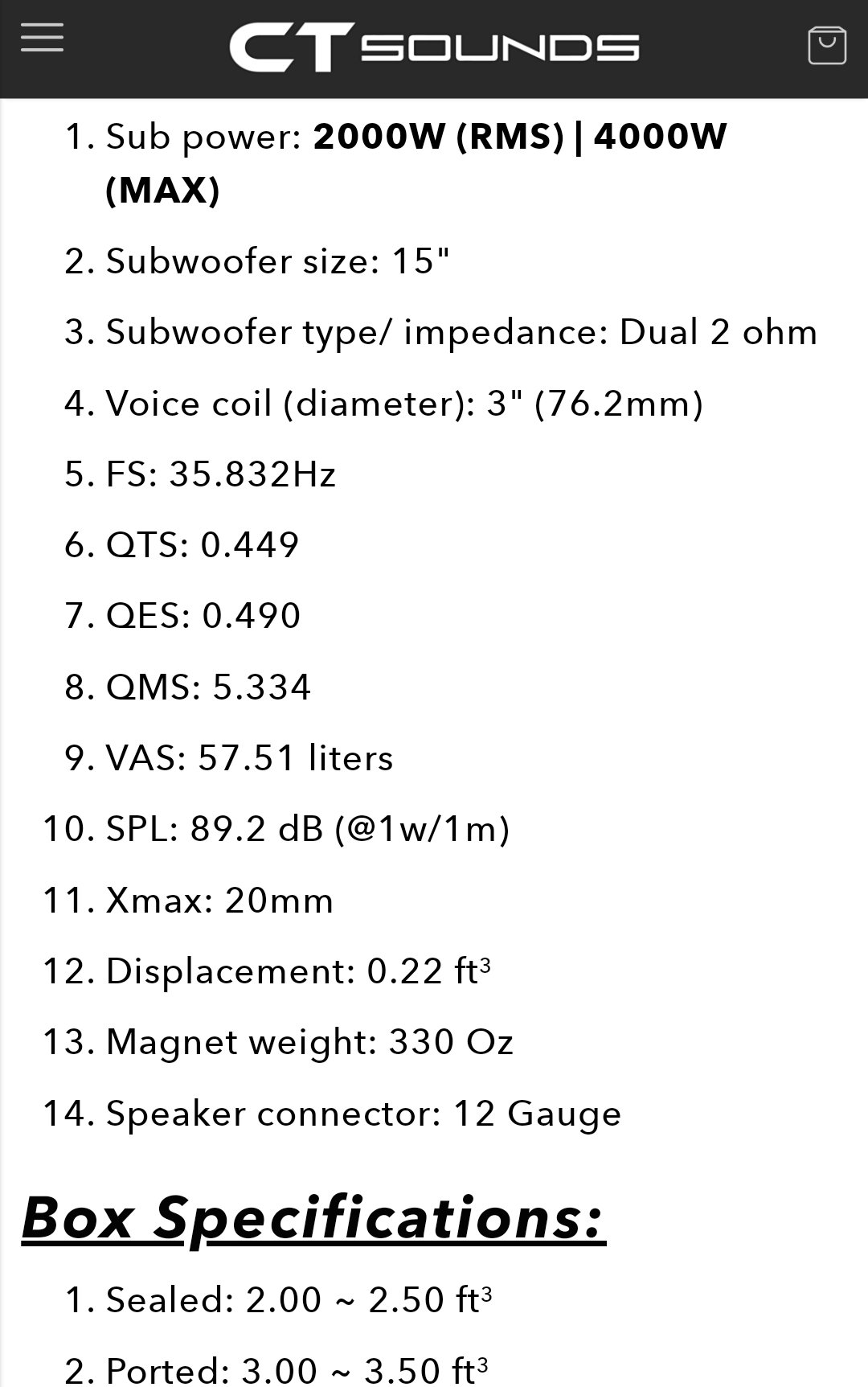

Are these subs any good? Specifically the CT Meso subs. I've never heard them in person. @Buck have you everooked at a CT Meso 15? The specs say only 3.5 cubes for a 15". Is that a realistic number?
