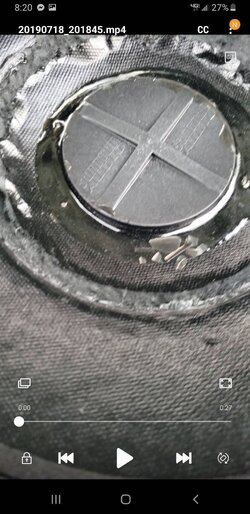

I found out what was wrong with the other sub. I didn't hear on when testing or this morning. I opened my truck with music playing and it sounded like rocks in the dust cap. I knew it was something under that dust cap. So i took off. Well there was something (not rocks lol). Its dried glue it came off the top of the Coil. I thought i was taking a picture, but it was a video. Here it is...

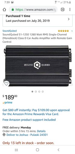

Just ordered another S1-1250.

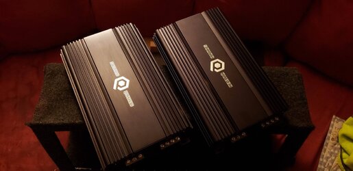

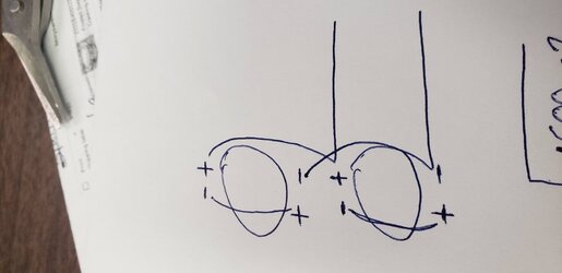

2nd amp came today. I tried hooking them up strapped but it was doing something weird. I set the gain using a dmm on the master amp. I would turn the volume up on the hu and when I would use the bass knob the bass was stuttering/cutting out every other second. Anyone ever heard of this?
are you strapping the amps or gain matching?
Thanks to @shredder2 i found out i made a big mistake. This is what happens when you dont take your time or fully understand something. I have read and watched videos on strapping amps. I had my subs wired to 1ohm ea and i figured that both amps are 1ohm stable i would be good. Well thats not the case. Shredder said each amp was seeing .25ohm. Luckily there is only about 5-7min of play time. When i get off work going to rewire the subs and hopefully no damage was done to them. Live and learn and double and triple check....

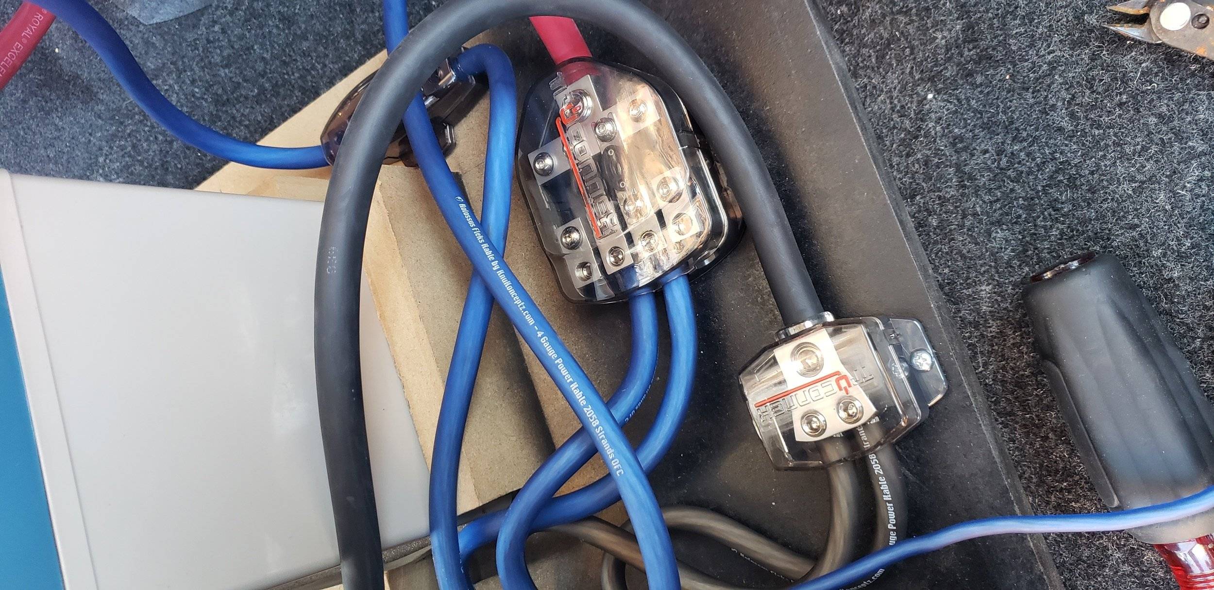

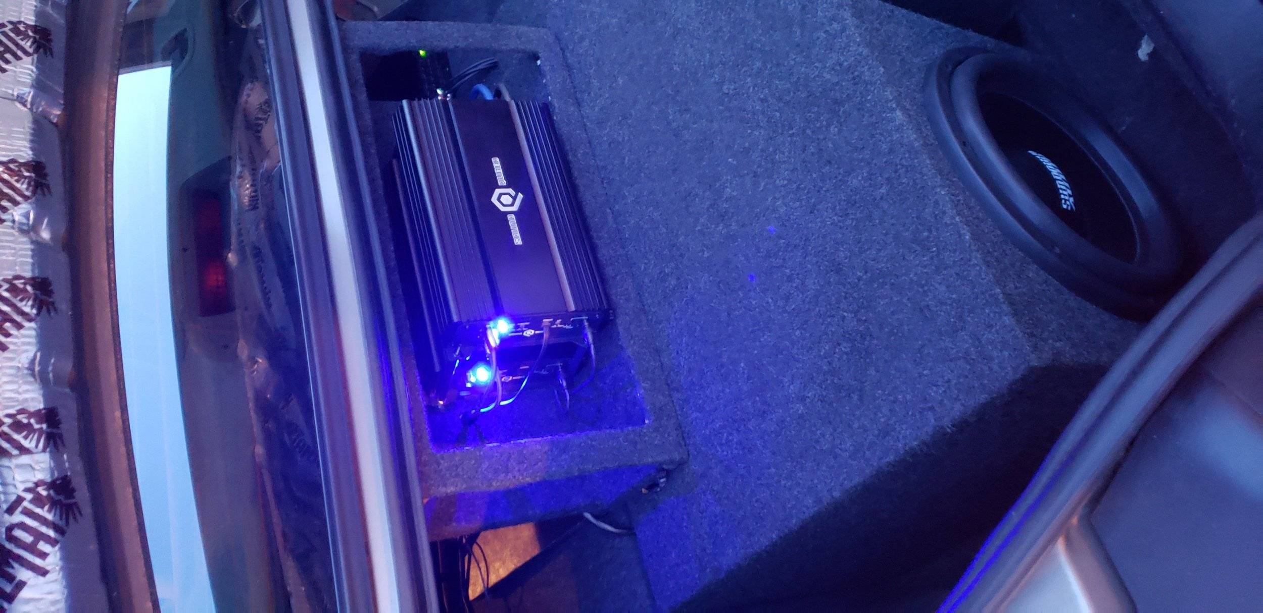

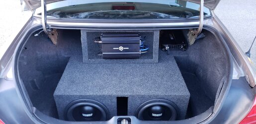

Fixed my wiring on my Subs lol. Everything is good to go now. Still not sure if im going to leave strapped or gained matched. Going to Droppin Hz Next week to get my gains set, so ill be good for Sundown Audio 2019. I really didnt want to rebuild my amp rack right now so i modified it to fit both Soundqubed S1-1250's. Still need to mount my 4-channel amp. I picked up a 4-way Fused Block today - 1/0 in and 4-4ga out. Do you think i will be fine running all 3 amps on that? or to much current drawy for 1/0?
Here is pics of my modified rack
Put a fuse block in today and cleaned everything up. Mirror feel off today. Dont know if I can go without a rearview mirror

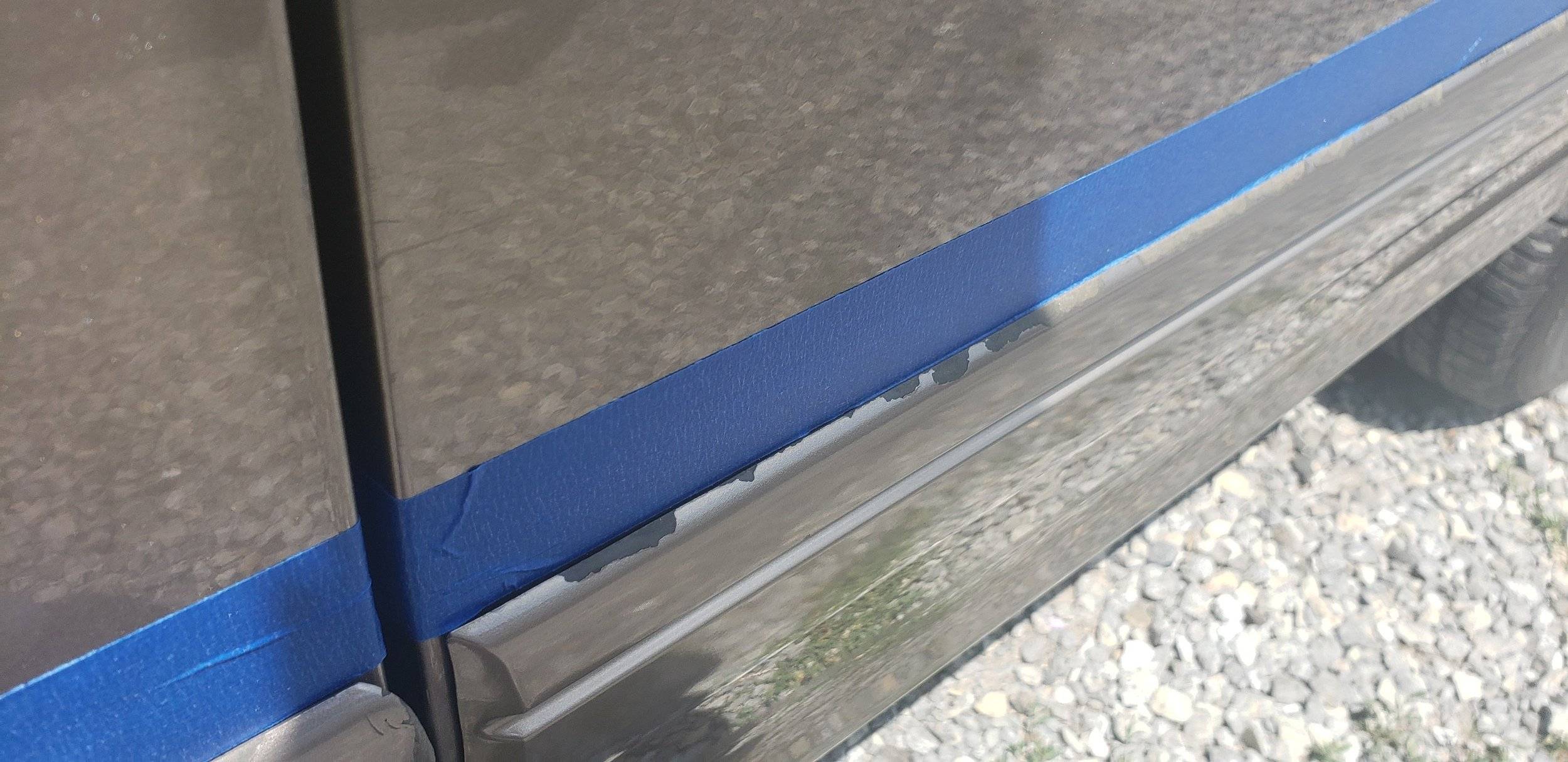

Slowing getting my car together. Getting everything fused and secured down and more sound deadener. Painted the chipped trim on the side this weekend.
