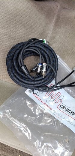

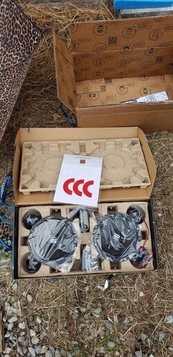

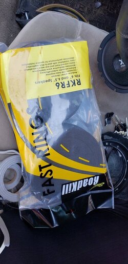

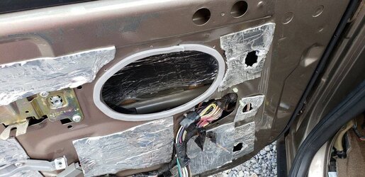

Welp new Morel installed from crutchfield. New 4 channel rca, fast rings.  Ran 4 new runs of speaker wire for the mids and tweets. These speakers are super nice.  The mid bass is amazing. Still have to run down the hiss sound from the tweeters. I changed amps so it's not the amp. Made a new ground. I have both my amps grounded to a agm in the trunk so I may try grounding the 4 channel separate. Hopefully I find the source of the hiss.  It gets louder as you turn the gain up.

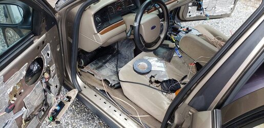

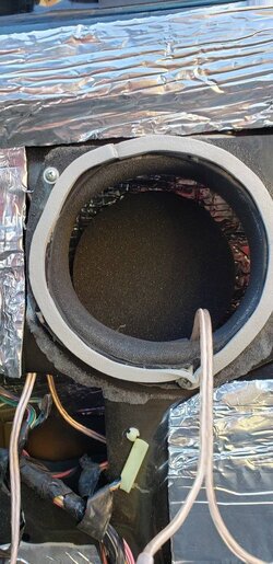

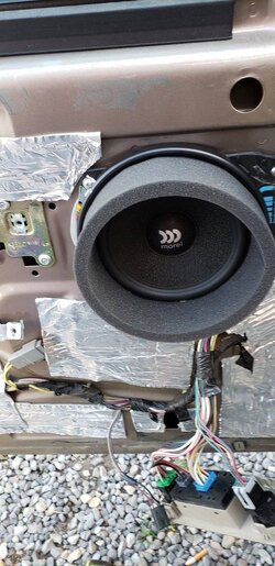

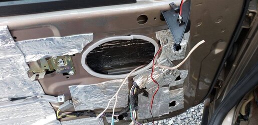

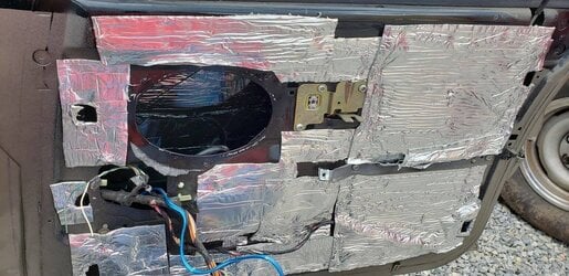

Some pictures from today
So everything is finally coming together. Have my crossovers set good. Sub @80hz 24db, MB @80hz 24db - 2500 12db, TW @2500 12db. Used a tape measure to set the TA, but still have a lot of work today. Haven't messed with the EQ yet (set to flat). My next step is to get my front stage right. Thinking about making a sail panel pod for Morel CCWR254 2.5" Midrange and place my tweeter there also. You think the CCWR254 would be good for a Midrange? Im really liking how the front stage is coming together. I was wanting SPL, but now i may want SQ lol. I also started building a .flac Library on a 1tb External HD for the car as i can get any .flac file i want for free.

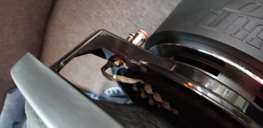

Got the subs today. One I can tell has a smudge on the dust cap and a loose wire. The other one I cant if anything is wrong so I going to hook it up. Hopefully both are good or at least 1
