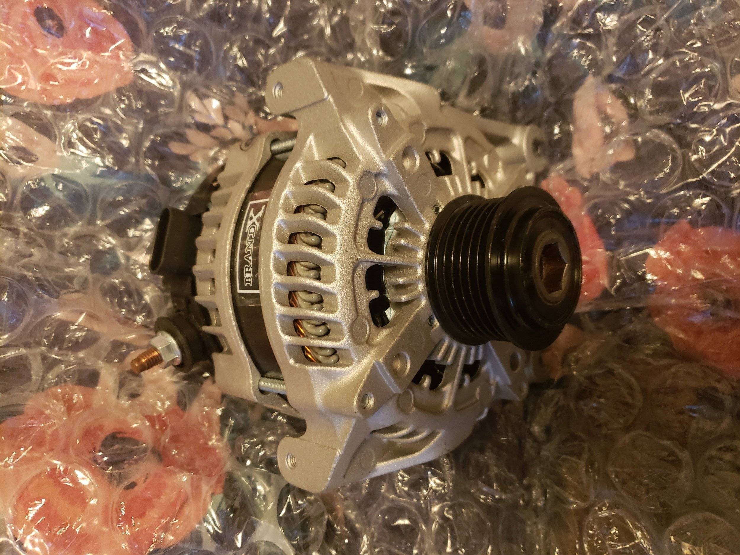

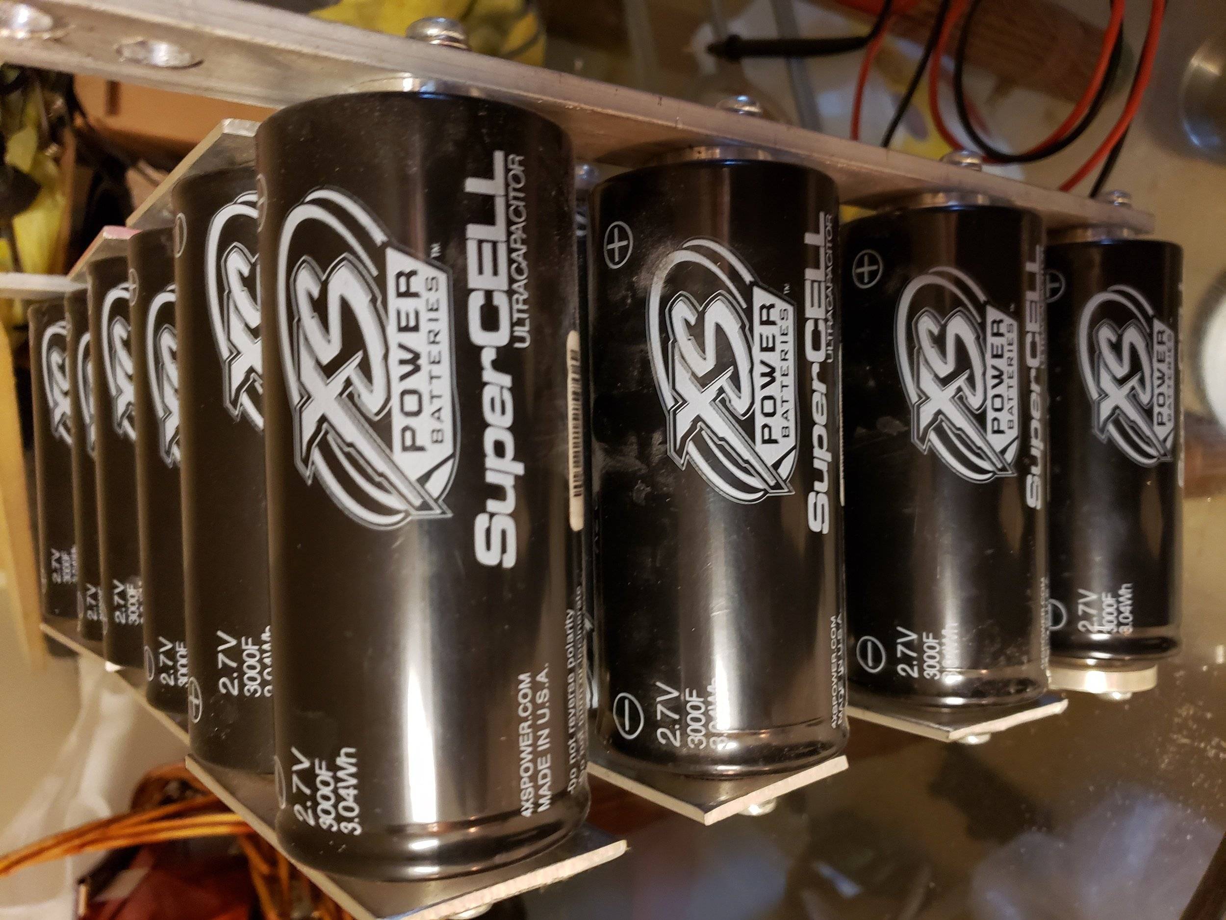

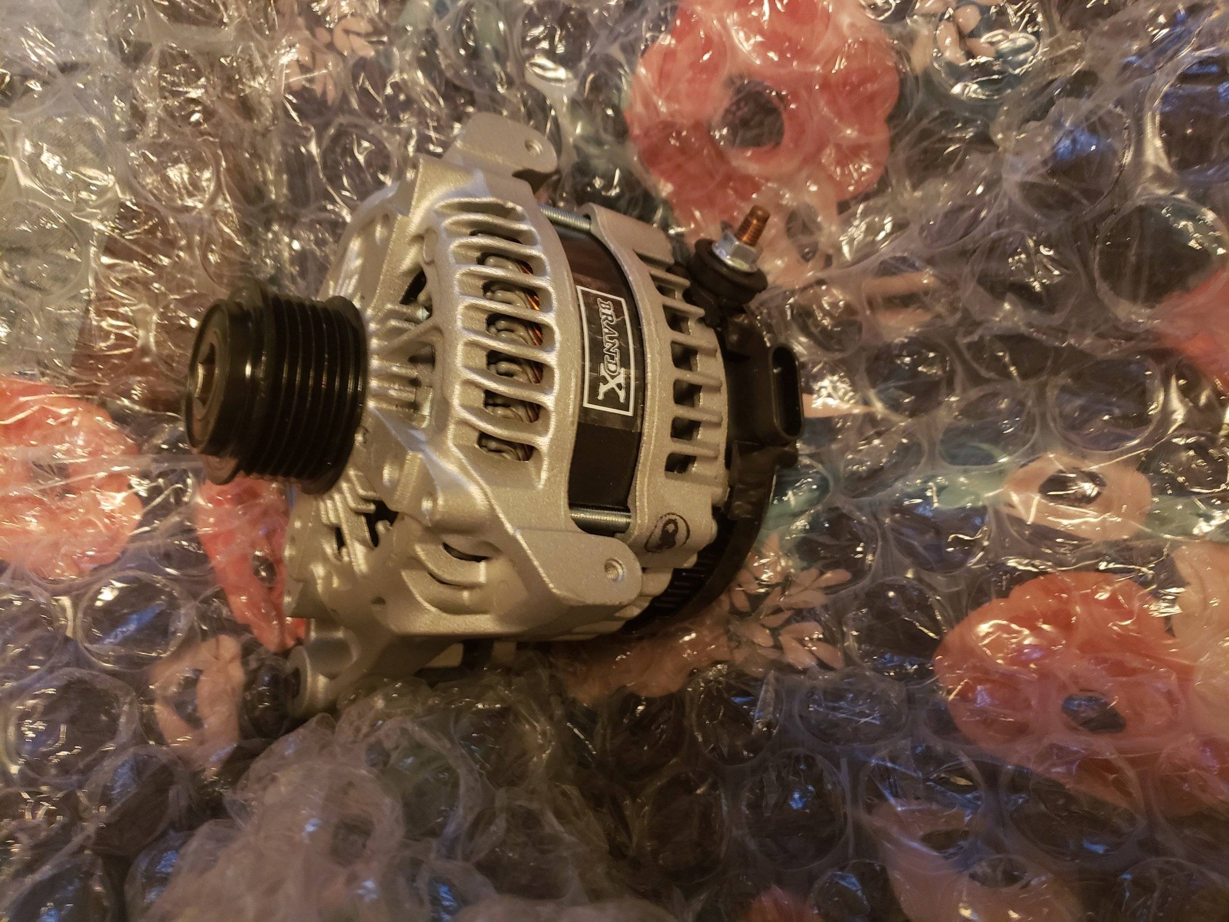

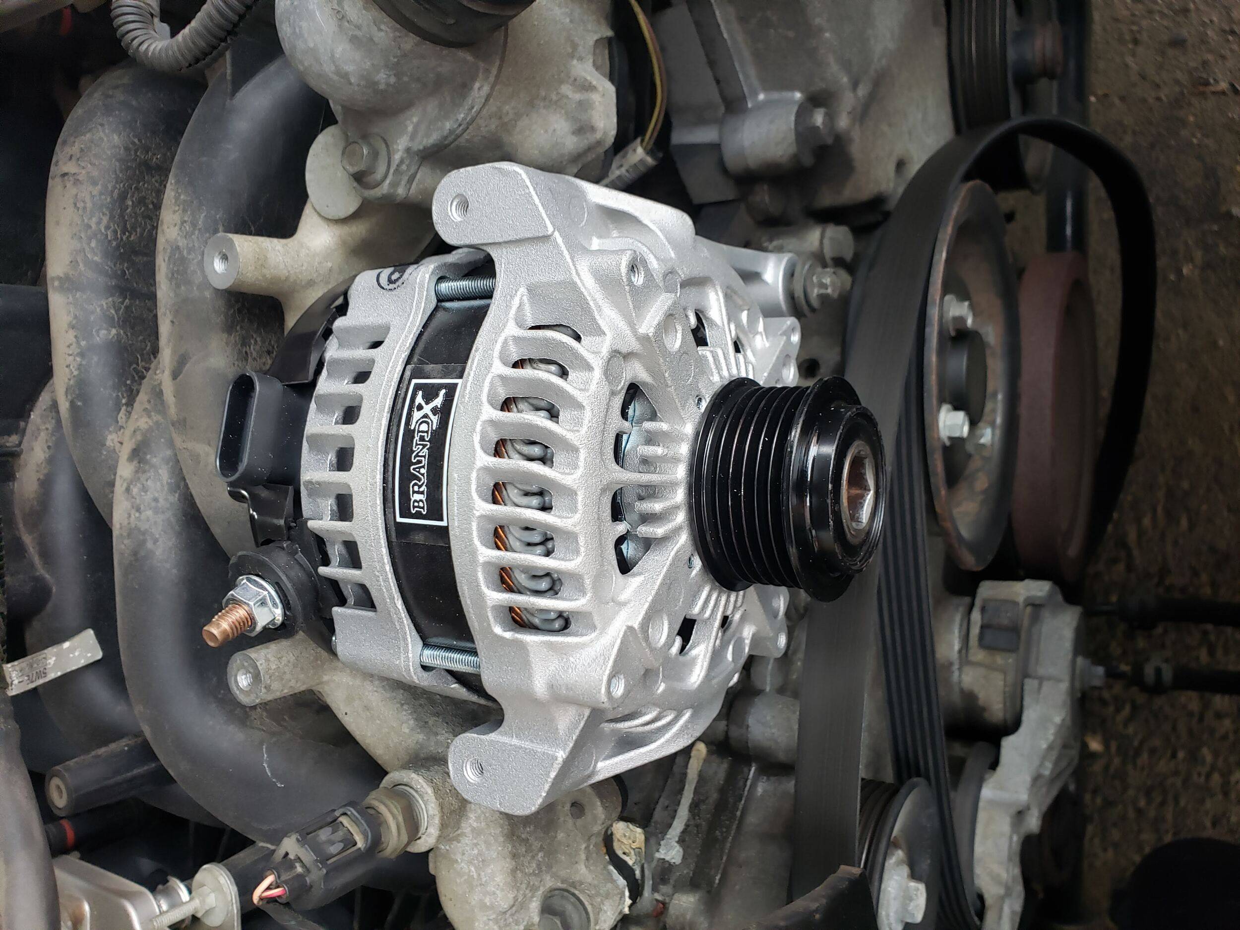

All the cells have been balanced and ready to go! Cant wait for an alternator

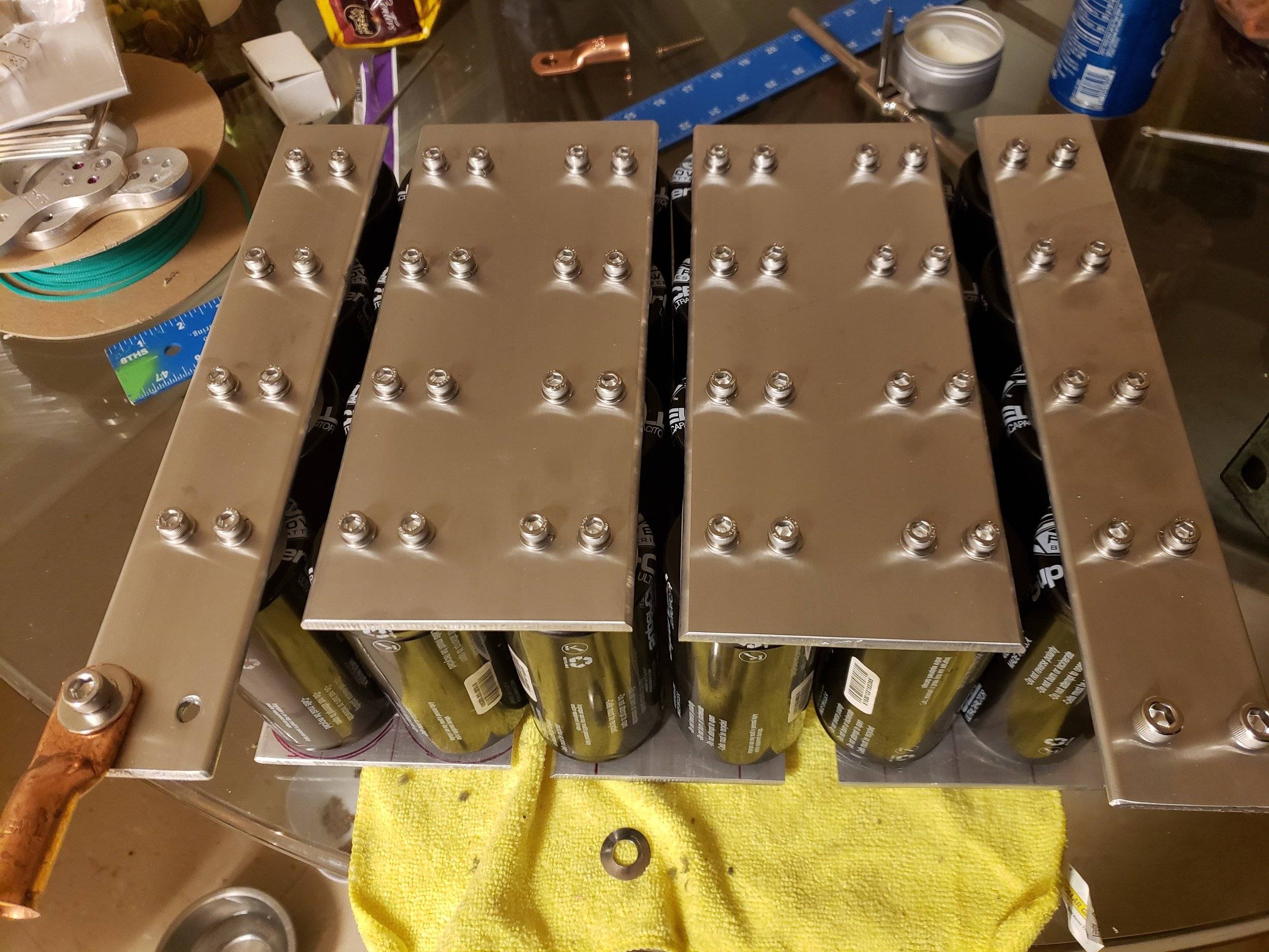

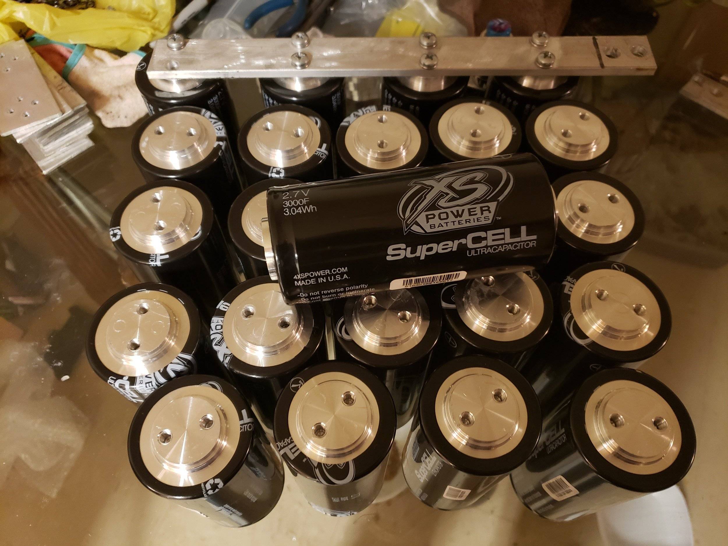

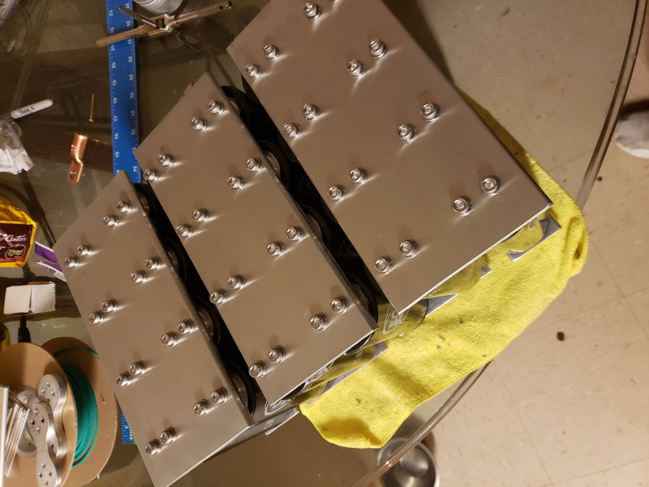

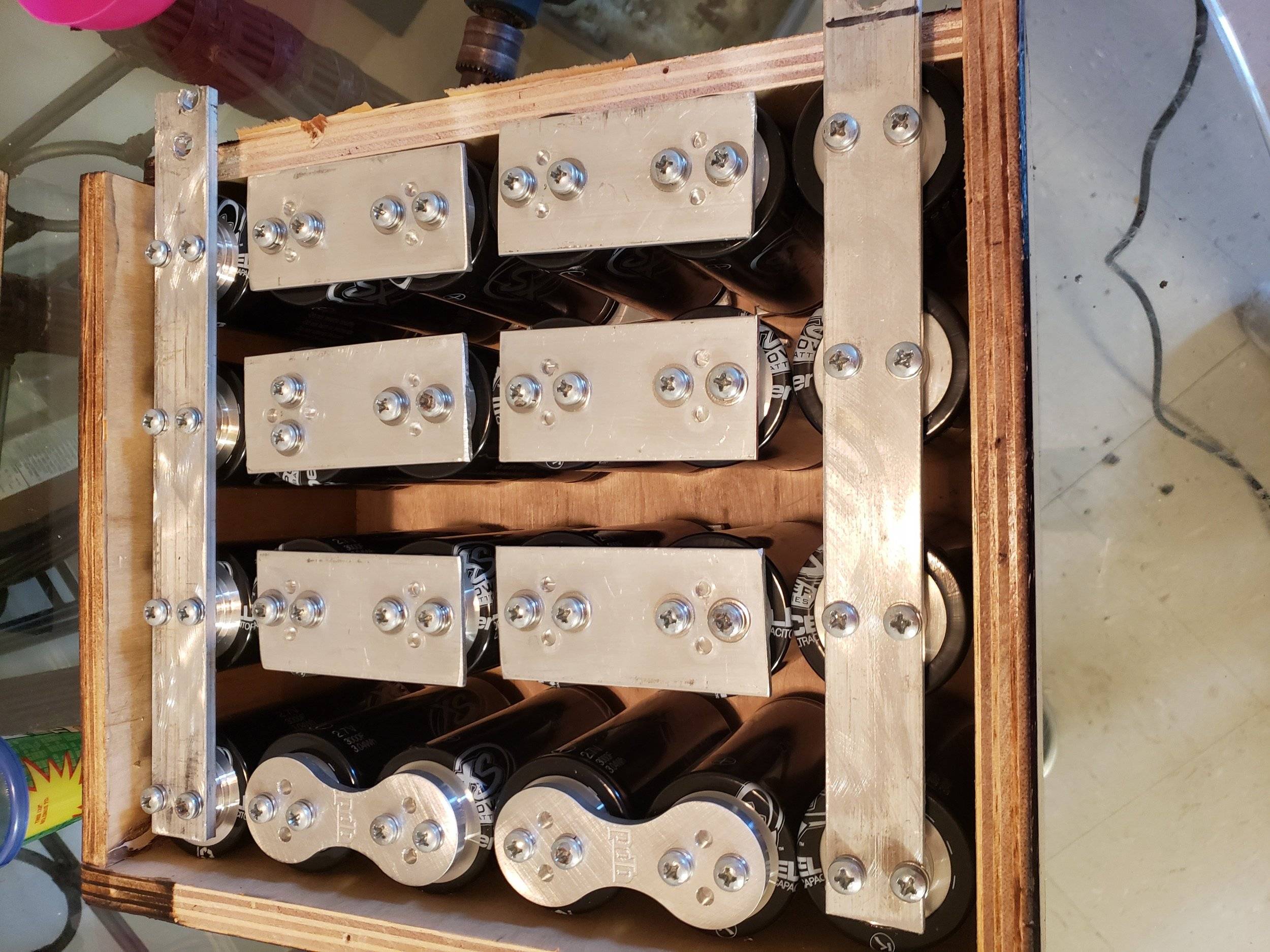

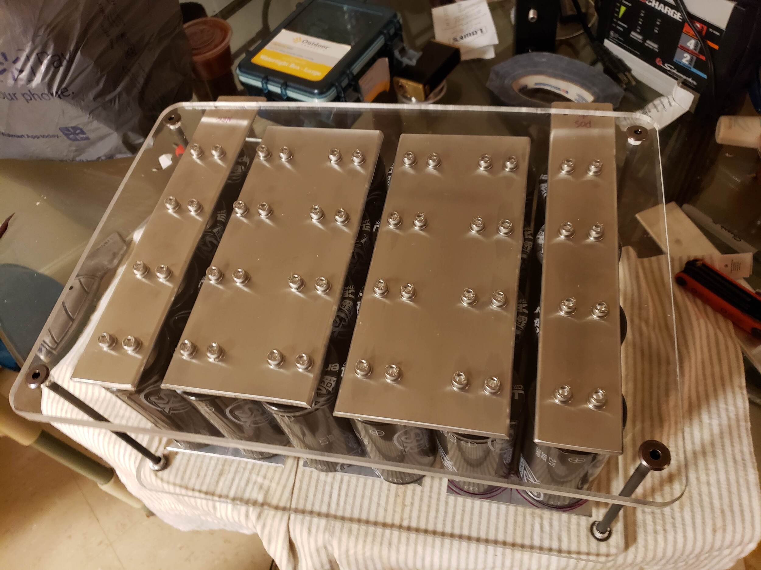

Decided to re-buss my ultra caps. Before it only had 1/8th bars. I used good highly conductive 6061. First time doing this and come out great. This should be a lot better
Before
After

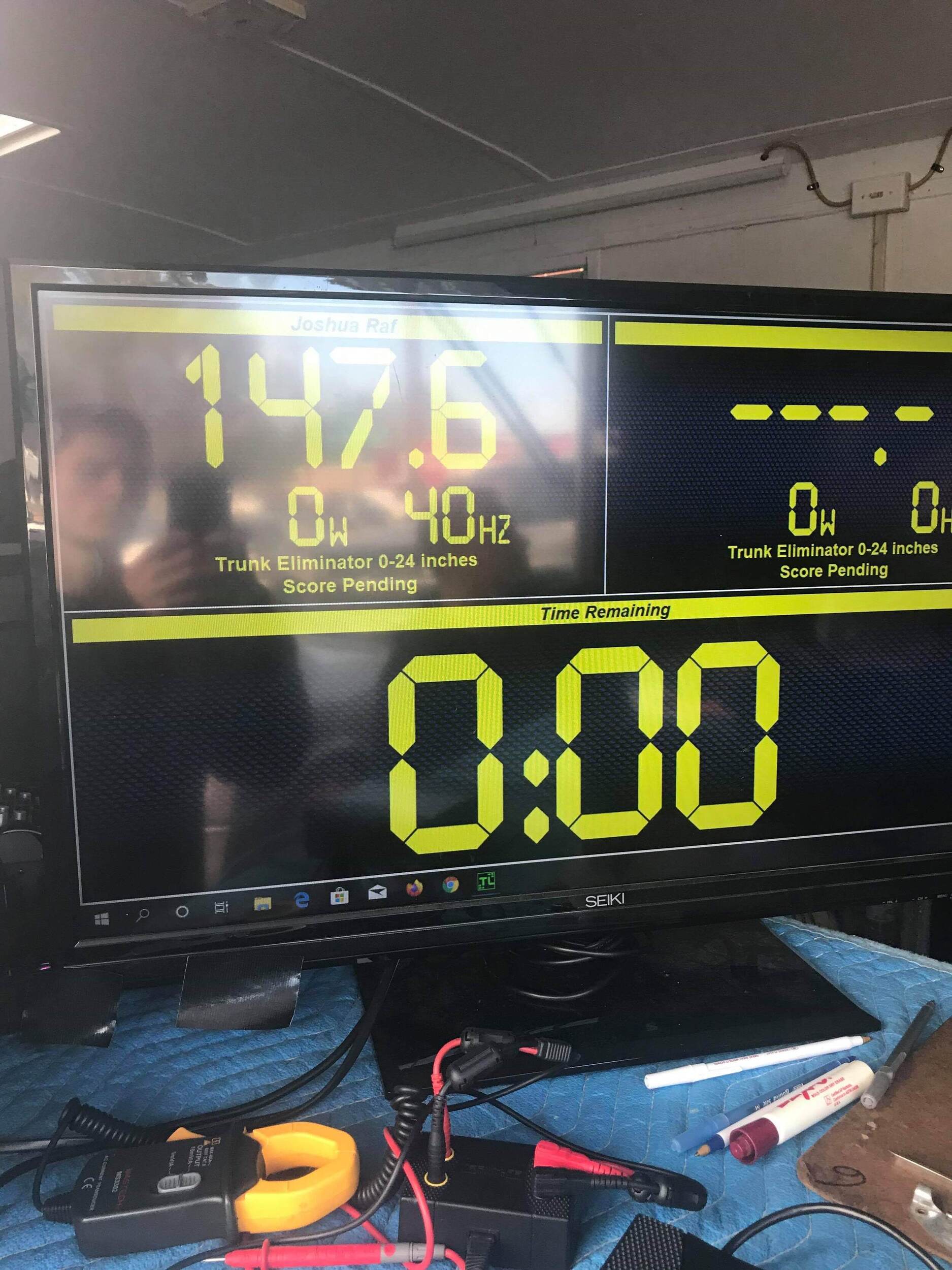

So how well did it do at the last event you went to with the Sa's?.. just curious

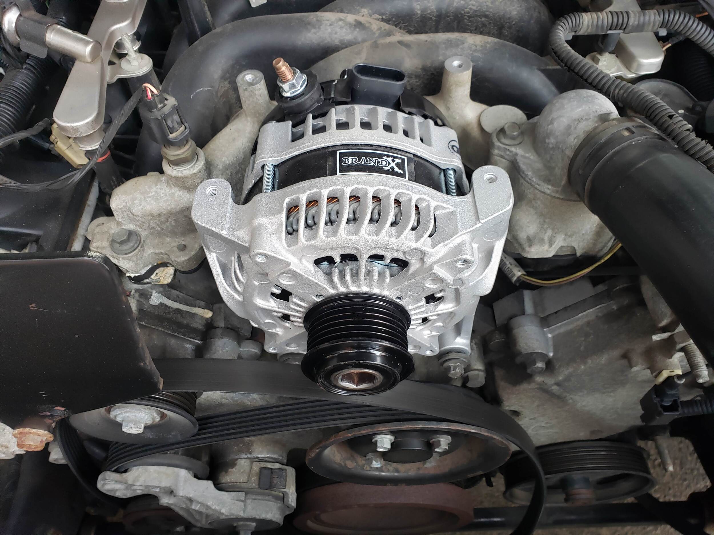

Last event was world finals @ 145.1. It was 90+ degress and had a PCM regulated alt @ 13.2v (that was on a 30 second music run). I should be able to maintain a 146.5 or higher now that i have 270amp alt @ 14.8v. I haven't even ran a sweep to be honest so my res feq could be well off. Going to run a sweep Saturday in NC.
Put up my highest numbers yet. 30 Second Music Run - Meter in the kick, Driver window down. Im sure i can hit 148 on a 30 sec music run and 148.5 on a burp. Will be running sealed and hardcore next show to get my burp scores.

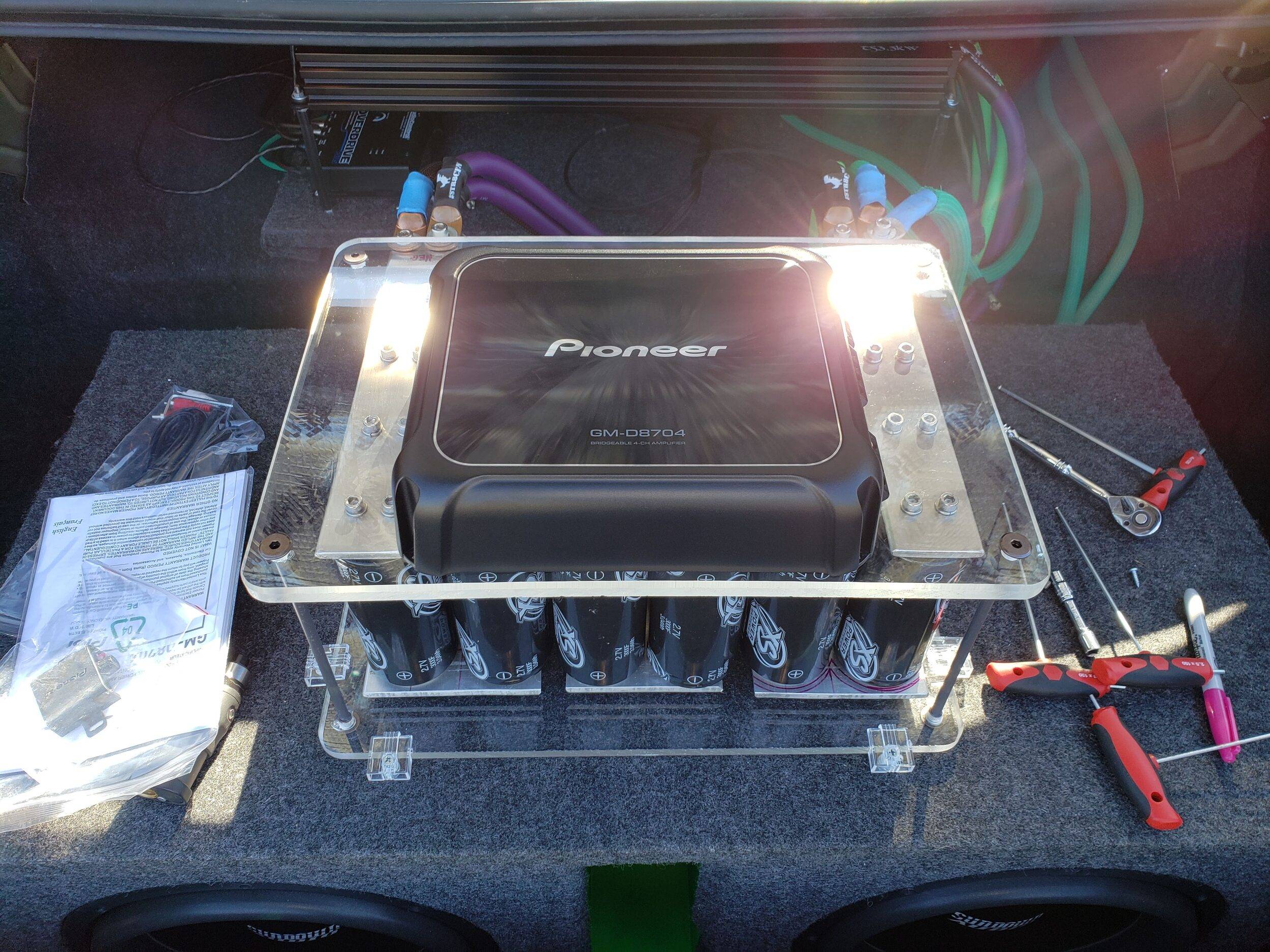

2x SA-12's
TS 3.5k
Brand X 270a
2 AGM's
4 Banks XS Power Super Caps

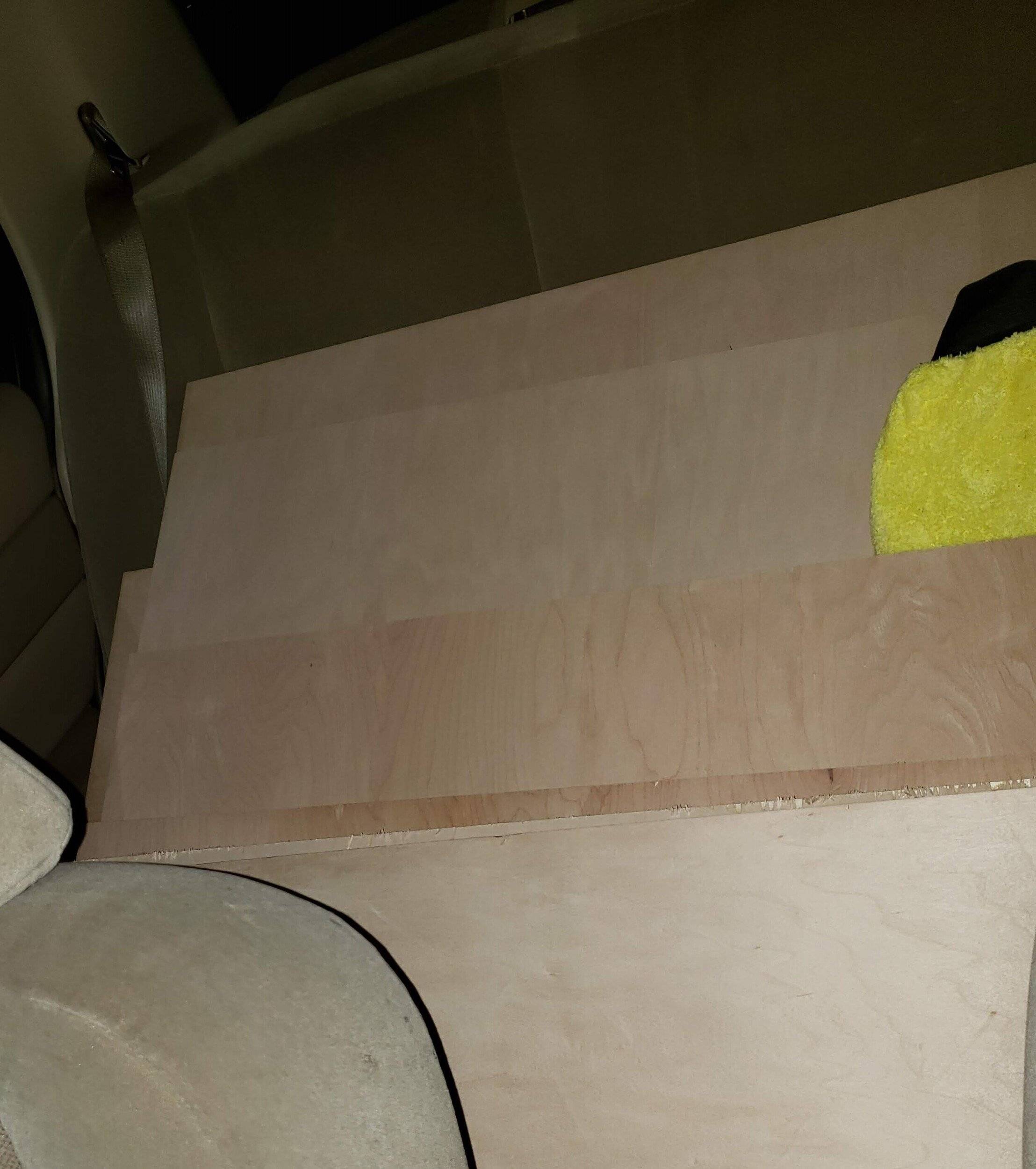

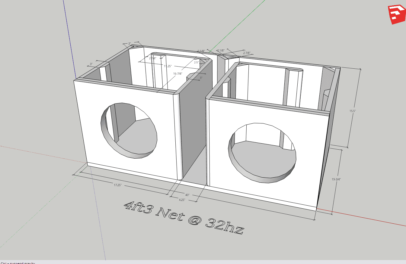

Been designing an enclosure. Hopefully ill have it built and installed by Saturday for the show.
