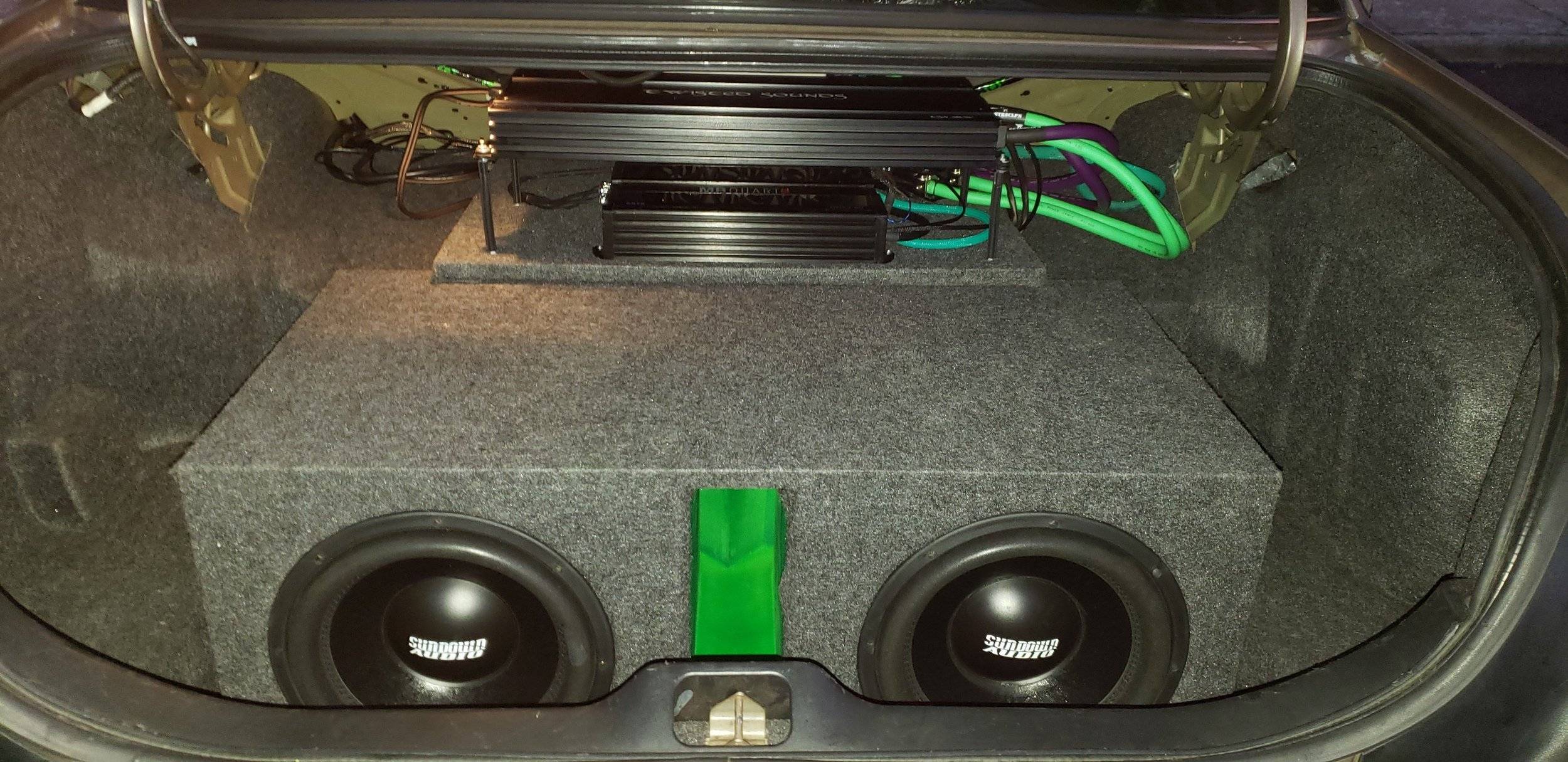

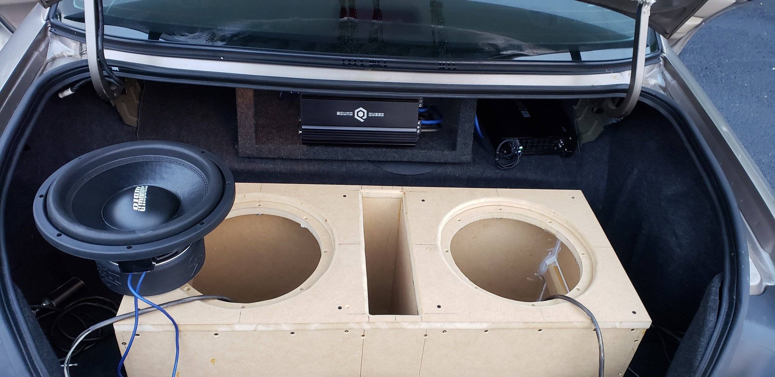

Working out great with the increased power. Im waiting on my RCA's from knukoncepz so i can hook up my RCA Knob. Then im going to gain match and go from there. Enclosure seems fine, but when i get back from Sundown Audio show im going to build a New box made of birch. Maybe we can get together and come up with another design?

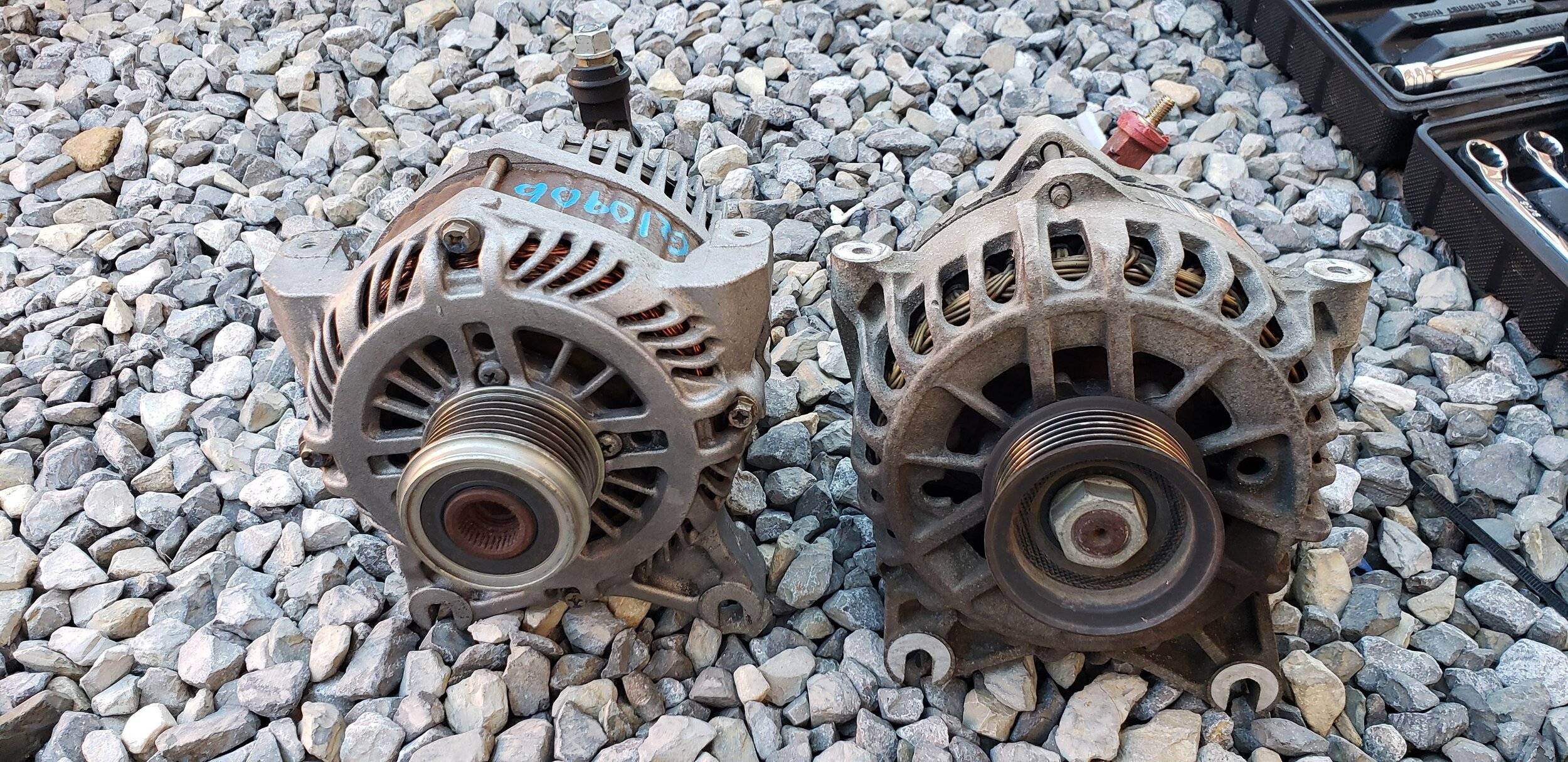

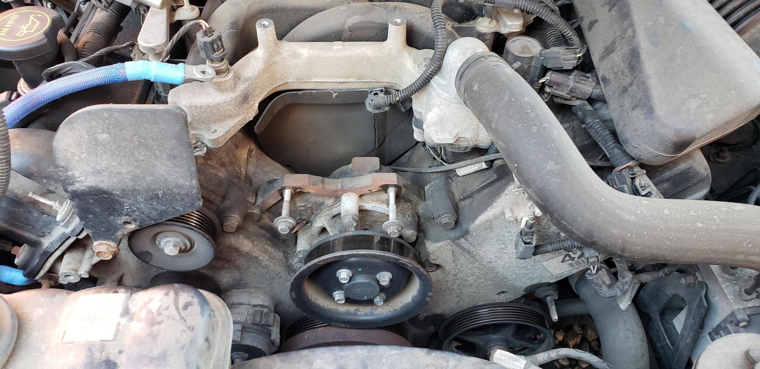

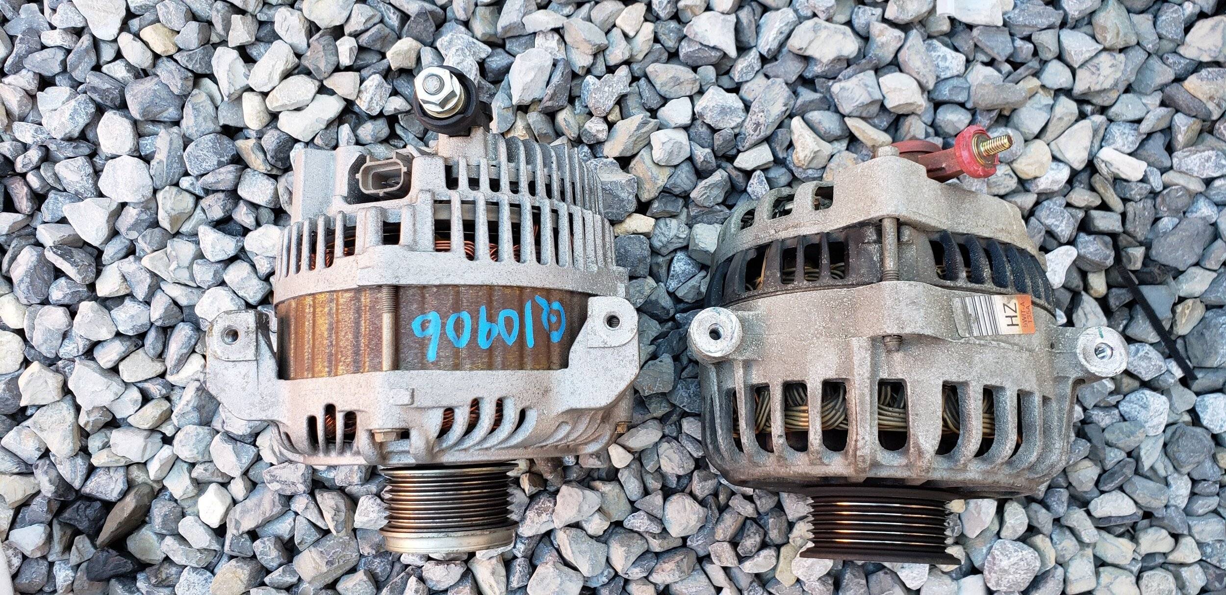

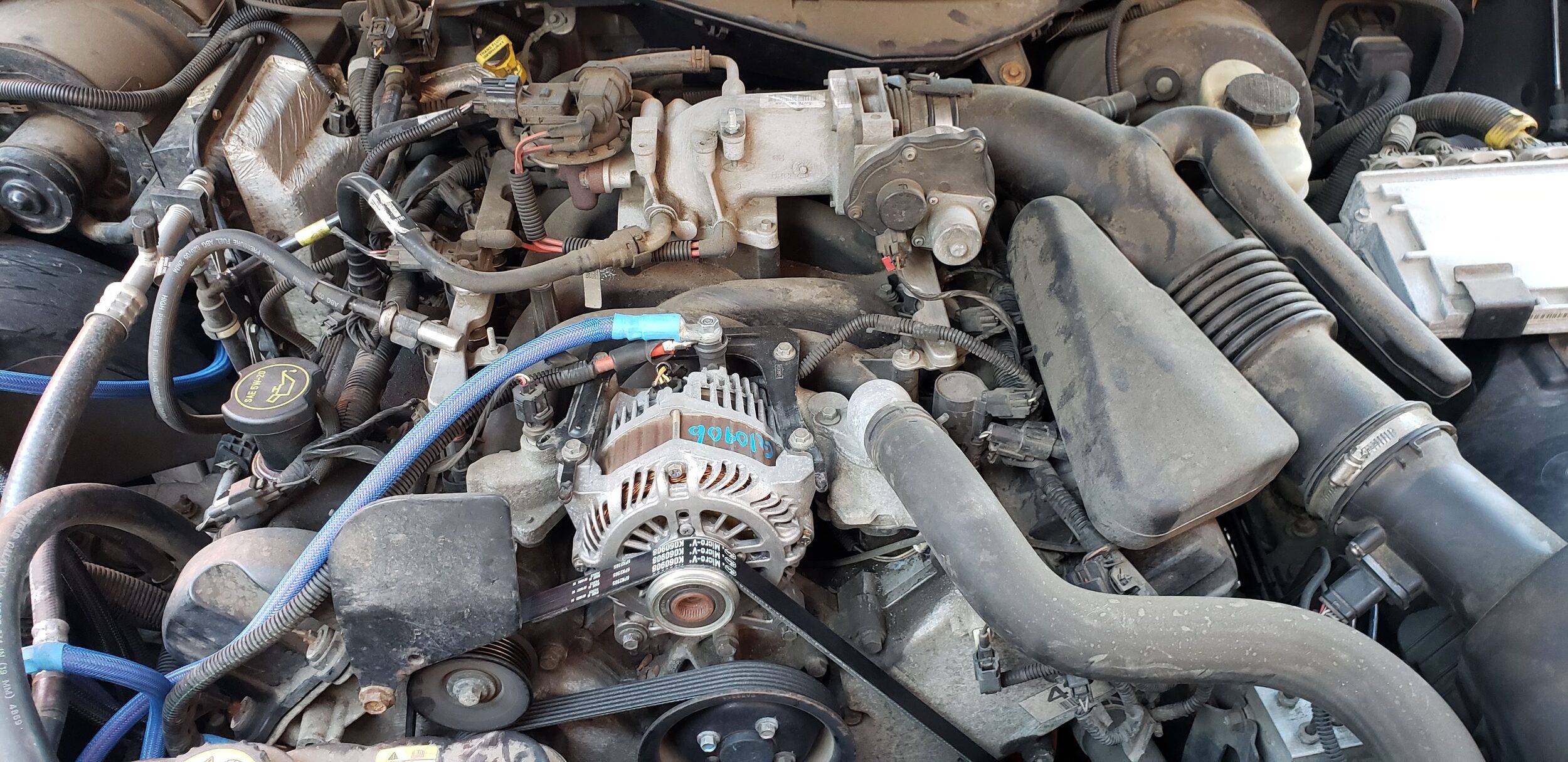

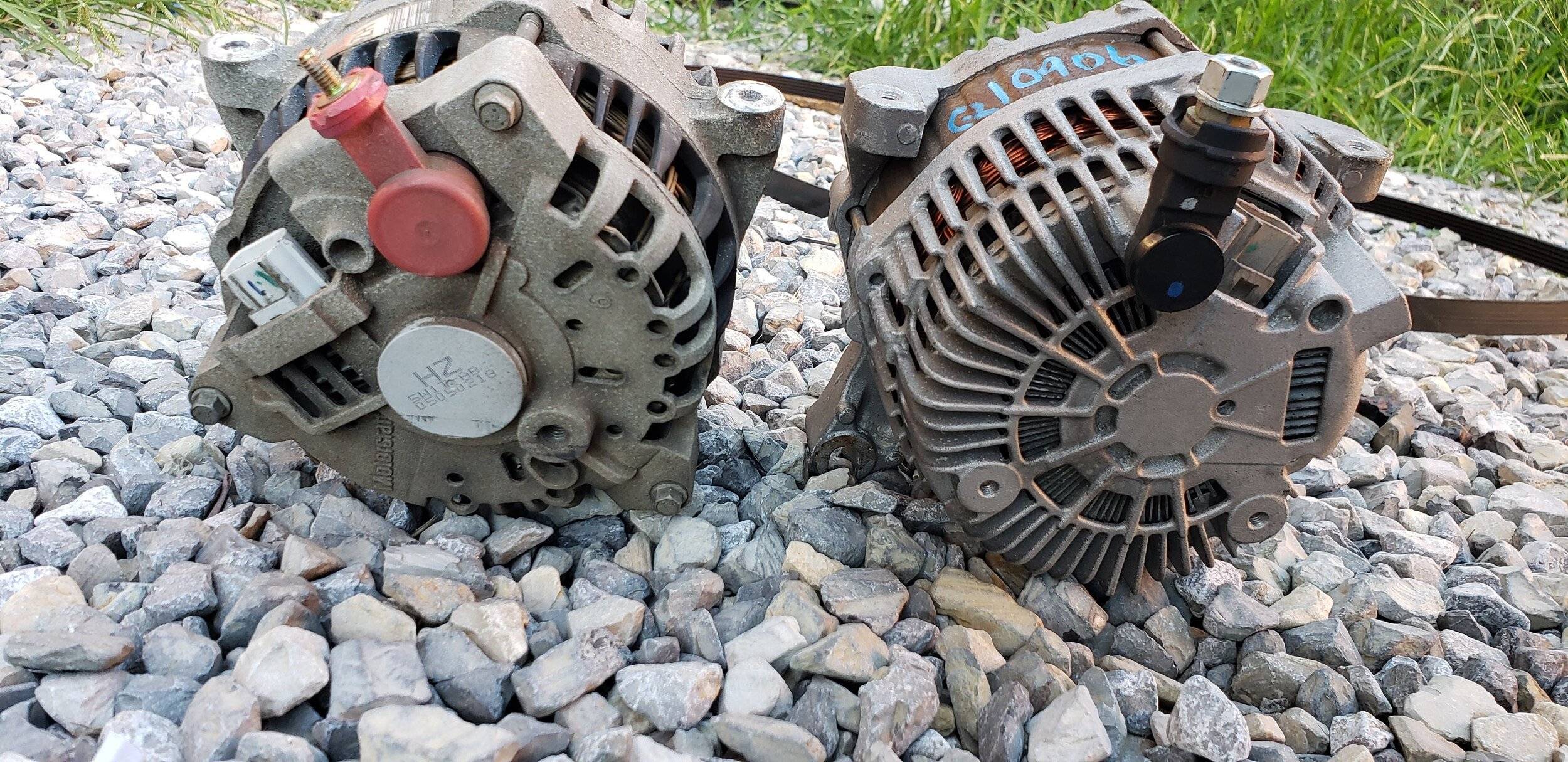

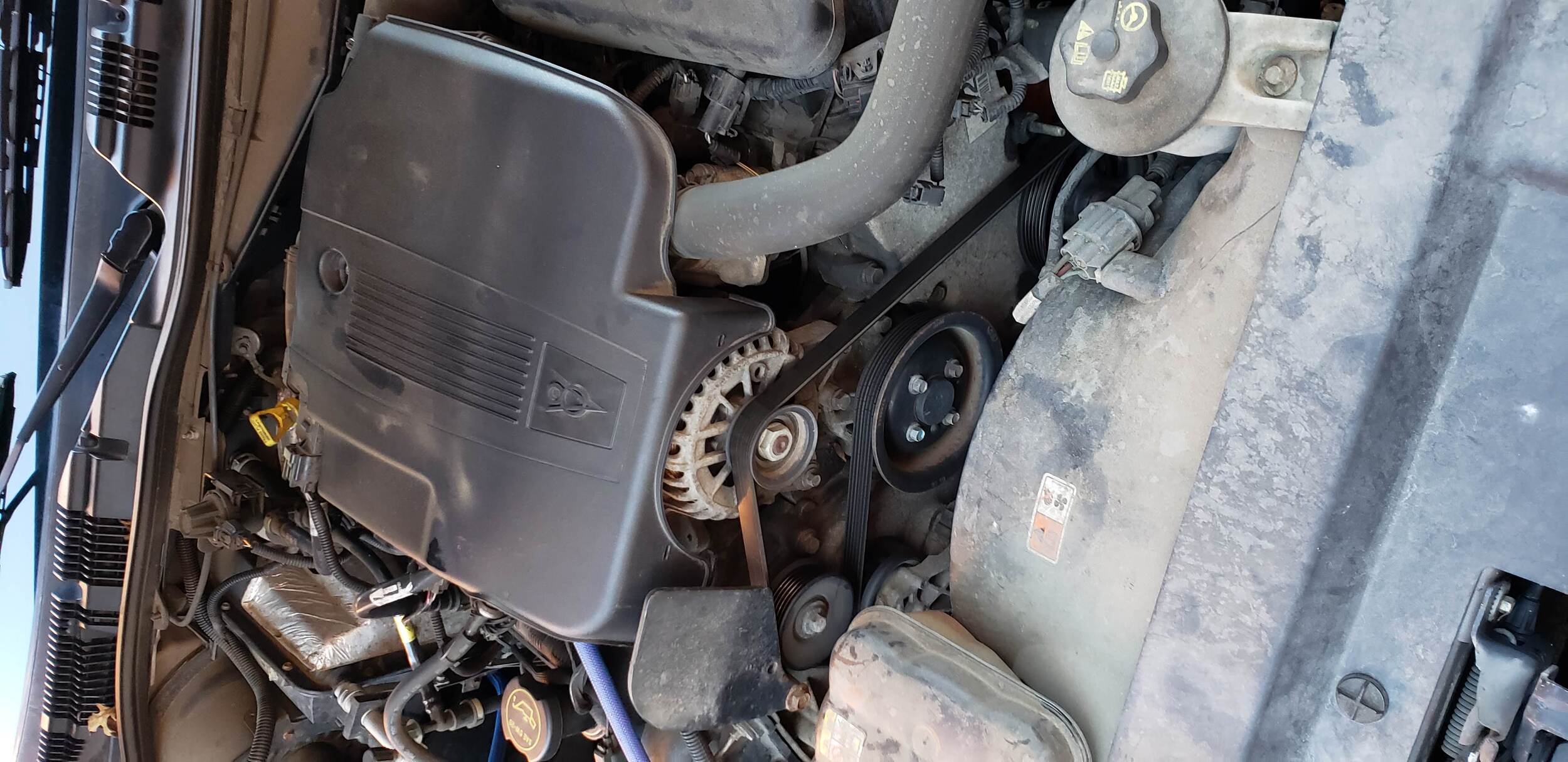

Upgraded from a 135amp to a 200amp off a Police Interceptor. Only 50$. Its in really good condition. Now i just need to figure out a way to get my voltage up. This year Crown Victoria is controlled by the PCM. I read i can add Rectifiers on the sense wire to boost it .7volts. Anyone know how to acheive higher voltage with PCM regulated alt?

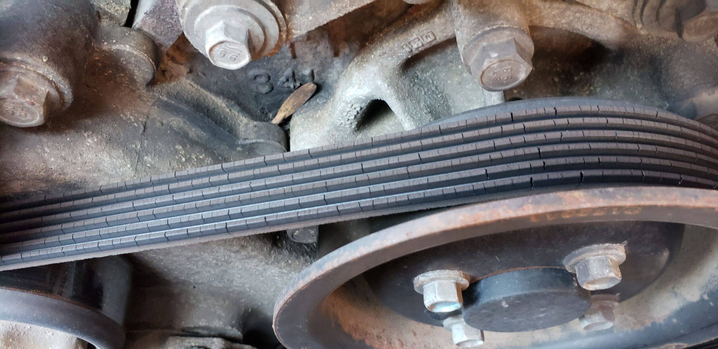

Only a couple things left to get done before the show next week. The left alt is the 200amp - Right is factory 135amp. Also replaced the belt. The old belt was heavily cracked

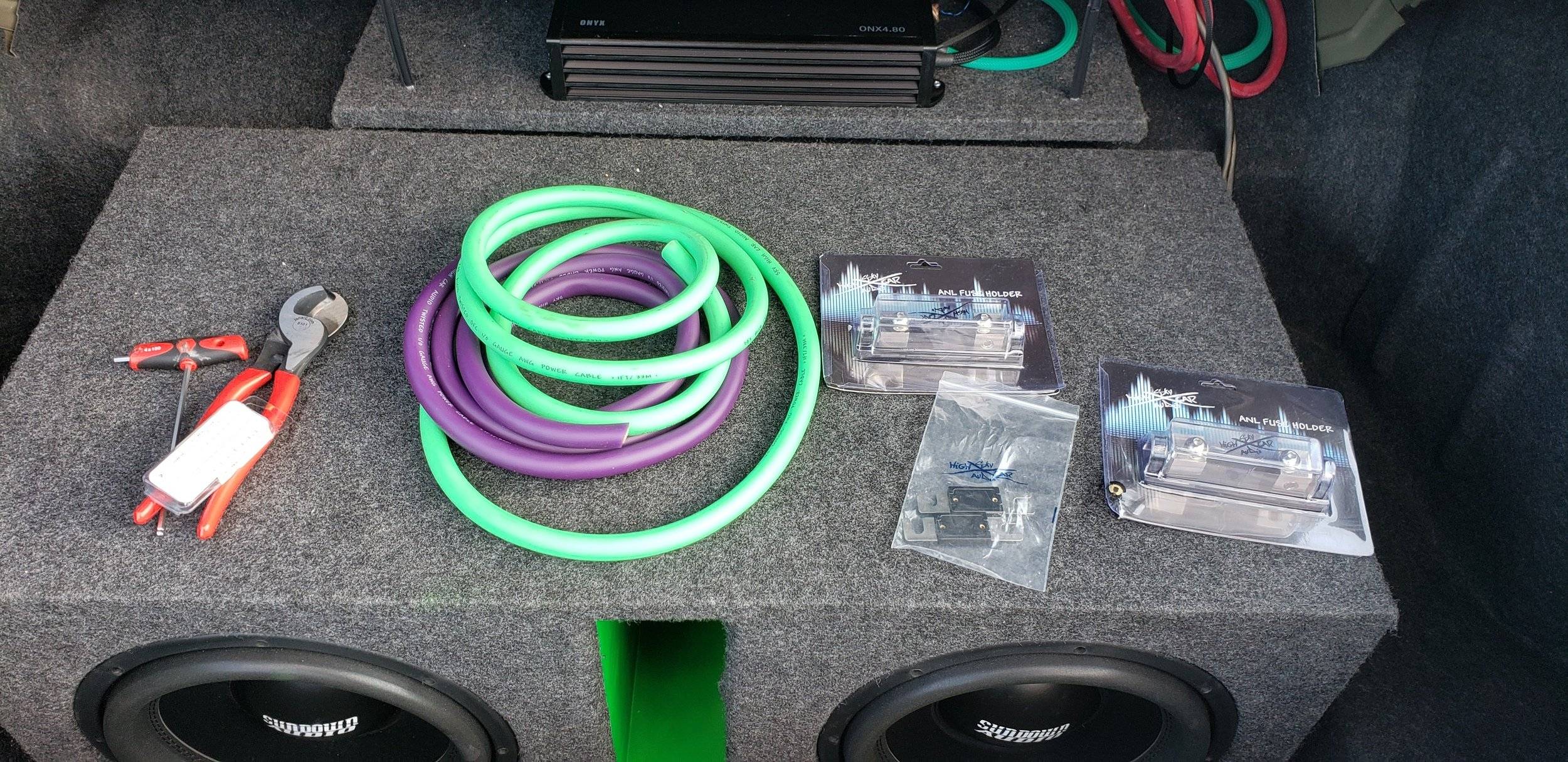

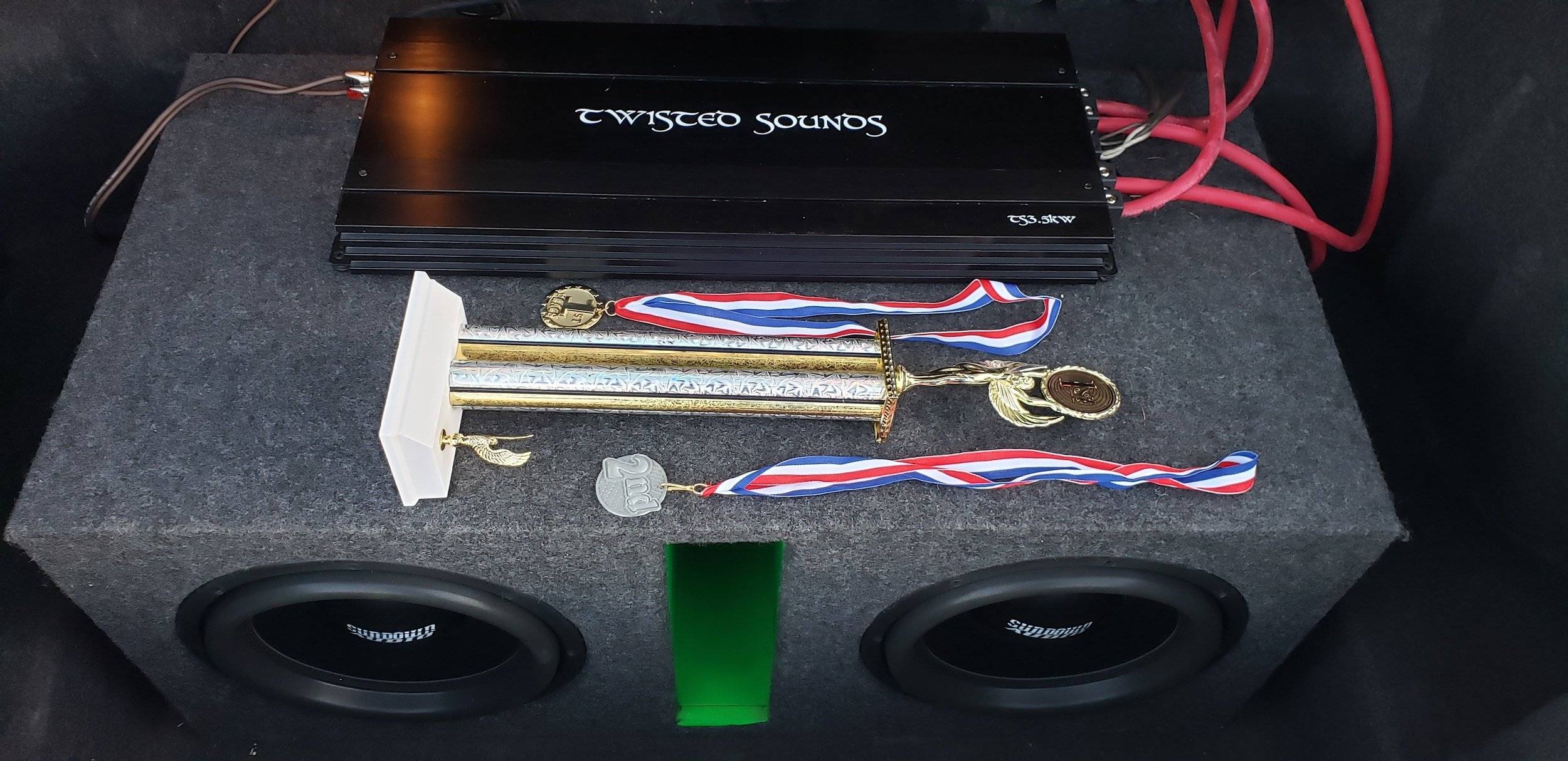

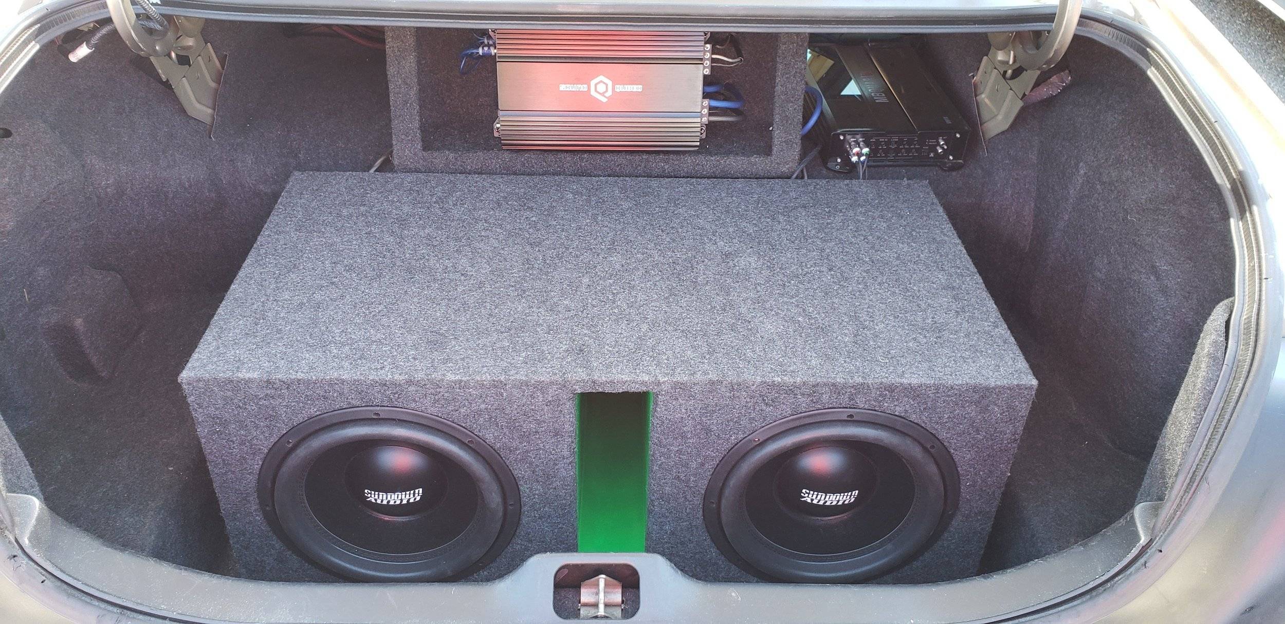

Update. Not much of a budget build anymore. Built a new box and just purchased a new amp. I have went to 3 competitions. First one I did 140 in the kick, 2nd show 143 and Saturday did 145.5 with the new amp. Had my gain set low as I only had about 15 min to play with it.

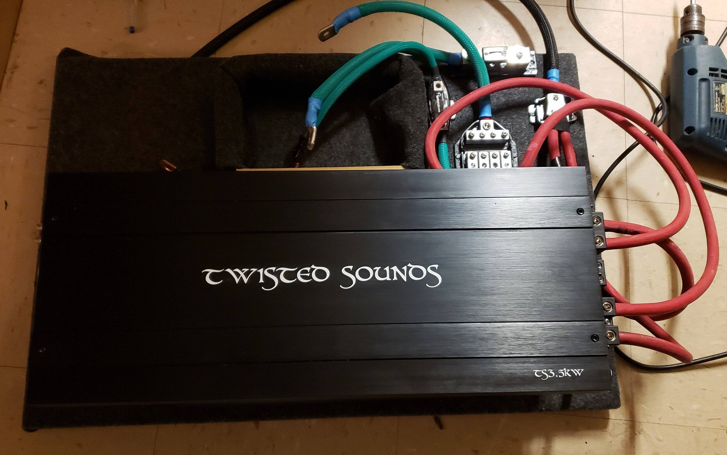

New box and amp. Building a new amp rack now and have sky high audio wire and fuse holders coming Tuesday
Red wires are being replaced and fuse holders Tuesday

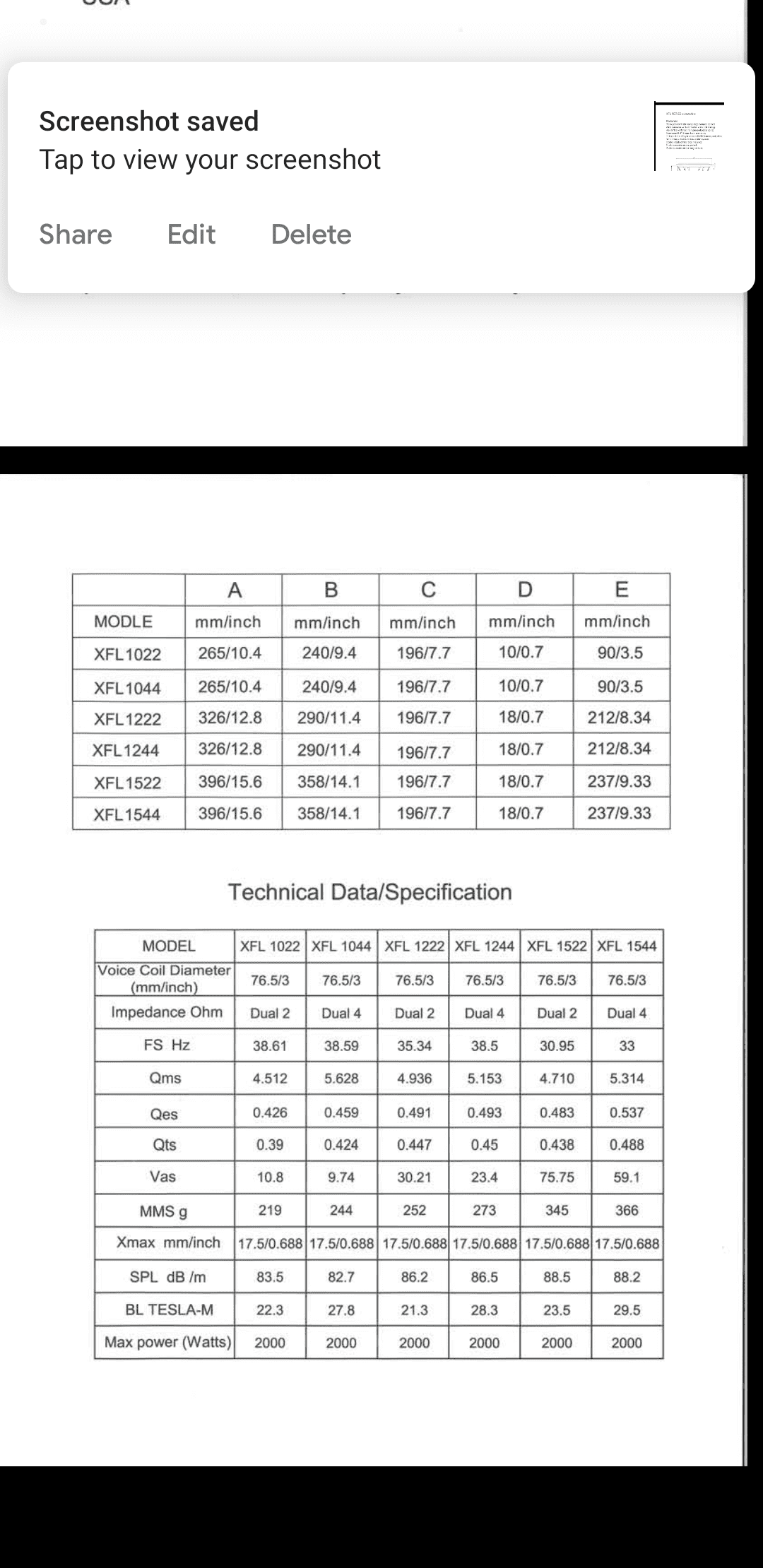

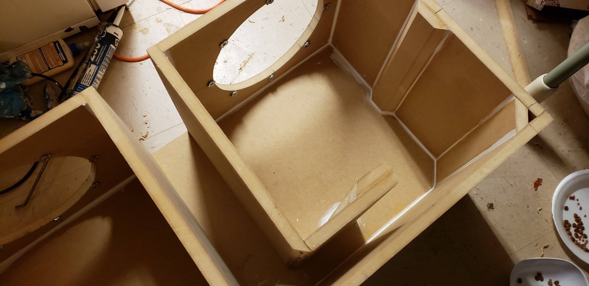

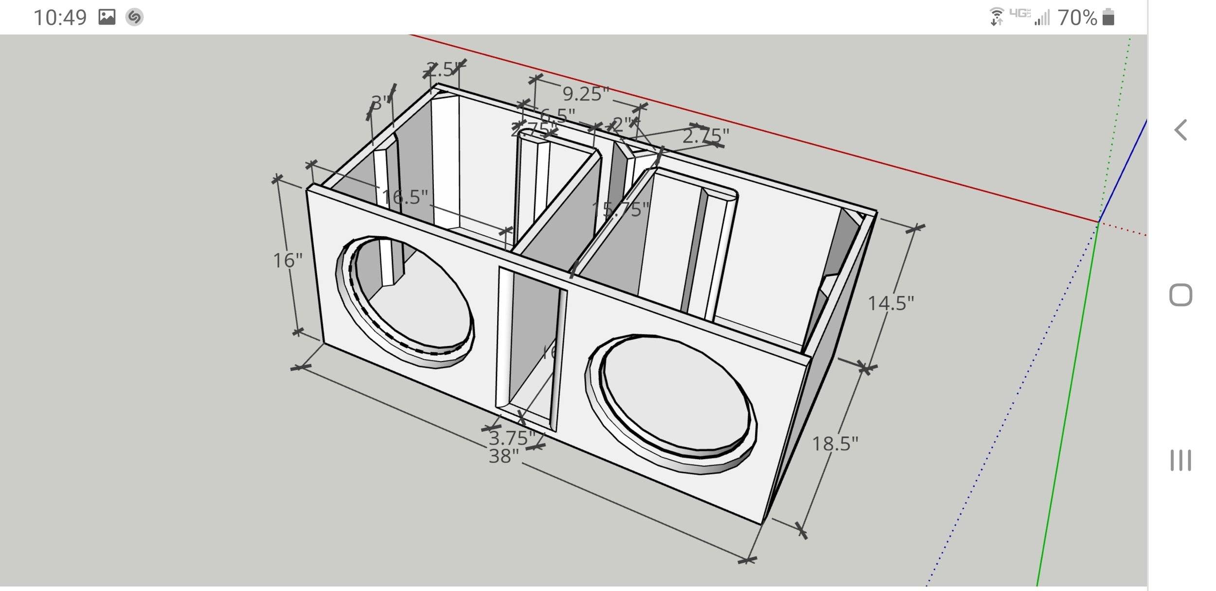

Let me know the max measurements and what music you listen to and I'll see what I can do
38w x 25d x 16h mostly rap hip hop. I'll pay for blueprints and a cut list sheet.
I have a small lumbar yard/cabinet store down the road that said he can make any cut I need.
After that I can put a box together lol

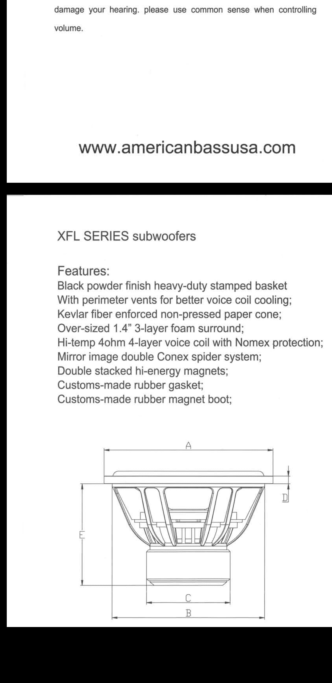

Speaker specs are for xfl1244
18189
18190

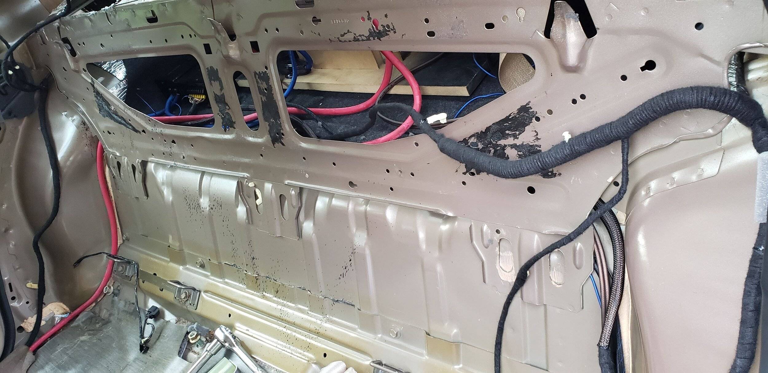

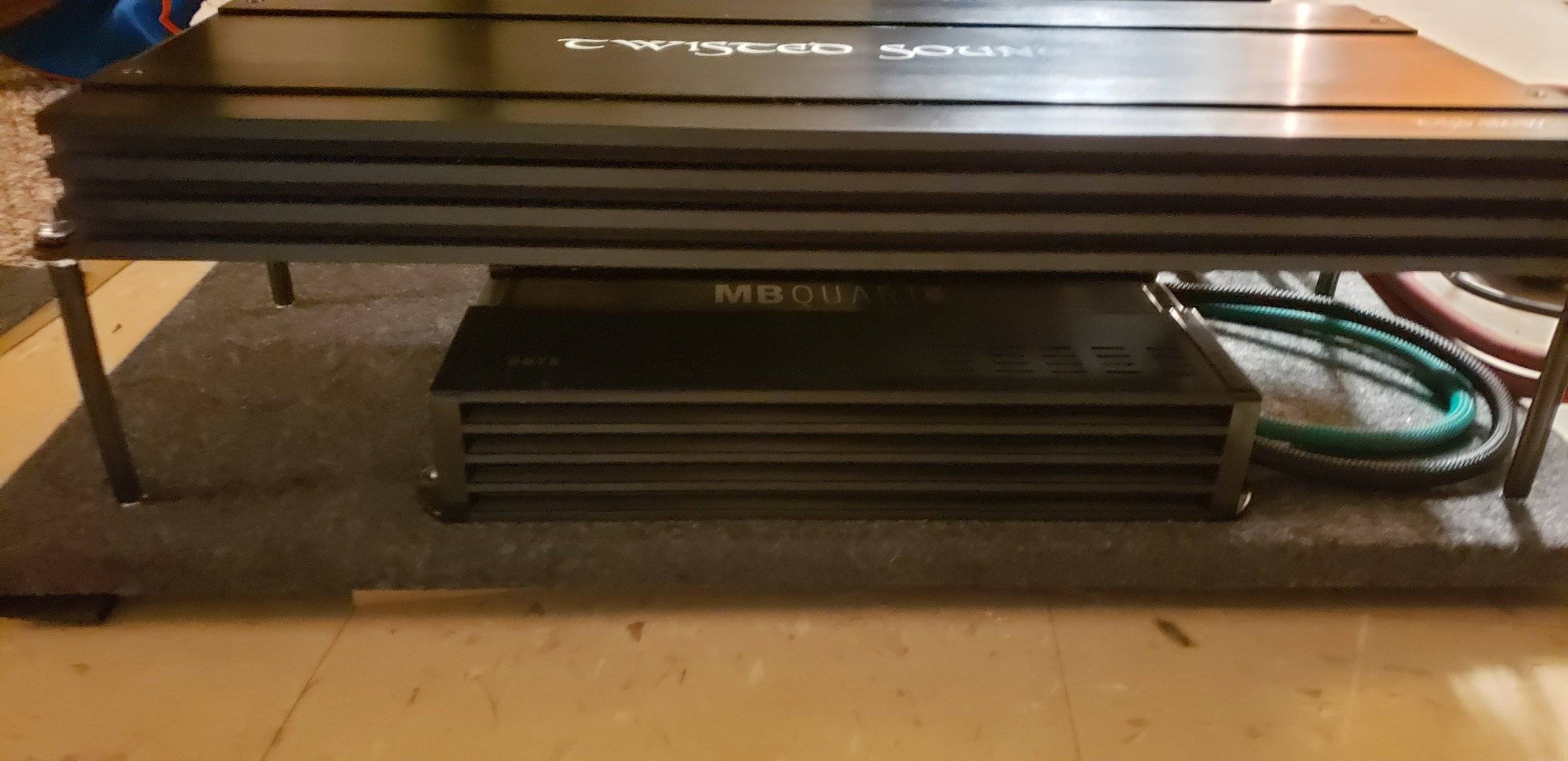

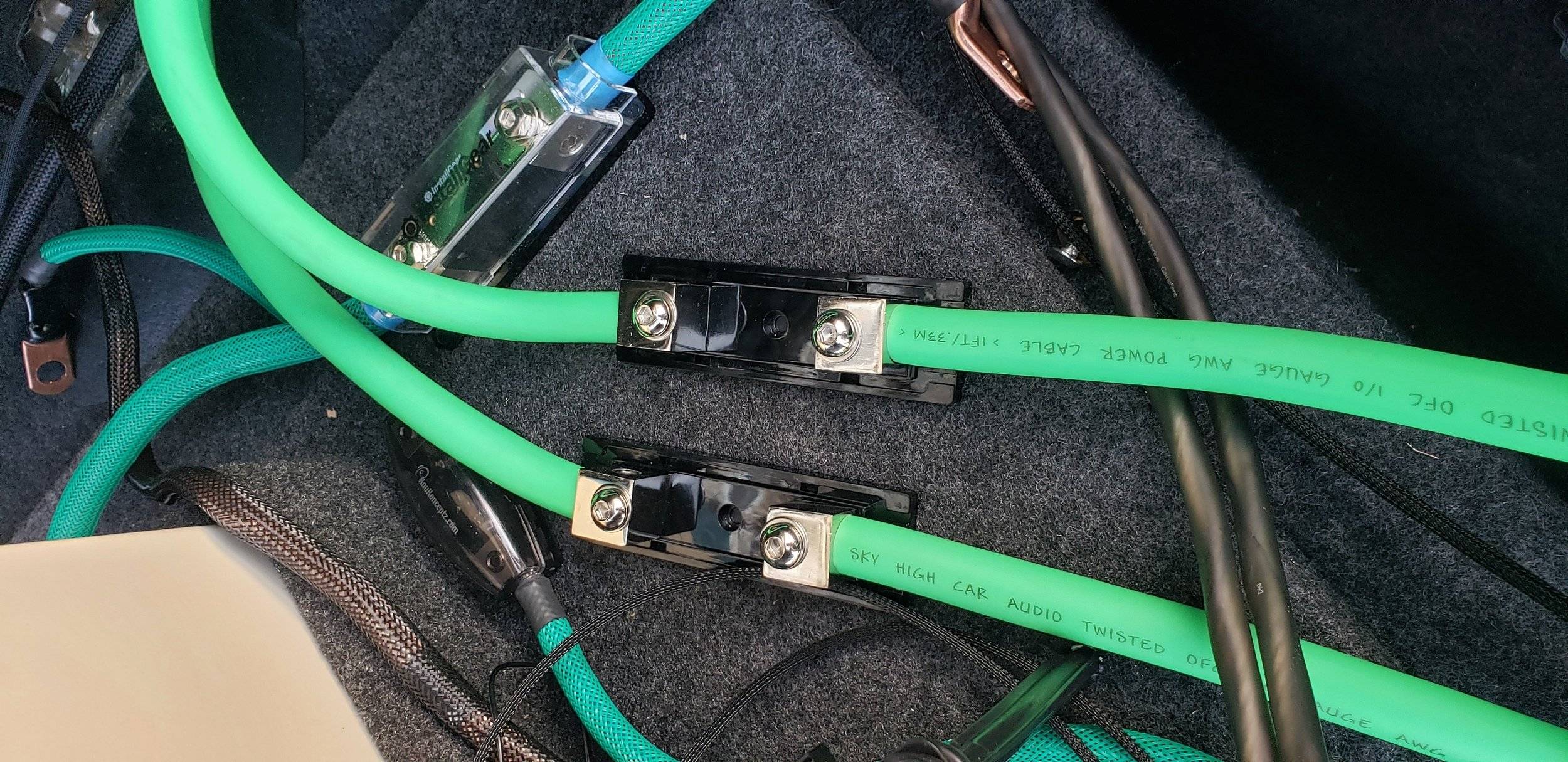

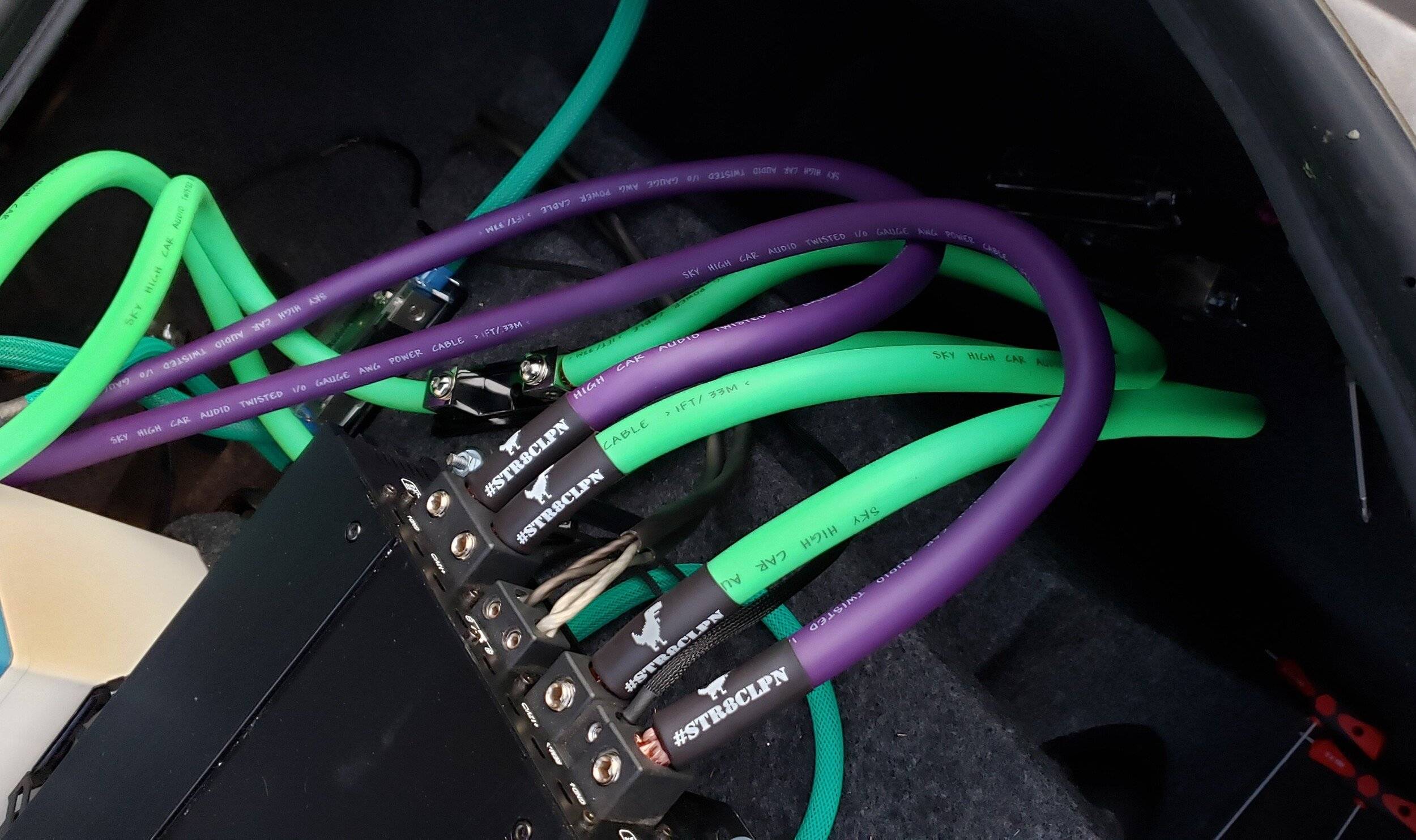

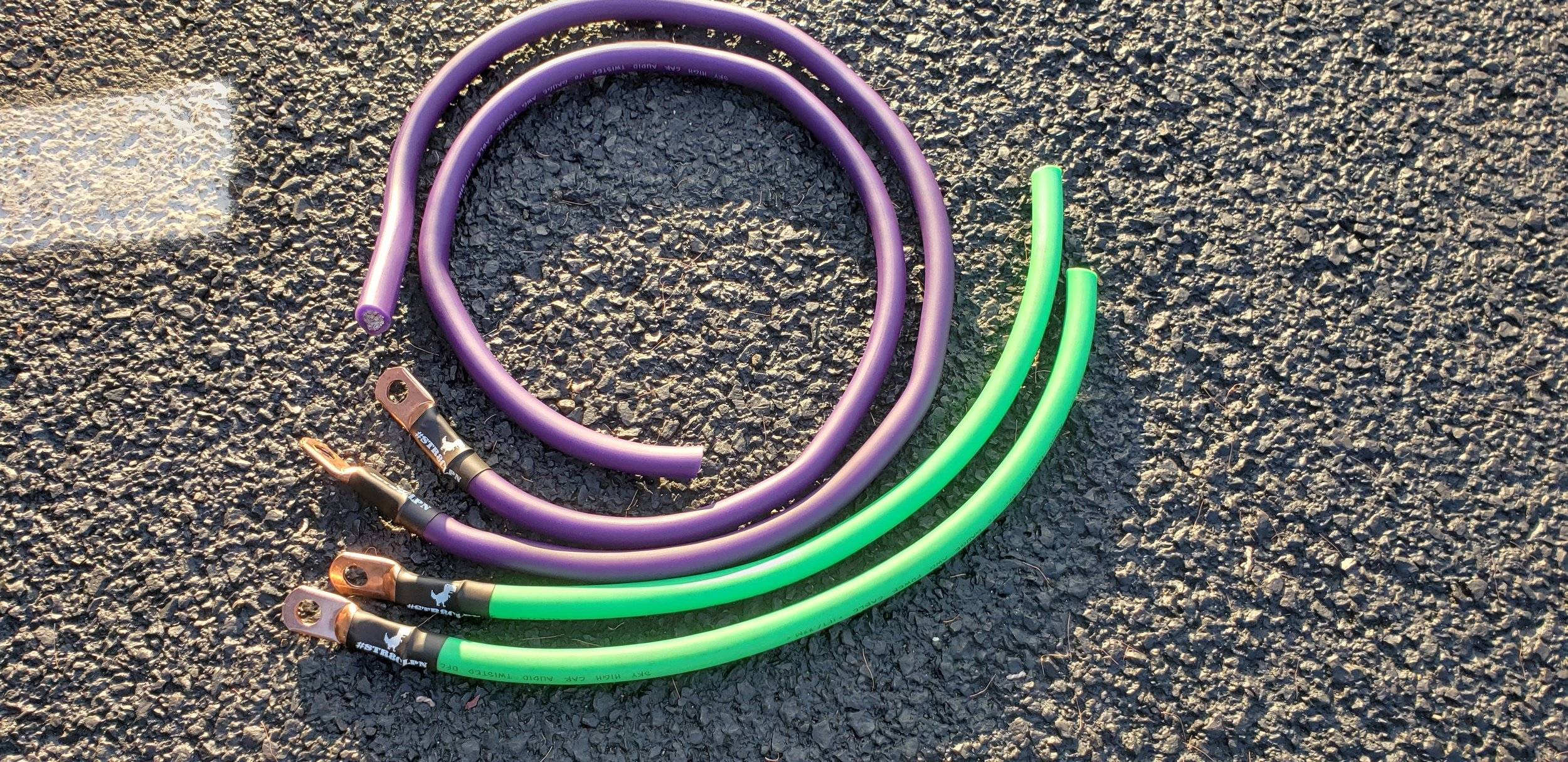

Rewired the amps and fuse blocks. Sky high. Should have my overdrive plus this week so I can get my gains set. World finals this weekend if weather doesnt cancel it
