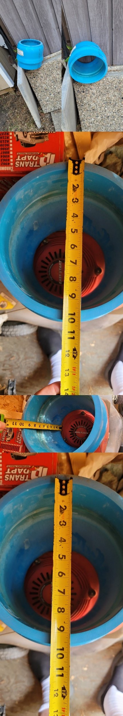

Last summer they redid the water main on my street. They had a lot of left-over pipe cutoffs and I asked them for one, which they gave me.
I thought it would make a cool speaker enclosure.
I intend to make it into a subwoofer enclosure and I'd like to hear your thoughts, recommendations, and any caveats.
Here are some pictures with measurements, and I was thinking of using a Pyle PLPW8D sub, mostly because it's inexpensive and I don't want to spend a lot on a project that may not work out. Oh, and to save you the math, it's 636 cubic inches, or 0.368 cubic feet of interior volume.
I have some high grade, 1/2" plywood I was going to use for the end caps. Screwed (drill some holes and tap them) and glued.

If you seal it up tight it will work fine. A tube is structurally stronger than a square box. That's why the Roman's used arches in their building designs.
Hey thanks for the reply. That's what I thought too. Those pipes are a high density plastic and very tough and stiff. I figured it would make a good enclosure and a little unique.
My biggest concern is the small volume and my choice of speaker. I'd like to use a Kicker 48CWRT84 CompRT 8 (or even 10) but that's way outside my budget for this project.
I'd also welcome amp recommendations for this build. I'm looking for a decent quality low cost amp to power it. In the old days is have thrown a Punch 45 at it and called it good. But a decent low cost 100-200 watt would be great too.

Not sure what the budget is, but a Dayton classic 8 inch woofer is 65$ and would work perfect for that space. It’s 150 watts rms.
That's why I posted here. Great tip. I had thought of Dayton, I just didn't know what models to look for in this size enclosure and whether they'd be a good choice for a car sub. I always tend to think of them for building custom home audiophile component speakers. Not boomers. 🤗
They do well in home and car. I’ve used almost every model of Dayton sub for different projects. Probably more SQ oriented than SPL for sure. Most of their subs seems to do better in sealed enclosures than ported in my opinion.

I really like that Dayton and I think in the future I'll build some speakers specifically around those. However I really wanted to stay on budget and Amazon sealed the deal by putting two of the components I had in mind for this project on sale big-time. So I ended up getting a Pyle PLPW8D 8-Inch 800W Dual 4-Ohm Subwoofer and an Alpine BBX-T600 600W Max BBX Series 2-ohm Stable 2 Channel Class-A/B Amplifier.
The Subwoofer arrived today and it actually seems to be decent quality. The amp should be here next week.
I'm going to put square pieces of decent plywood on either end so that I can lay it on its side and it won't roll around. I'll mount the amp on the opposite end from the speaker and put handles on it so I can move it between my car and my truck, depending where I want to use it.
