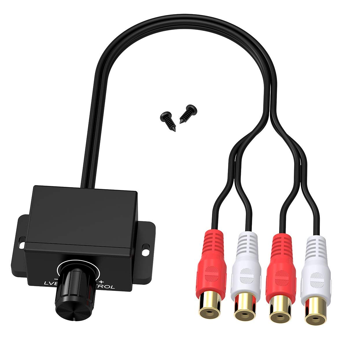

1. Bass knobs- I have a bass knob for each amp in my dash. However, I don't like them. When I turn them up, it sometimes makes the audio quieter. As far as I know, the bass knobs adjust the percentage set by gain on the amp. They make the audio worse when I am trying to bump, but I do like to be able to mute the bass when I listen to a talk show. It seems like I get more bass and better sound without them connected. Should I leave them connected?
