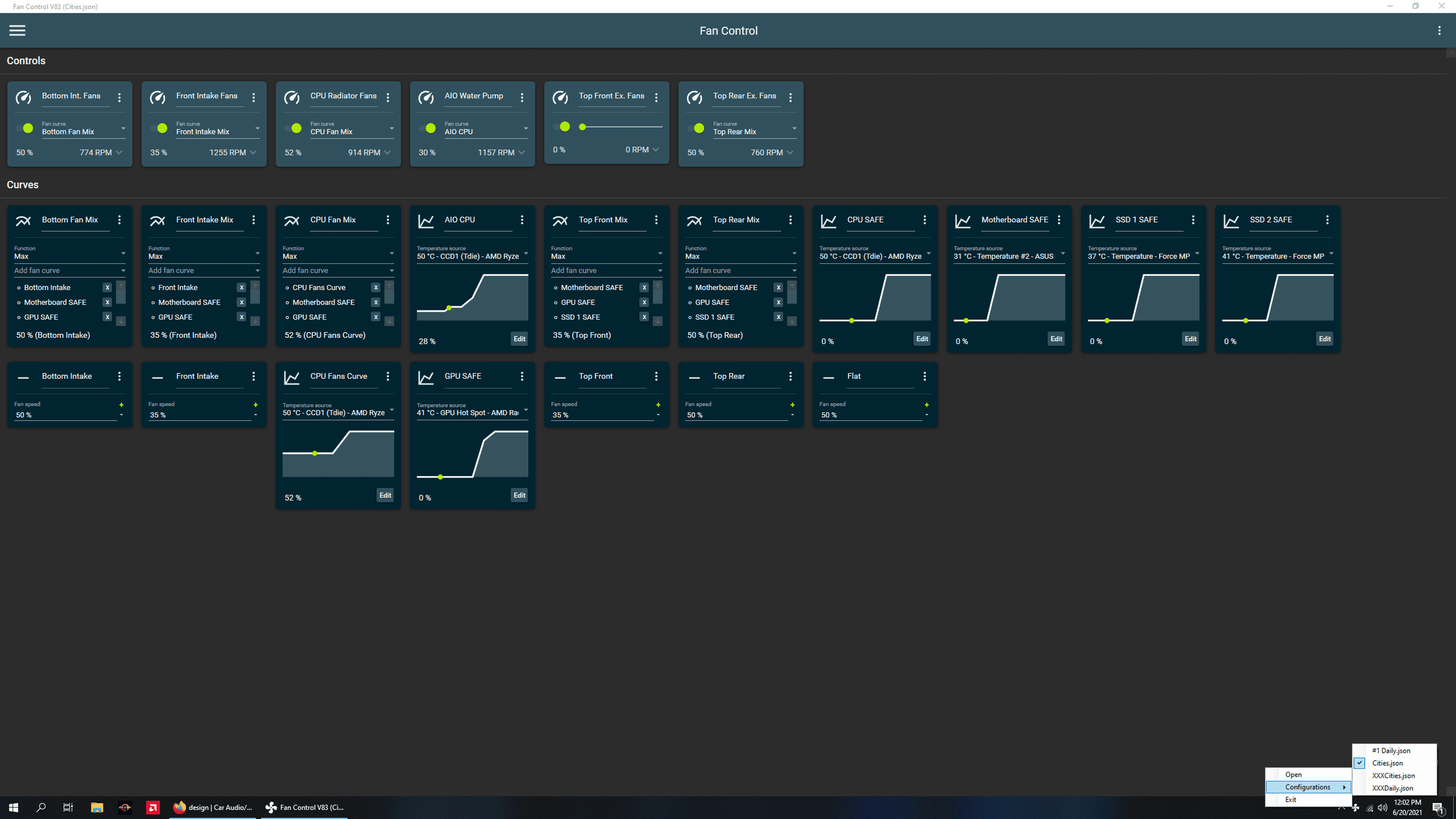

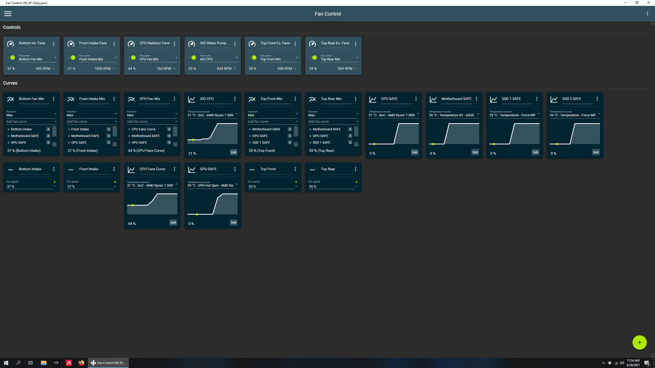

Here's where I've wound up with my daily fan setup. It's so much quieter than I initially had it:
29940
This is for my fan setup for my Cities game:
29943
I'm experimenting with both MHz and voltages with my GPU, so I run my fans a bit harder while gaming. All I have to do is create two profiles and switch between them. This program loads in over the bios, so about 10-30 seconds after logging into windows, I have this program auto start so it takes control of the fans. BIOS is setup to game, aka emergency setup, so if this program fails at any point, the BIOS is set to keep everything cool.

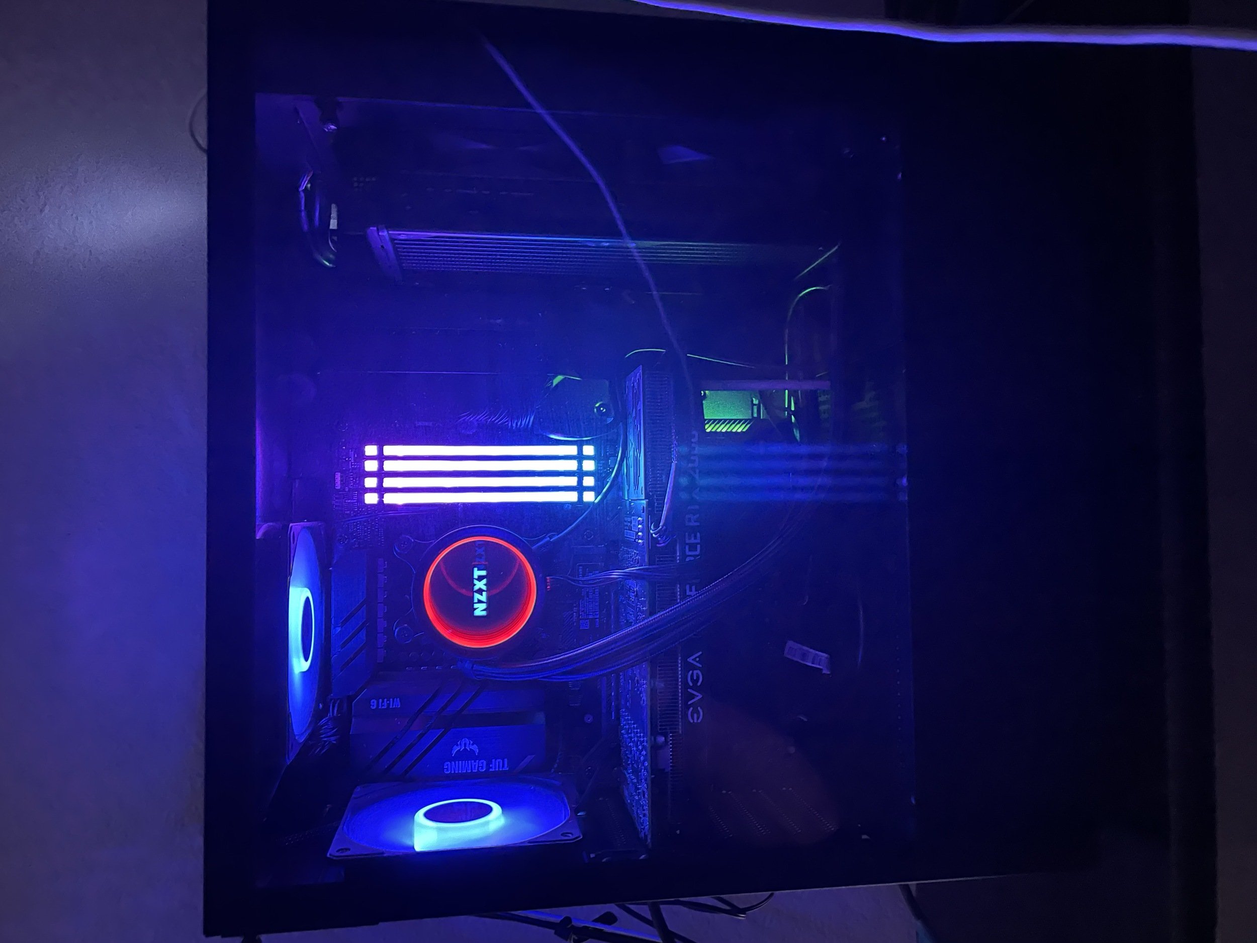

The vertical white cable is my iphone usb cable the other line crossing the radiator is a refection. I have Corsair RGB Ram it's four 8GB for 32GB total. I still need to do some cable management.

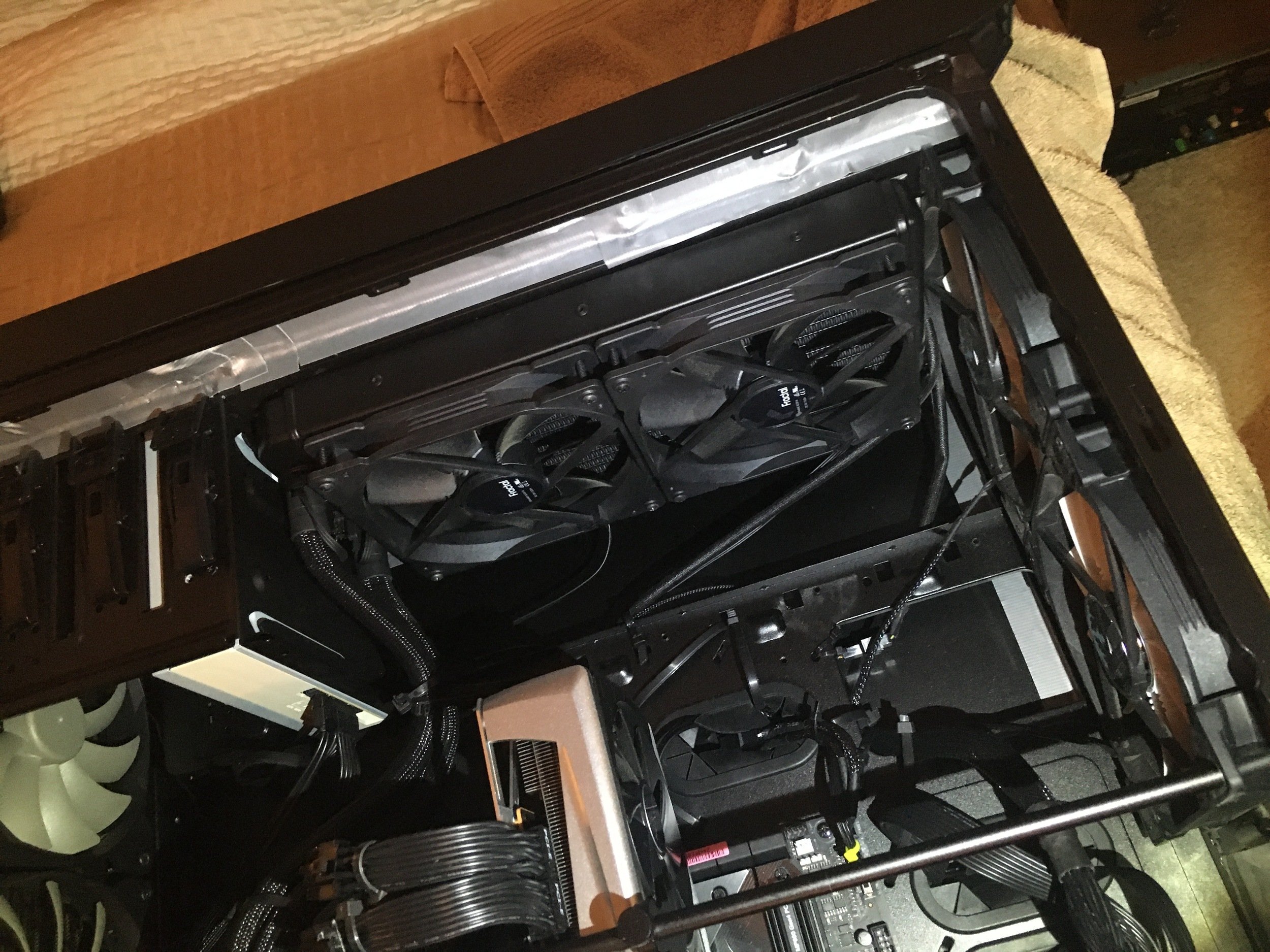

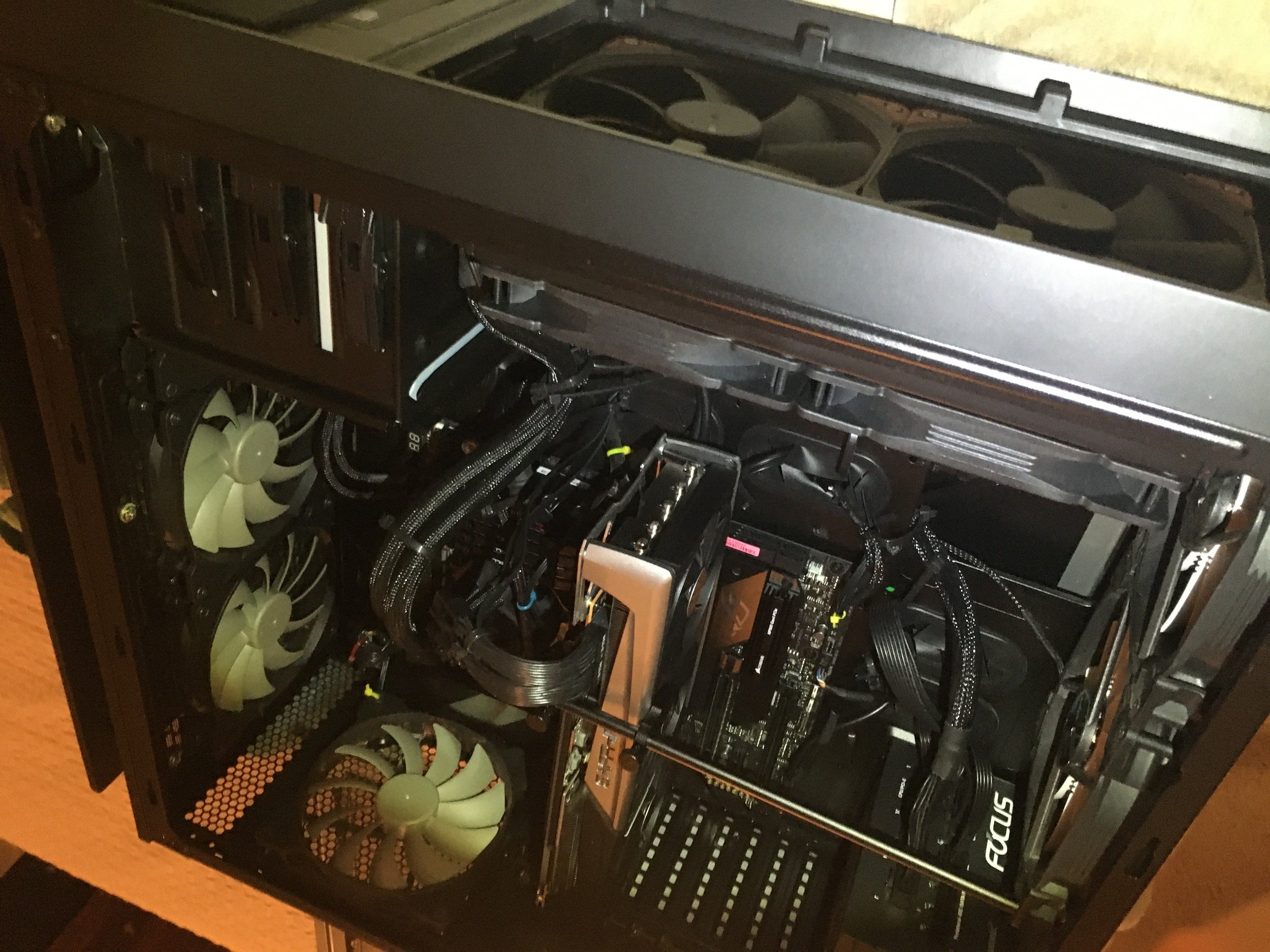

That's funny, I was messing with some stuff with my PC from OC'ing and took some pics. Replaced a CD/DVD signal wire with a longer one so I could run it behind the motherboard panel. Also did some air mods. Channeling air stuff, just experimenting. If you see duct tape, that's why. I'm seeing if actually controlling the flow of all air helps cool specifically the GPU. I don't need it, just seeing if my theory is right.

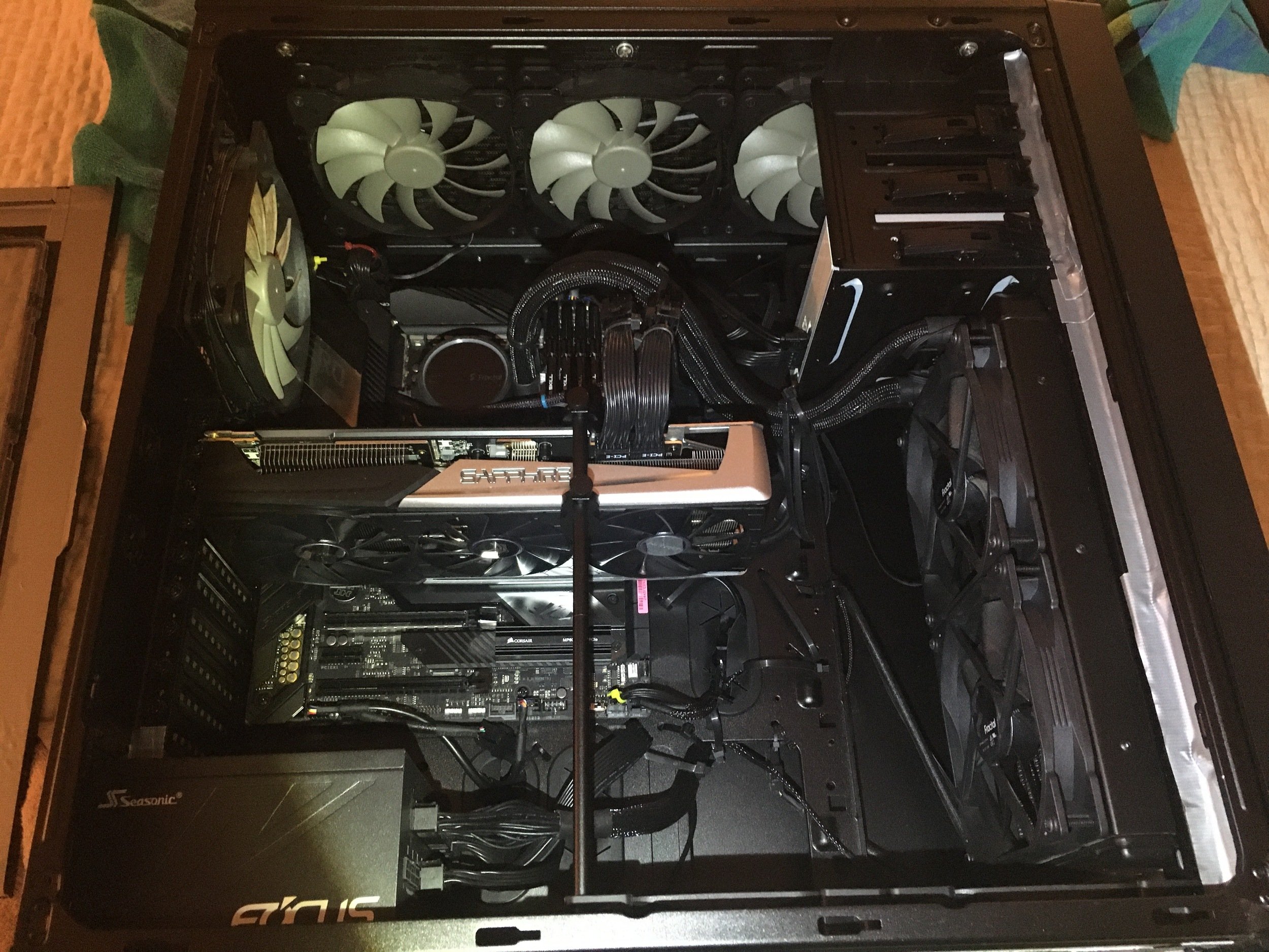

Full inside pic:
29964

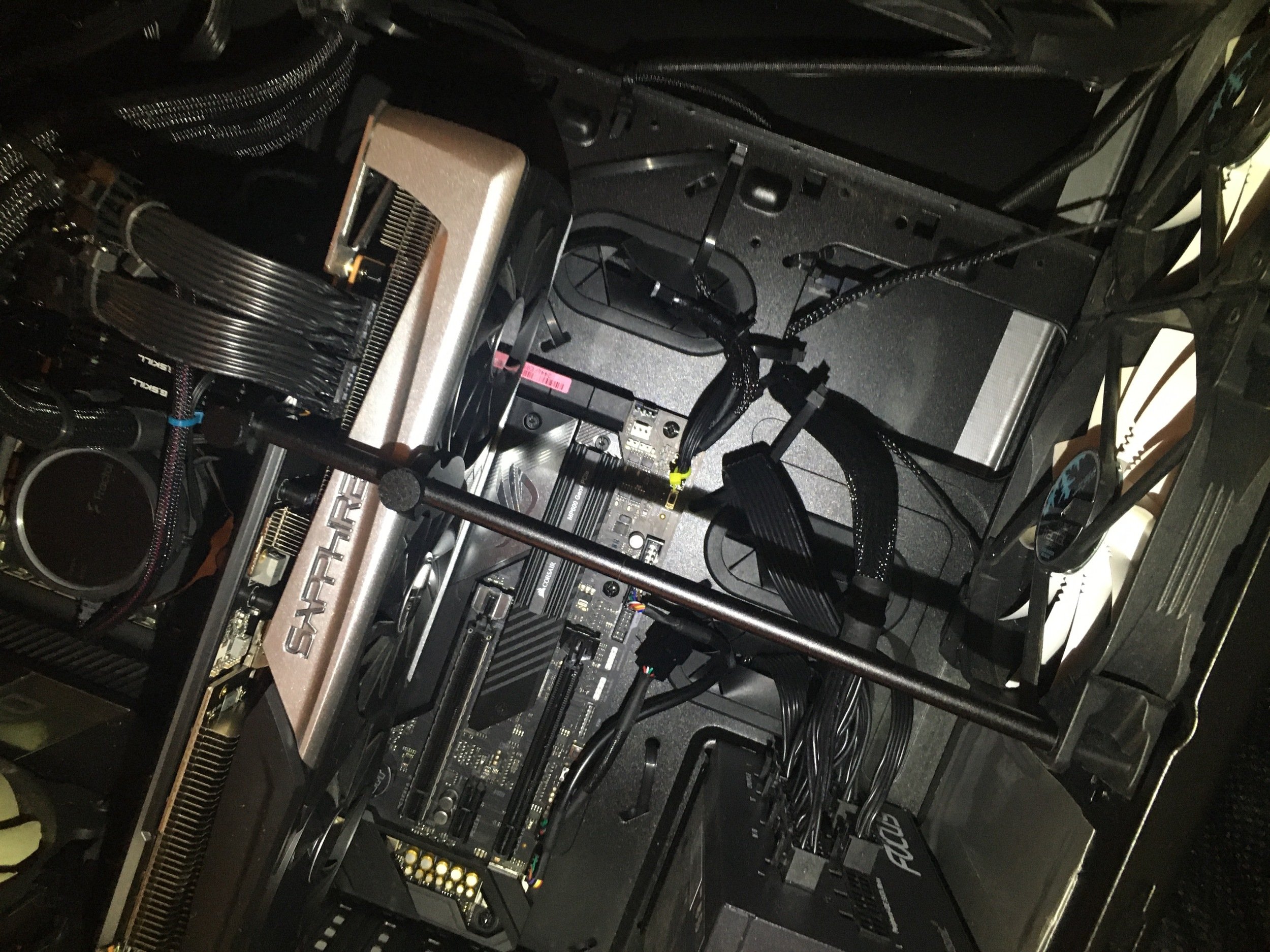

Check out the bottom of my GPU brace lol:
29965
29966

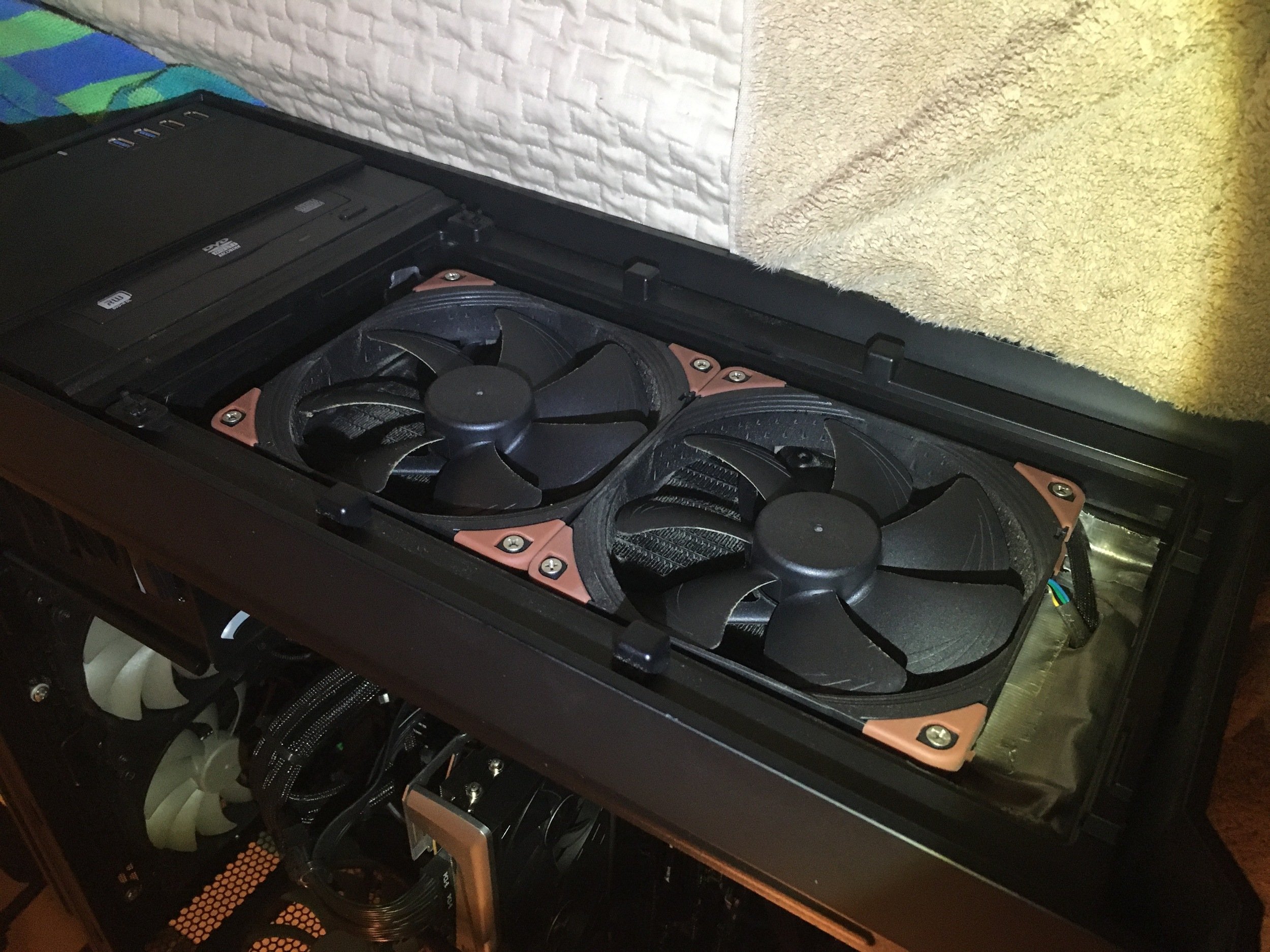

These Nocturna fans are screamers dude. I honestly wouldn't recommend them for a computer that's close to you. They have significant electrical motor noise, although I'm not sure if they're designed to be right in front of the radiator like that. They are .55 amp fans a piece and are 140 mm that will do 3000 RPM, so they're beefcakes:
29967
29968
It's so tempting to throw a 420 mm GPU rad on the top. It would totally fit haha
I've just been getting my GPU a little hotter, so I thought I'd go ahead and see how cool I could make it. I'm at 870mv @ 1125 GPU Mhz minimum for the processor, and it's a few degrees below 50C. I'm averaging about 8 FPS higher overall, from the last week I've been playing. That's 52 fps to 60 fps. Cities artificially limits FPS really low seemingly, so I'm forcing FPS by slowly upping the processing rate and voltage. I have no idea what I'm doing, I've never done this before.
I read that there is a greater chance of getting air bubbles to the pump if the radiator is installed tubes up or if the pump is higher than the tubes at the radiator so i installed my tubes in the down orientation so any air in the radiator would be at the top away from the tubes.
