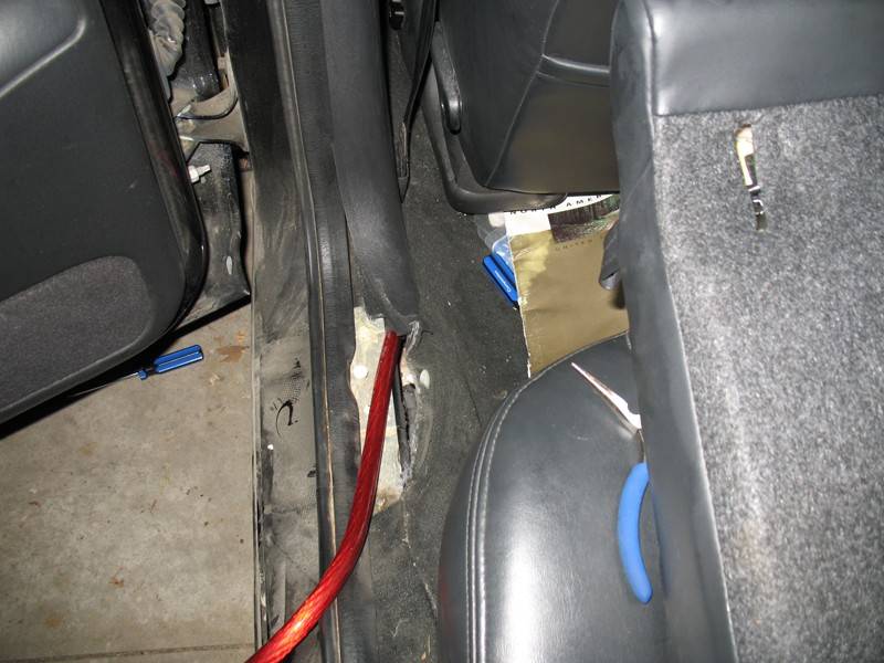

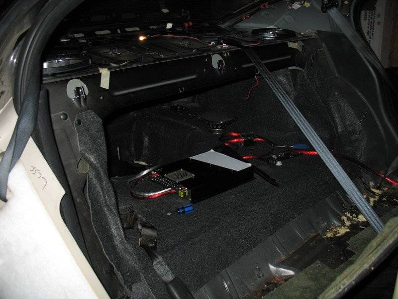

- 0 gauge run, (CLEAN) attached to distro block in back, connected to amp.
- Ground from amp to chassis hooked up

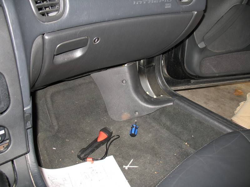

- stock amp removed

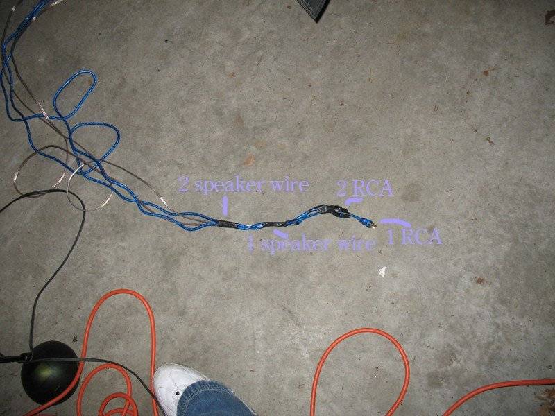

- front speaker wires from stock amp spliced to speaker wire and run to back

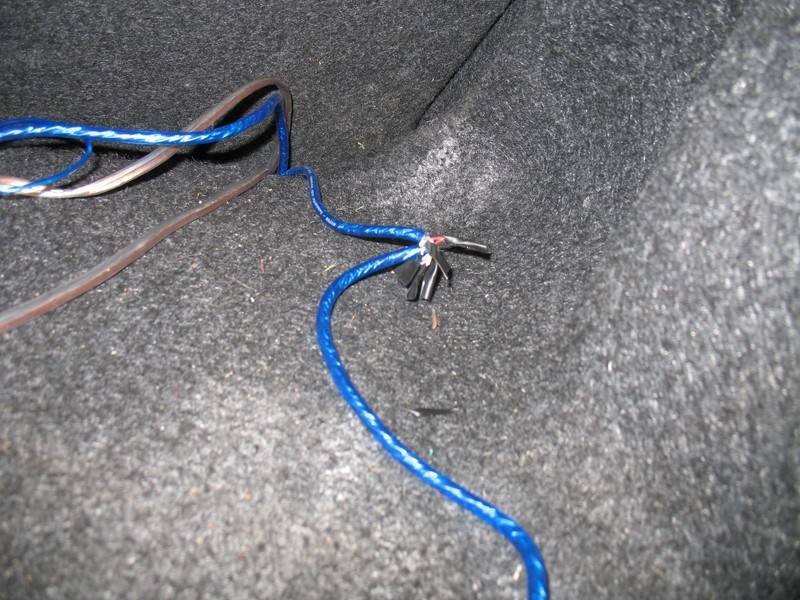

- RCA cable fixed when I pulled too hard and it snapped insides of sheathing (let's hope it's fixed at least)

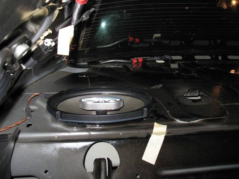

- 6x9s installed (including crossovers)
- speaker wire attached to 6x9s
- all speaker wires and RCAs attached to amp

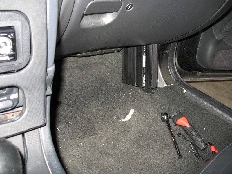

Kickpanel for stock amp (this is mostly for the dodge intrepid ppl who need to know where this is):

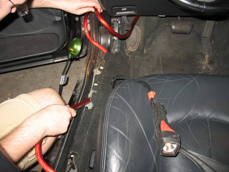

0 Gauge run from battery to back:

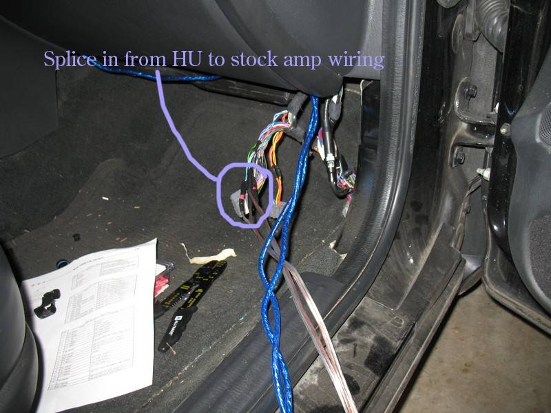

Re-wire from the stock plug to speaker wire for the front stage:
My wiring idea to be able to thread the wires easier under the carpet:
Replacing the 6x9s:
