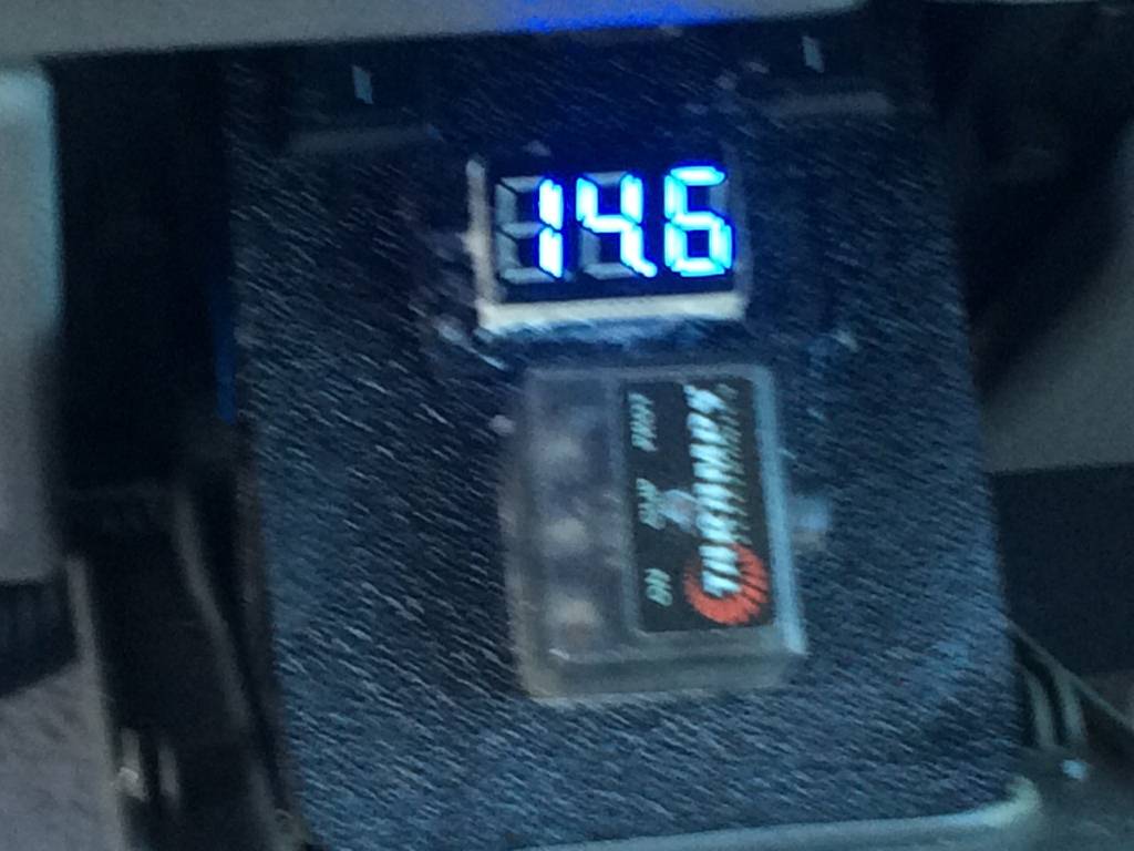

And there even better than I thought, last night I only drove down the road and it probably wasnt enough to charge everything up because today I drove to a job 4 hrs away and I never saw 12s at all only 13s and 14s so I am really happy ! cant wait to add another bank !

glad to hear you're seeing such great results. they seem to really shine with brazilian amps too. when you push them harder i bet you will see drop more towards 12s with a soft clip but thats some serious draw. on rock music and punchy base i bet you see the best results, i couldnt stand the 2-3v instantaneous drop id get without the caps
you may have answered this, but those voltages are at the amplifier input terminals right?
It's at the battery bank on bus bar but I have another lead that was on my smart voltage meter to kill power to amps on
low- over power and I have it out cuz I was having a problem with it but anyways it's source was at the triple input on the amp and I could swap it very easily on the terminal block to see if there is any difference? But where it's at now says same as meter on amp says ? Also ordered another set of caps today also lol ! I will keep adding till it stays at 14 volts ha ha
