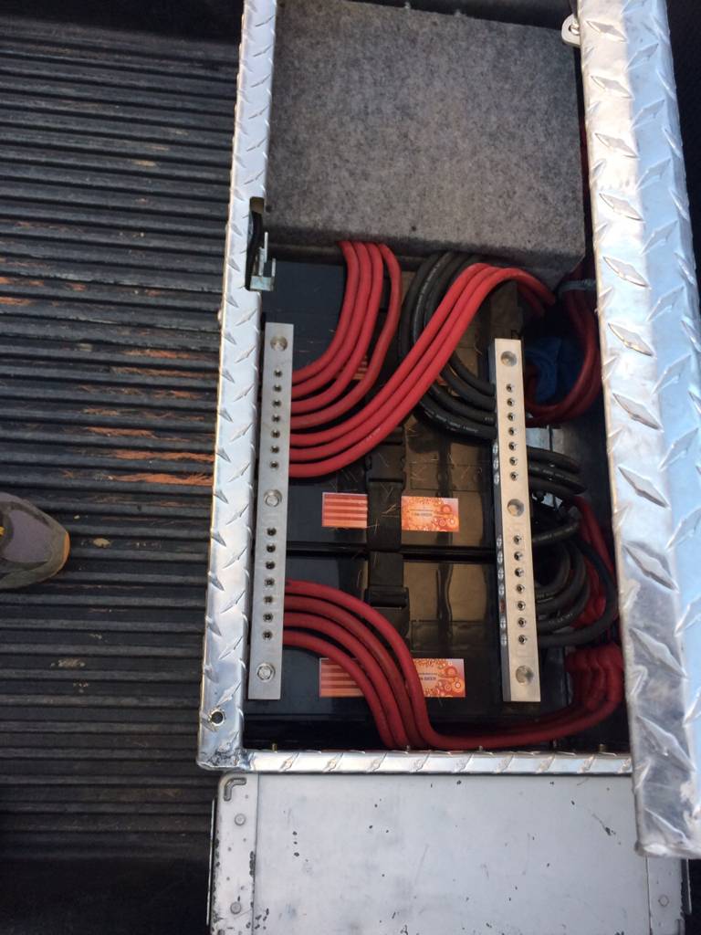

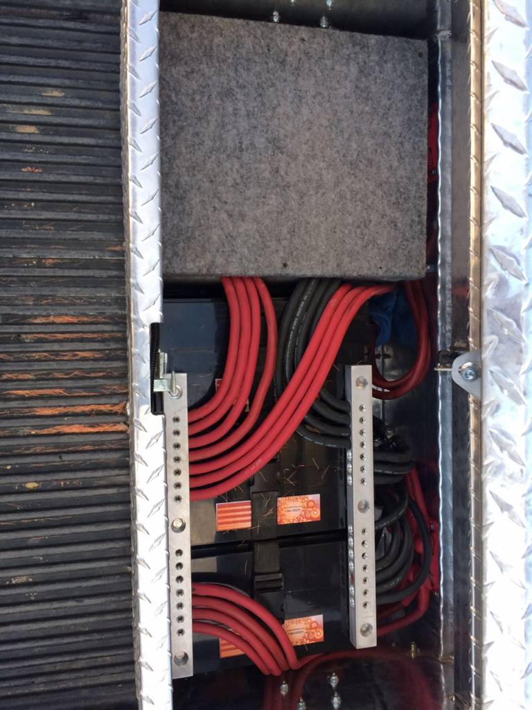

View attachment 26556562View attachment 26556561Worked on relocating batteries and making room for the four banks of caps and cleaning up wiring and adding the buss bars for the three batteries I am keeping. I only got to work on it till noon and it was 111 out side and said screw it and went inside. I pretty much got it all done except for making the box to hold the Caps and I will try to get it built this evening when it cools down.
that looks pretty clean, i like it. lots of caps lol im interested to see where your voltage drop will be!

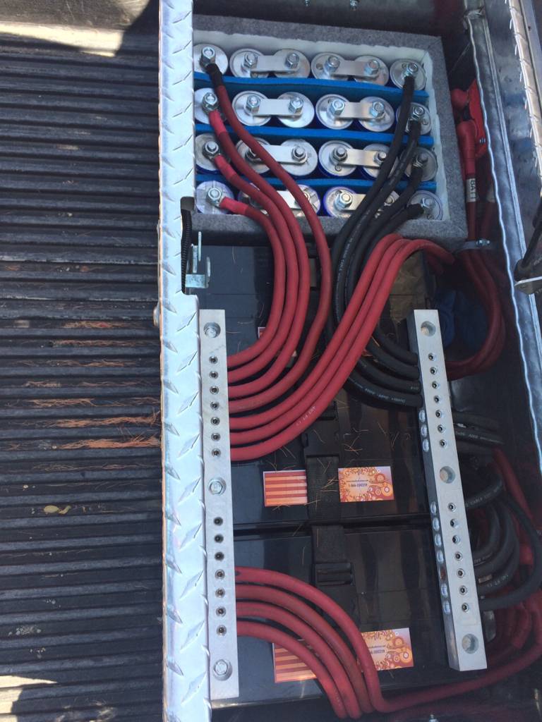

View attachment 26556592View attachment 26556595View attachment 26556594View attachment 26556593View attachment 26556596View attachment 26556597
Finally got the caps installed today. I had a little trouble charging the brand new caps in two banks up as these things are crazy, they have so little internal resistance charger will see them as a direct short and not charge them up. As long as they have even a smiggen of residual voltage in them they will charge right up. And let me tell you these things surge to charge or discharge with authority, You think a batery with a direct short sparks , but wait till you see these things !I had some extra long threaded studs for my buss bars and stuck them in so I could the bump the positive cable to them just to give them a little voltage and not arc up my buss bars and the light show is pretty intense ! LOL fried the ends studs off big time arc welder! But it did the trick and they got enough voltage in them to charge up, Thanks @wew lad. I have not had ant time to go test drive it but just sitting in the drive way and volume at 56 its not even moving off 14.2. I do expect a little drop especially with these ebay alternators. Next up fixing my singer alts and get them back in. I just got voltage regulators in the mail, just need time to work on them.

Finished up the top for box caps are in an tiddied up wireing and I am happy with it now.
