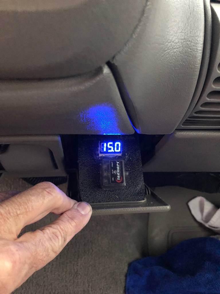

That's something I've heavily considered, you just ran the single wire up to the switch in your dash? Shouldn't be a ground needed. Any pics of where you put it?
Ya I ran an ignition hot wire thru the switch and out to alt . I mounted switch and voltmeter and switch to turn voltmeter on and off at night when not needed along with the taramps clip light in my ashtray so it’s stealth mode sorta .
Can’t see the switches in this pick but they are above and to the right and left of voltmeter. I can get you s better pic tomorrow if you want?
that's more than good enough thanks!

I goes without saying but I wouldn’t turn the switch on and off with alts turning , be quite a power surge there and may be hard on regulators.

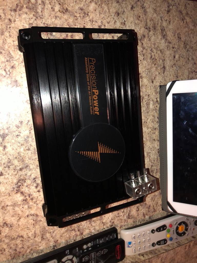

Yahoo ! I finally get drivers side midbass back ! Old one lost a channel got another one coming too my gf bought it for me for Christmas so I gotta wait to get the midbass Anarchy’s each pair there own ppi 900 bridged but can’t wait to hear it !

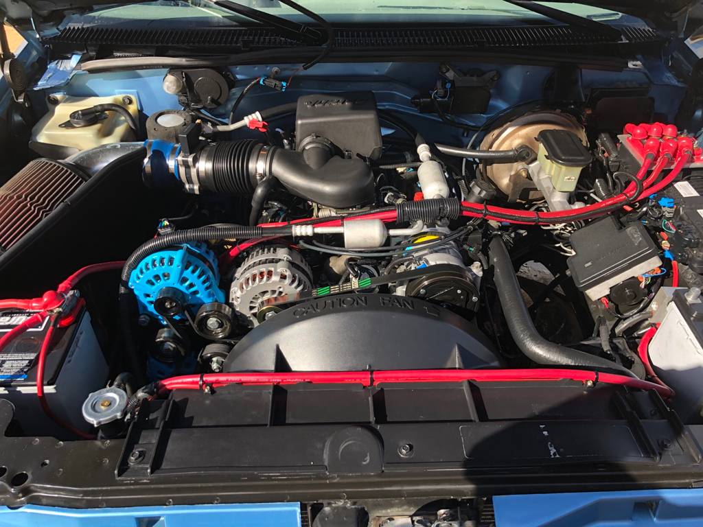

@ChaseinBass Got a brand new Interstate battery for the Tahoe yesterday. Optima finally went out....9.5 volts. Wouldn't hold a charge higher than that. Is there a battery tray that will fit in the same area that the storage container is in?
Ya their is. I got mine I think on eBay for about 30 bucks I want to think ? But if you take storage box out and look I am sure you can get a generic one at autozone or someplace like that and drill holes to fit for much cheaper? I think I felt dumb I didn’t do that when I got the Oem one lol !
Don’t forget the hold down clamp for battery too it’s about 5-10 bucks if you dont have any spares ? You may look at wrecking yard for these items too I just don’t have any near me.
see the two yellowtops in this pic
there's two factory available amounts for 99-06, depending on how similar your engine bay is it may be possible
His motor is same as mine
Don’t know if you can see battery’s in pic but too lazy to go take a better pic now lol
