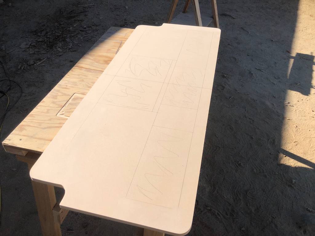

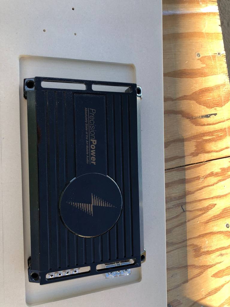

Started on my new amp board to make room for the two more PPI 900.4 and DSR1 and wiring .
But may be adding one more ppi 900.4 depending on if I need one bridged to my new mids and depending which mids I stick with and I am going to try these two to start with.

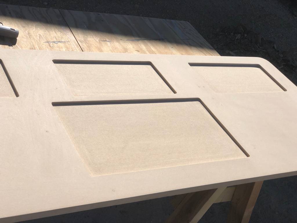

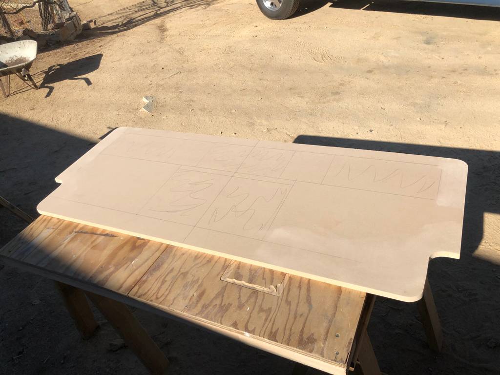

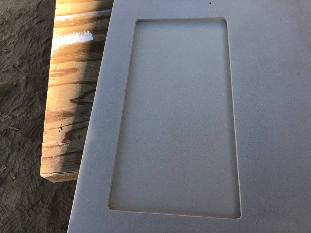

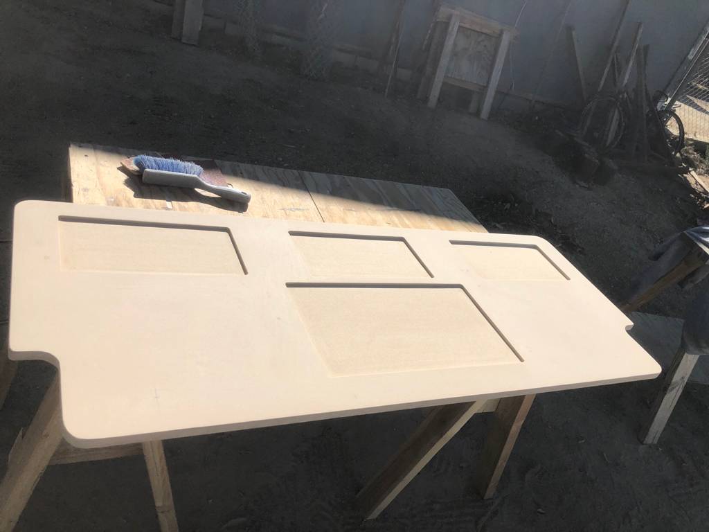

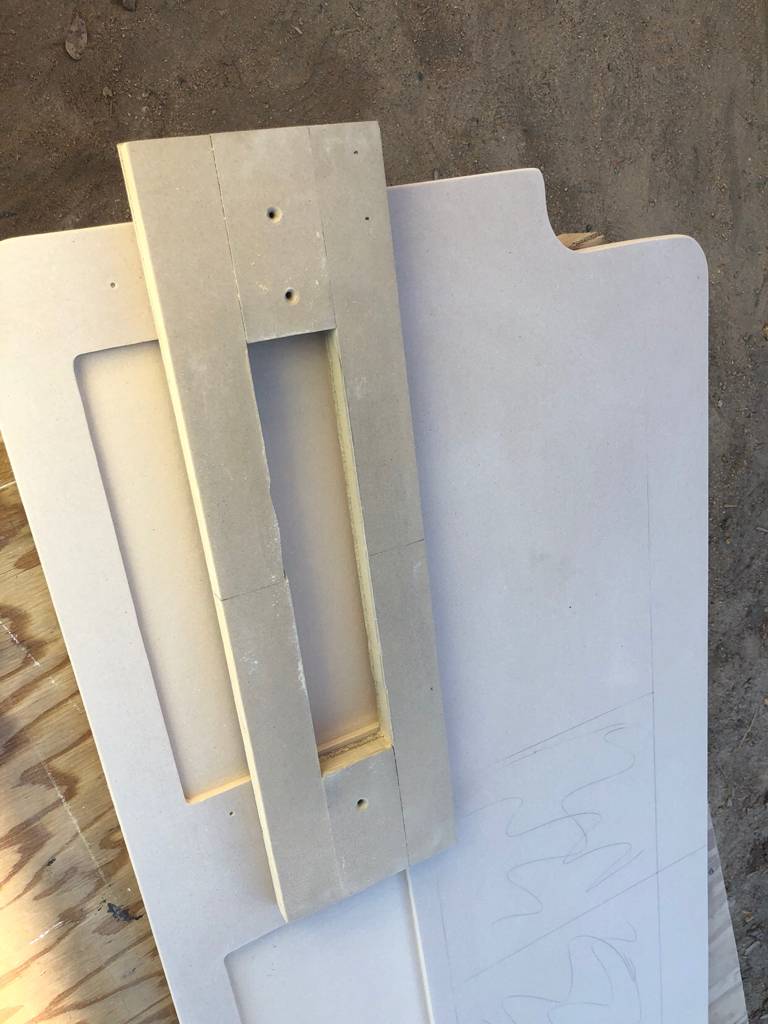

Got the mdf cut and built a bridge for my router so I could cut some pockets to recess the amps into it a little to clear my seat back and that took a lot of time and patience to get them cut out - and mdf lol ruined the first one ha ha !
Need to get some carpet to cover it with and start the wiring next. May add a pocket for Taramps on the bottom too just so it looks the same.

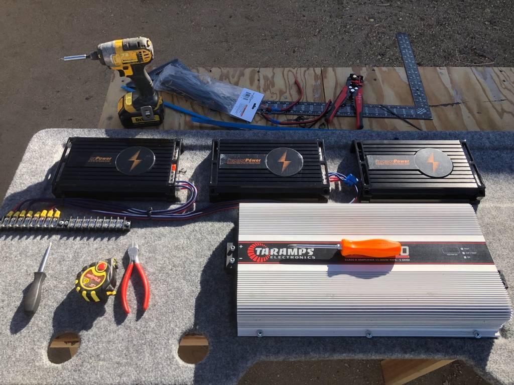

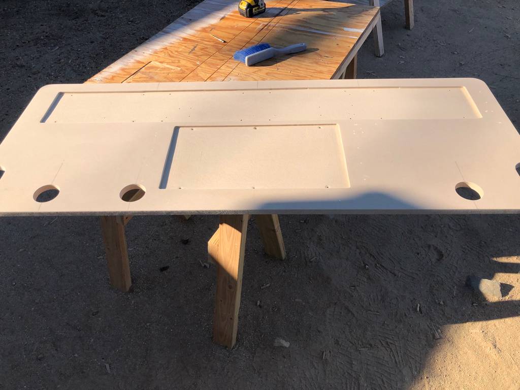

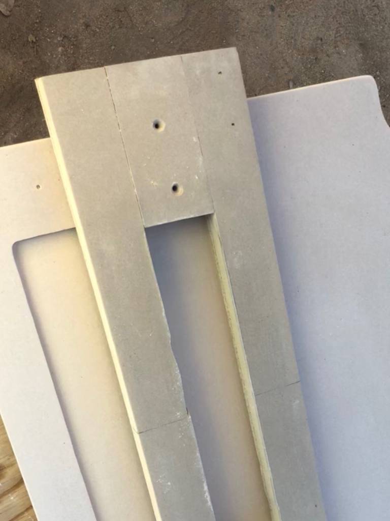

Got a little time to make another bridge so I could router the recess for my Taramps 15k to match the recesses for the 900.4s and got it cut out too and learned a lot doing it ? Seemed so simple when I started but wasn’t lol and I made a few mistakes and wasted some MDF but learned how to do it and came out perfect .
Also picked up some hurricane nuts and machine screws to remount amps more securely this time and got more carpet to cover it too.

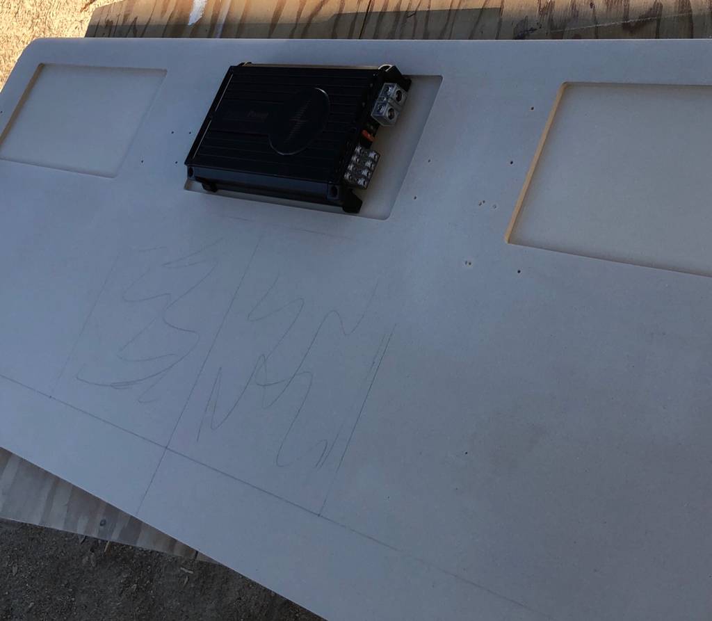

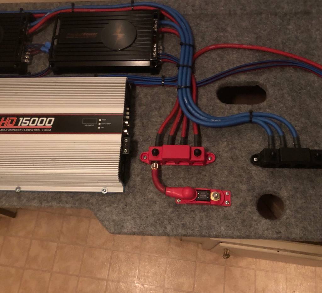

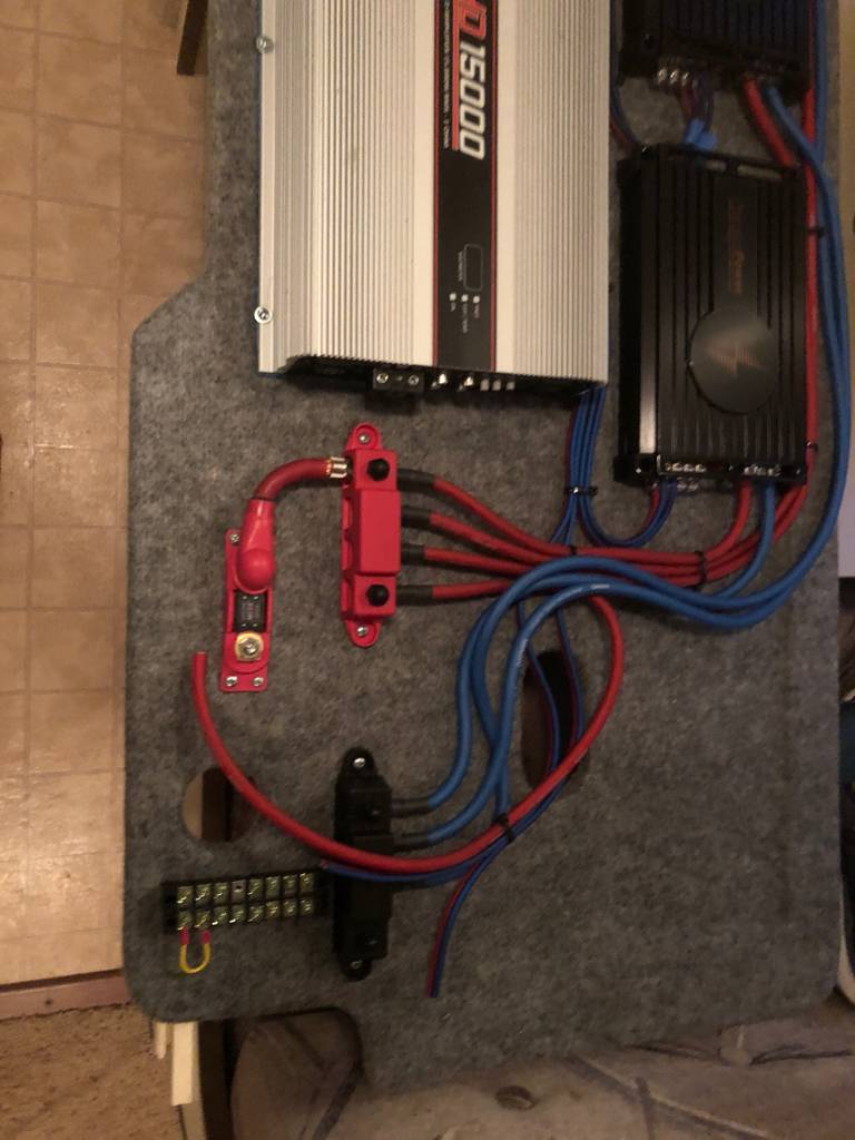

Update decided to use @Jeffdachef suggestion and run 4 ppi 900.4 and all four bridged into 2 channels, one for tweeters , one for mids , two for mid bass and should kick azz ! Ordered the last one today . There starting to get hard to find for some reason? I got the last two this supplier had .
Had to re router some room for 4th ppi 900.4 and get the thread inserts installed and got it covered with carpet and got another amp in the mail , waiting on one more amp ( Christmas present from my GF ) then I can finish it up. Got most of the wiring done and it’s looking pretty good so far ?

I really like those marine distros, they're a little pricier though right?
Heck no ! 7 bucks and stainless steel too. I get all my stuff from them top shelf quality and prices much cheaper than car audio.
Check them out 4 Point Terminal Busbar
