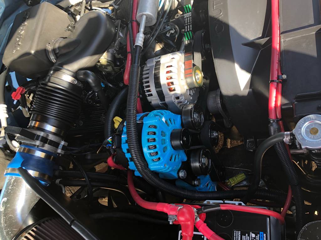

Got some pictures from Jonathan at CES and video of my two new hairpin 300 alts doing close to 310 amps max and close to 200 amps at idle on each and should really boost my voltage ! With the cheaper B&R 250 amp alts and three juice box group 31 s and 4 banks of ultra caps I am sitting around 14.4 driving and stays there until I get 3/4 volume in a bass heavy song and it will drop to mid to low 13s. I went with 300 amp alts because I will be changing to a limitless 60 ah lithium next and they recommended not going above 600 amps of alt. Should be here wed, can’t wait to get them installed and 0 gauge grounds ran to each and swap a 250 amp to stock location to run the truck.

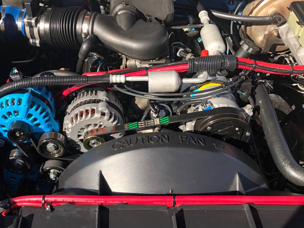

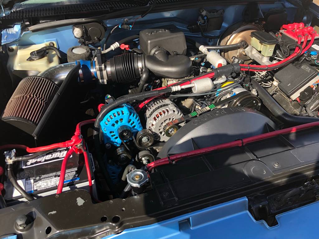

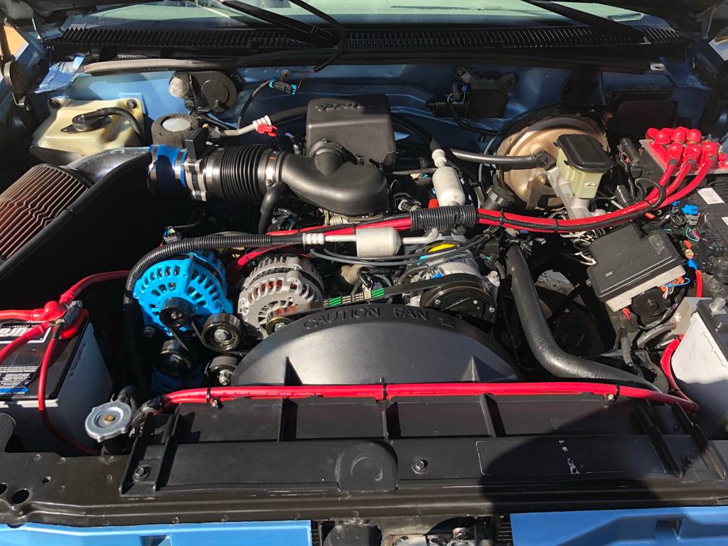

Got a new belt and tensioner on this morning and seems to have fixed the slipping and squealing on startup and decided to clean up my engine too because it was discussing lol looks good again at least for a 22 year old truck with 250 k on it anyways .
I've only had belt slip with an old belt, what you experienced is expected. replace the serp every few years and you wont have a problem. takes about half an hour to an hour if you have multiple alts and its only $30-$40. ac belt should also be changed when you hear slip and you're unsure
Even if there's no cracks?
**** looks dam good and clean!! And dam....had the same idea as me or I got it from you who knows, about running bigger wire over the fan shroud and drilling holes for zip tieing it in place, I did the same with mine.

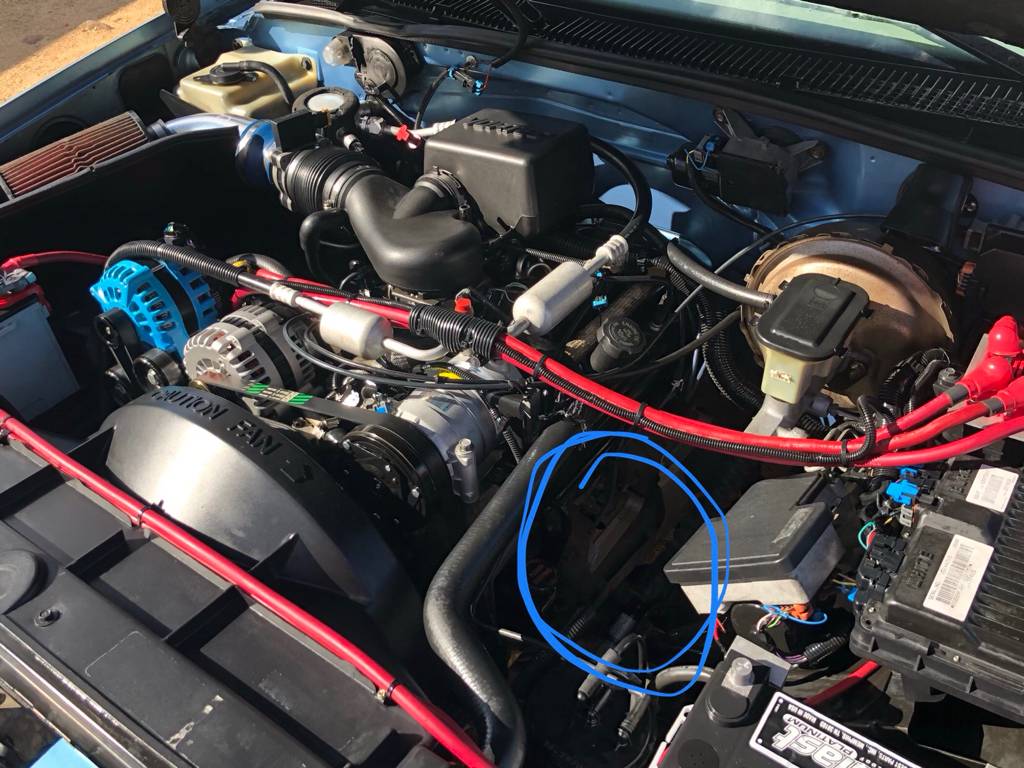

I am getting ready to redo all the Under hood wiring and moving fuses off the fuse box and make a bracket and move over and lower below the antilock brake equipment and above the steering shaft and redo that mess all hooked up to poss+ and neg- main battery going to get a set of these battery terminals
https://jims-machineworkx.myshopify.com/collections/battery-terminals/products/sae-top-post-lug-type-1-0
I want it to look a little cleaner.
Forgot the pic of where I want to move fuses
