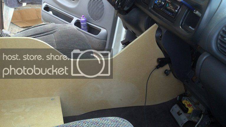

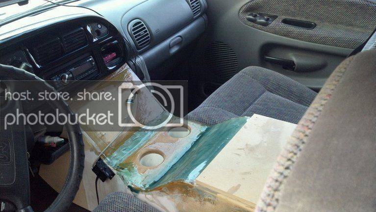

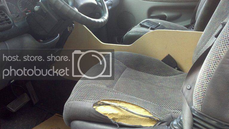

That's not too difficult to do. Just mock up the sides with some cardboard, get some fiberglass, kitty hair and bondo and get to building. I did one in my truck that was flat on the sides but was molded with a storage compartment on top, cupholders in the middle, a place for my tablet up front and battery storage below. It was formed to fit the dash so it would have looked pretty nice had I been able to finish it.
Here are a few pics of it being built:
And this is as close to finished it got before the truck was stolen and it was damaged by the thieves...

Wow thats a nice build. Ill try to find some card board and mock something up
That's beyond awesome. I'm in the exact same boat, just a different truck. I'm wanting to build a console box for my Dodge Ram. I have less space but I can have my sub(s) fire down. Good thing is, I want SunDown Audio subs (10") so I can get away with a small enclosure. I'm seriously going to look into building a console like this though but including the sub box. AWESOME!
