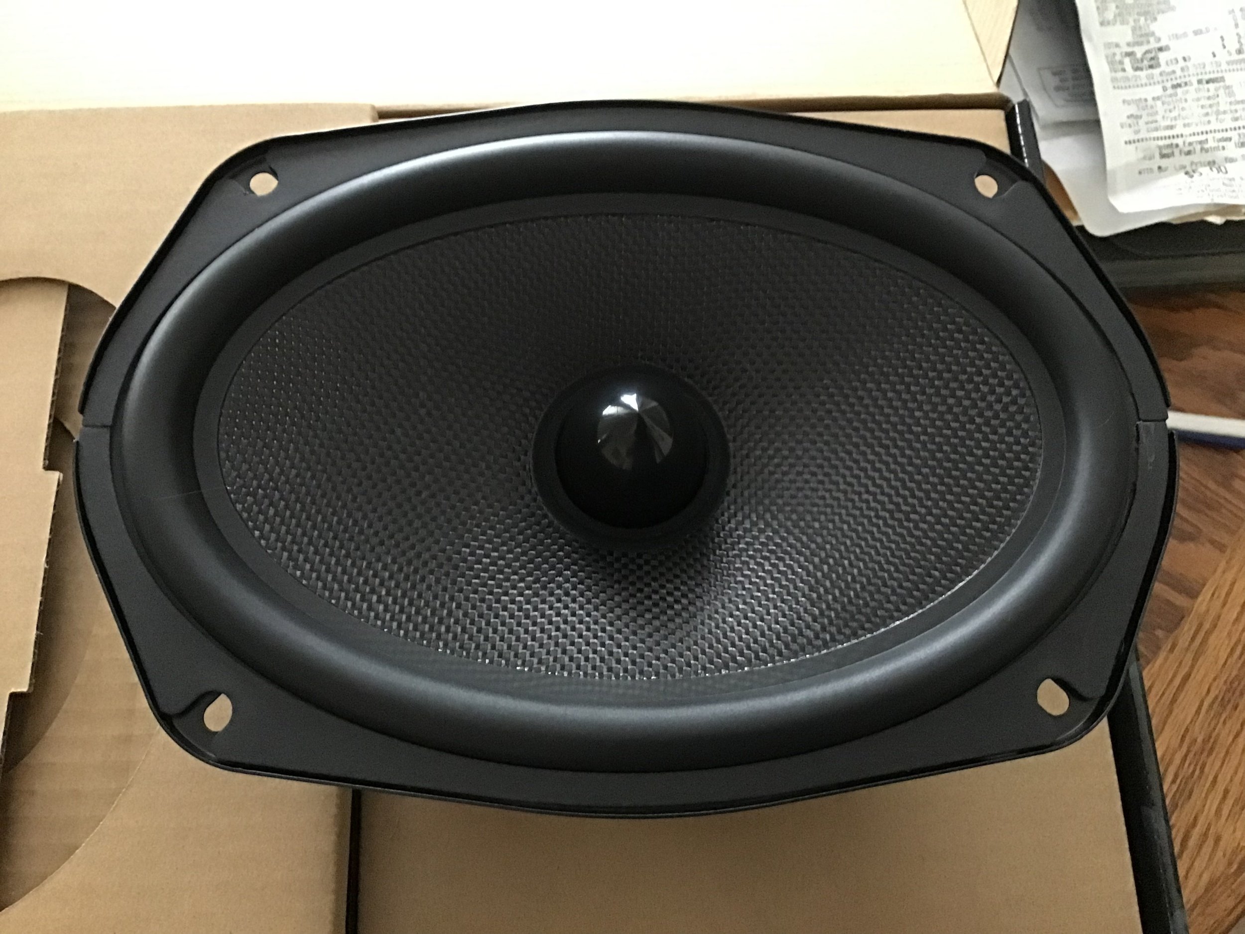

These play from 30htz-3500. Little pricey maybe.. But Carbon fiber cone.and should last
https://www.woofersetc.com/p-10163-es-0690-gold-cdt-audio-6x9-2-way-extended-mid-bass-speakers.html

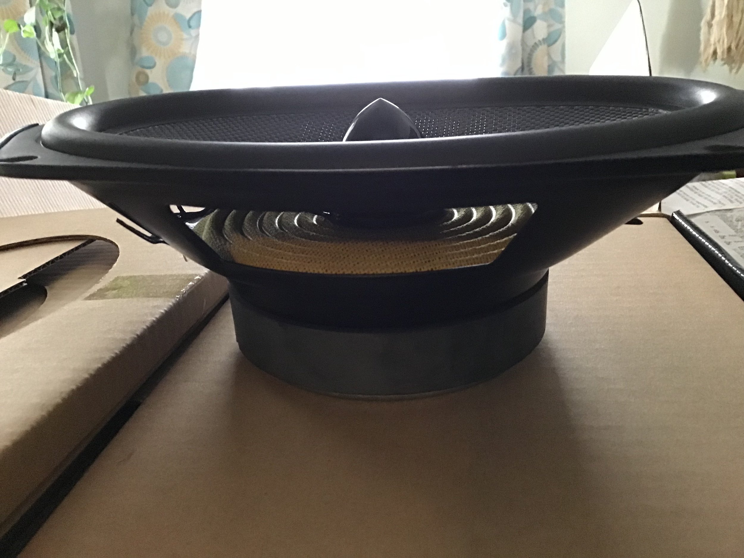

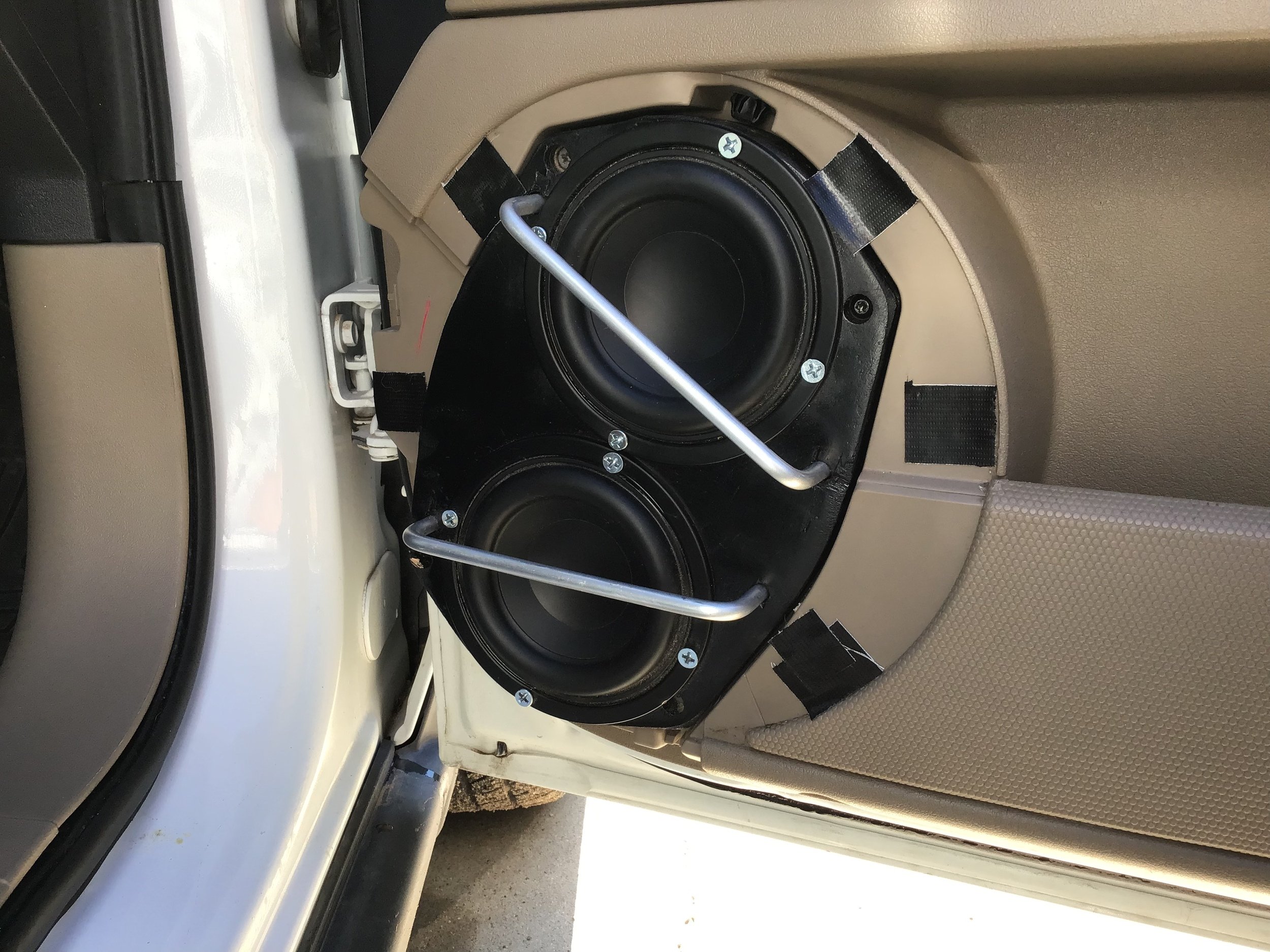

I looked at these but i have a 4 channel amp that puts its power out at 2 ohms. I could only feed them with around 80 watts. I’m really limited with my choices running this amp. I could get a tiny 2 channel for my tweeters and bridge the 4 channel and get 200 rms x 2 @ 4 ohms. That’s my next step if these 6x9s aren’t to my liking. I’m playing them free air a little now and they seem nice. Kinda surprised that a 6x9 with no tweeter can play up to 7000 hz but it does. These should keep me happy for a few months at least. Right now I’m running dual 4 ohm woofers in the 6x9 spot and they can’t even play up to 7000 hz. They drop off at around 5500 hz. Probably doesn’t matter really, since I will be crossed over at between 3000-4500.
I’m replacing these 4 inch woofers, so I’m expecting a noticeable jump in the midbass under 500hz or so. I should also be able to put the stock speaker cover back on since the shallow mount on these CDT will allow it to fit. I’m still putting a 3/4 inch MDF ring in to mount the 6x9 to. These 4 inch woofers have a 1.5 inch spacer.
