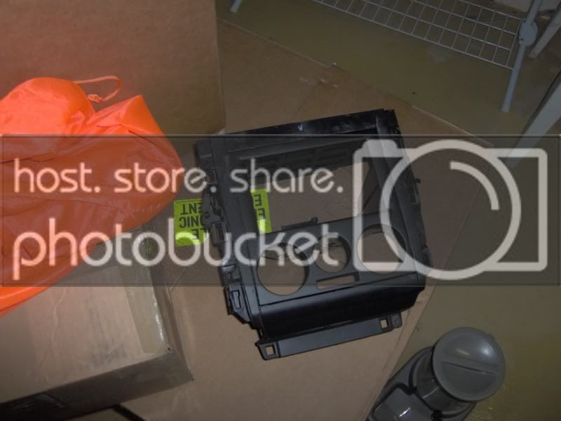

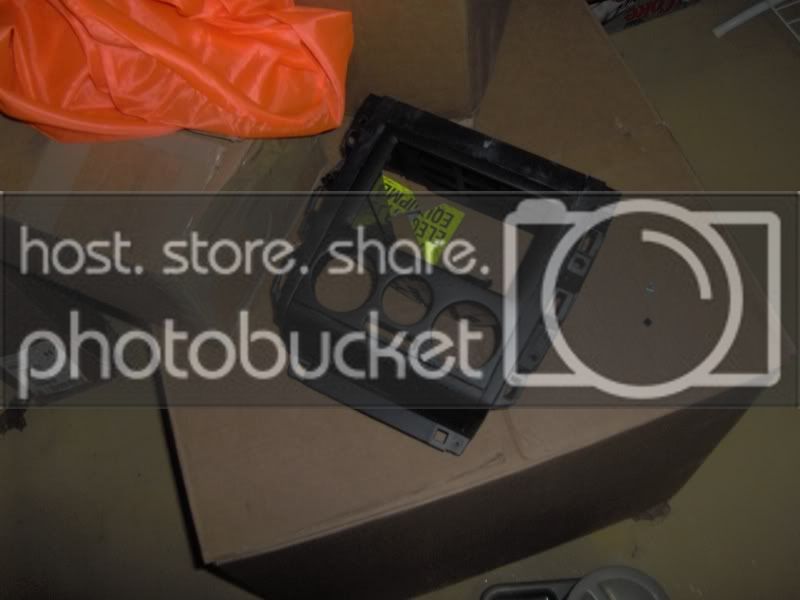

That thing has been hit with rage and 40-grit paper. The primer is just to help show me where I need to pay some more attention. I know it's nowhere ready for paint.

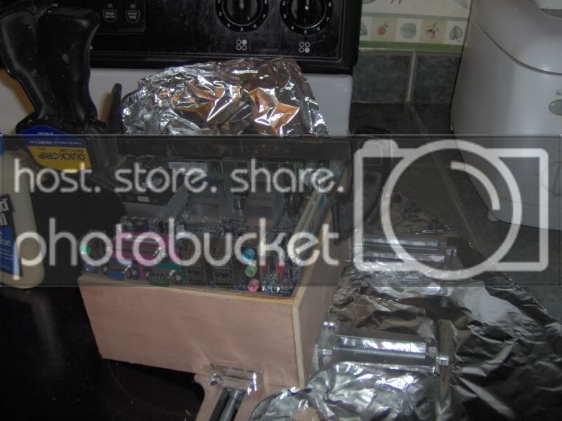

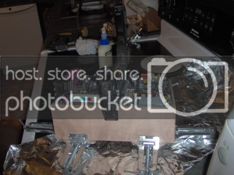

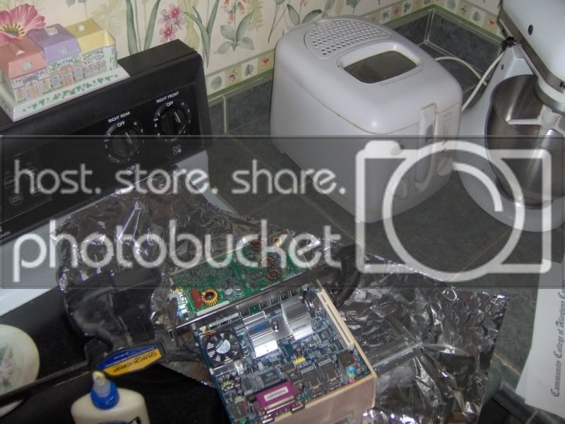

I'm sure you guys will like these pics for sure =)
There's a couple pinholes that need addressed - you just can't see 'cause the lighting sucks.
The box measures 10 3/8" long, 3-3.5" high, and 6.75 deep:
