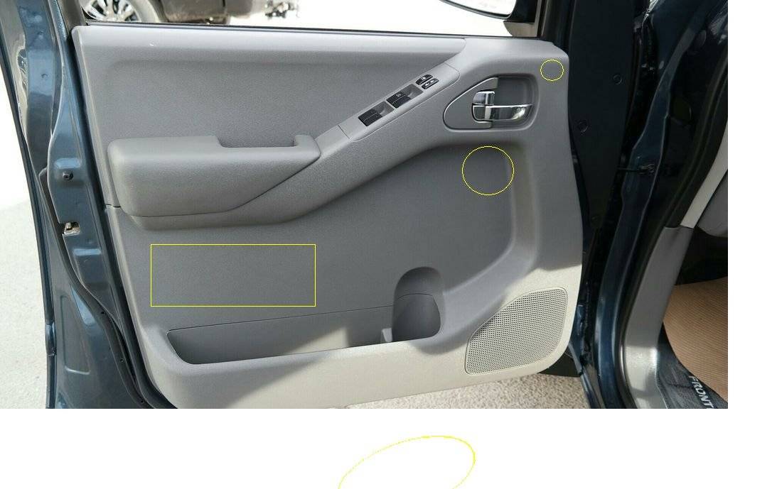

The problem with adding the GB25's into the mix is where to put them...Running a 5.1 I've read that I'll want to have them (mids and tweets) high in the door panels to widen the sound stage and reinforce the center speaker. This means going with pods of some sort or finding some real estate on the door panels...hmmmm.
I do have room in my upper door panel for the mids...however the tweets my have to go in the pilar.....they may be about 1ft apart...which isn't ideal. The GB25's would be just above knee height on the door and on-axis with the midbass drivers.
I could make some sort of pod just under the door handle area and maybe tuck the tweeter up top...if not then there's always the A-pilar. I could probably get tricky and mount the gigantic passive crossovers to the doors too with the plexi window exposed....
Well...that won't work...just ran out to my truck and the tweeter location I marked is totally covered when the door is closed...
...and this all makes me wonder if it's worth the pain in the a$$ to go 5.1. Once I start thinking about cutting into doors and custom mounting x-overs it kinda makes me want to go simple again...I have a pair of Morel Supremo Piccolo's that will fit in the dash location...I can pick up a nice set of 6.5's and run a single sub off one of my 900/5's...small and simple.
