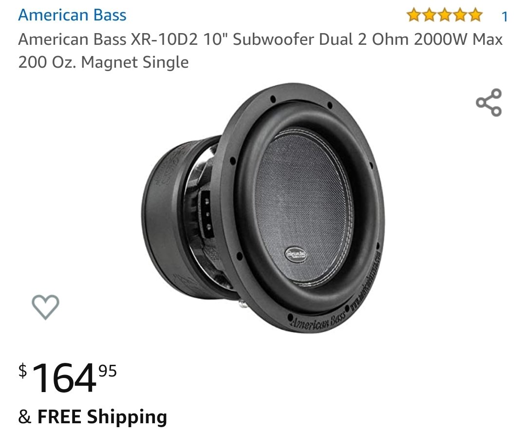

If you want real sound.
AbVFL65MB- $
Dayton tweeters AN25f-4
XR 10d2
MD1800 one ohm
TS440x4
Custom ported box

It sounds like he doesn't want hair standing Bass. A single VFL8D4 or XR10d2 would suffice. Or, one XFL1222 would be best.
Yeah, worth mentioning I think the MD1800 is overkill although the price is right. I'm not the largest fan of American Bass, but something in the 400W-1000W range is plenty depending on the enclosure. 400 for ported, 1000W for sealed. I'm also not a huge fan of the, "everything this brand does is good" mentality but those two lines from focal/hertz come highly recommended as the best mids used in complex audiophile crossover systems as evidenced around the internet. I plan on getting a set of either, but can't make up my mind. Will probably depend on the amps at my disposal at the time.
