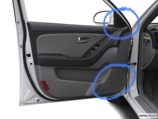

Yes, there is a separate tweeter on the front door and 6.5“ Speaker down low 37497BAD-BD64-4D9F-BF80-A635D8C375E2.jpeg

Yes, there is a separate tweeter on the front door and 6.5“ Speaker down lowView attachment 21880
If you'd like to continue using the car tweeters or at least tweeters in that spot then you may be able to get away with a non-full range mid like the hertz woofers I linked earlier for the front doors. That would require a beefier amp, but they are quite nice in the mid range. I'm not sure if your tweeters will match the size of any component sets, but if so that would be a great replacement for all 4 front speakers at once.
