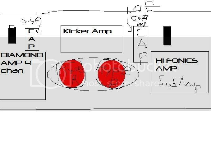

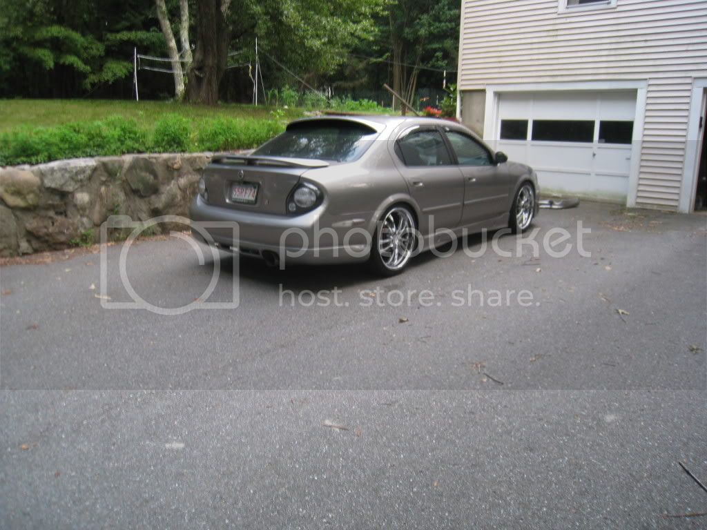

my 20s are fine with 3 amps, 2 subs, and a box in my trunk...
my system:
so you dont have no problems with weight

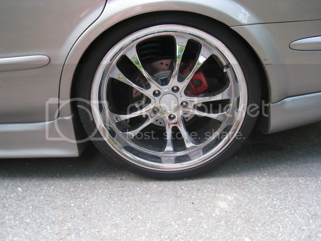

I went from factory 15" wheels to MUCH wider 20" wheels with 225/35 tires in the front and 245/35 tires in the rear. I added a considerable amount of weight (+20lbs per corner), but really only noticed the excess on quick stops at highway speeds. I went from 27-28mpg to 24-25mpg.
Very true. Though it's hard to get the exact same, so you should focus to get a combo that will be within 3%, I try to do within 1%. My stocks were 215/55/17 and my 20's when I had them on were 245/35/20.
Here is a good calculator. Even changing the width of the tire will make a difference, it's not just the rim size or the profile of the tire. http://www.1010tires.com/tiresizecalculator.asp
That's alot of weight. Your cars rear end will sag for sure. Get coiliovers, not springs, because springs settle. Also here is something else to think about. When you get 20's, your camber is going to change and so will the toe. I went back to stock wheels because my camber was off, it was -2.0 degrees in the rear and -2.5 in the front. It should be no more than -1.0 so that you don't deal with too much inner tire wear.
If you have a bad camber, you will have to invest in a camber kit which can cost anywhere from 200 - 550 bucks for the pair without install and new alignment. And in order to know whether you need a camber kit for either the front or rear, you need alignment. Wish I knew all this stuff before I purchased 20's, I regret getting mine, in fact, I'm selling them.
