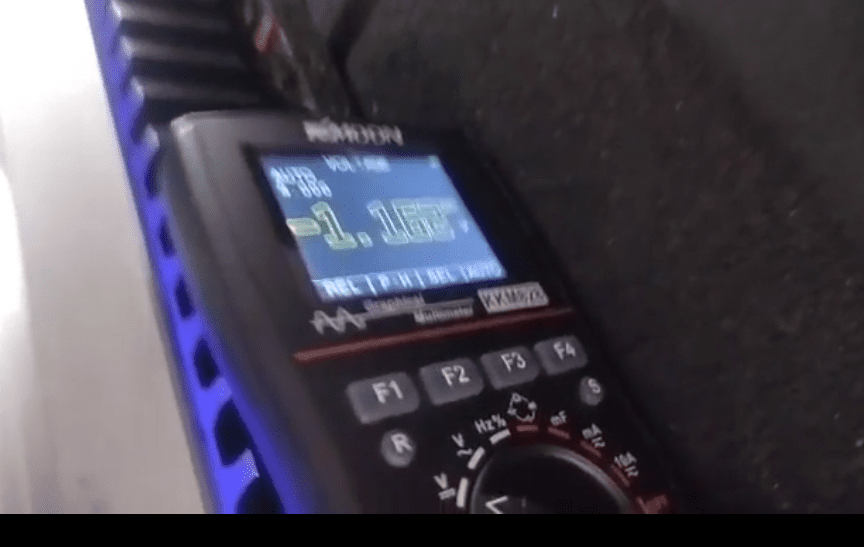

Below in the photo you can see the tension on the music play, tension on amplifier ground, in peace is about 0,5v, on music jumps from 0,050v to 1,4v. Reading from: GROUND TERMINAL AMP AND BODY AMP (SCREW)
