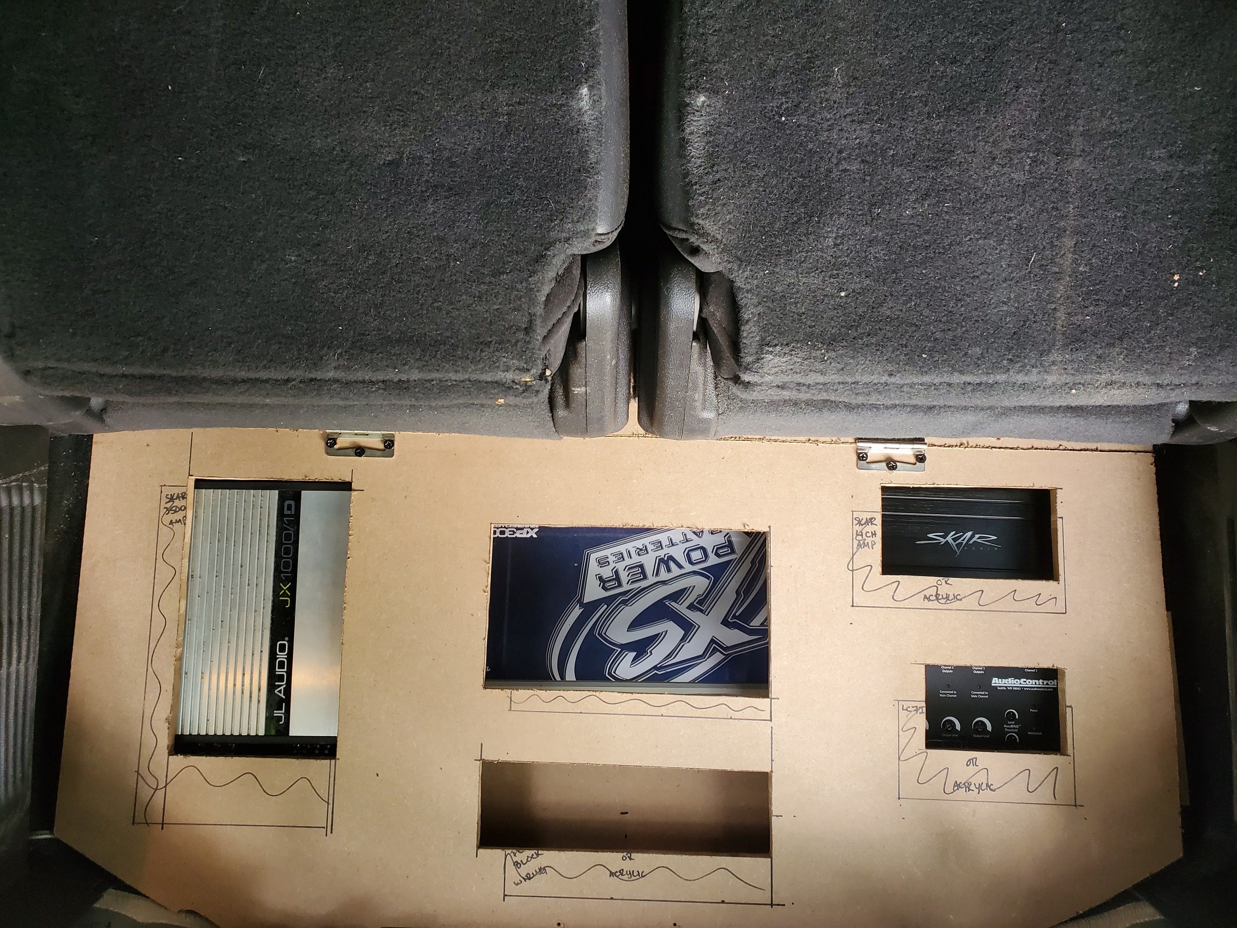

Should have the LEDs glued in place and carpeted today, and possibly cut the acrylic for the windows. Probably have to wait till next weekend to wire everything but it should be done by then I hope.

Here a slight mock up, yes its crooked because it's just placed in there, but theres a floor to hold the battery and electronics and wiring and everything. The jl amp is being replaced with a new skar amp, the battery will be turned around so the logo is upright. I made this top tray with hinges and there are risers so theres a .5inch gap between the board and the electronics due to weight. I needed a "cover" because I will still need to use this cargo area for stroller or groceries or anything else and be able to hold the weight efficiently while still maintaining the use of the 3rd row. I just hope it all looks alright when complete next weekend.
Looks good, you've put a lot of thought into it.
