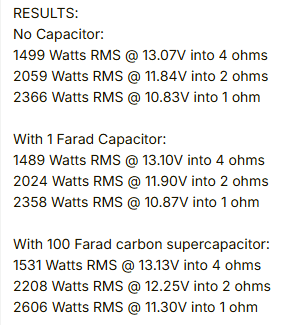

Before you drop any money, look at some real-world reviews and tests of caps in that range.
Preferably reviews and tests by people who don't stand to make money off of you purchasing one (through affiliate links, etc)
For example, one test done with an amp dyno found this:
Kyle,
In case you don't know what is being shown, this shows that the more reliable the power source, the more power your amp will generate. If you deplete the power of a cap, you will lose wattage because the car's alternator is now trying to power the amp and charge the cap at the same time. This is shown by looking at the wattage drop after installing the 1 farad capacitor, which was too small. This is why I recommended a large capacitor and battery near the amps.
