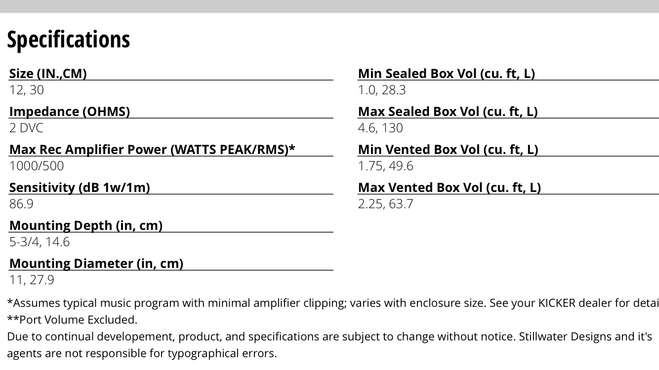

you bought a ported prefab box and a cheap kicker woofer. there really is no way for us to know what is going on. we dont know what the box is tuned to, what the settings are on the amp or the head unit. if you placement is causeing transfer problems or possibly some cancellation issues also the specs you gave us on the woofer are 1 wrong ad 2 useless.
what you need to find out is
1 the t/s parameters for the woofer
2 the box size and tune as well as how much port area you have.
3 configure your settings on the head unit. i use the head units crossovers and turn the amps xover off or usually turn it up to max..
4 set the subsonic to about 20-25 those pots(the knobs for the settings) sometimes aren't very accurate. I wouldn't even worry about it unless you hear bottoming..
5 list the car, music give us an idea of where the box is etc.
after being on the forums for 15 years im not just going to guess as to what kinda **** you got going on. its your responsibility to understand the basics..
I drive a 2016 Honda HRV EX I don't have xover settings on the head unit all I have is bass treble and fade the box is in the trunk (hatchback) no where can I find what my prefab is tuned too what I sent in the pic was the specs of the box I'll send the specs of the sub by it's self one sec
That is all the info I can find
K that's cool. ill do some digging and see if i can fine the parameters.. what is the exact model number of your subs? i didn't mean you had the wrong subs specs i meant kicker is full of ****.
are they the comp VRs? the comp Rs?
Nope just compr not the 2016 new models
