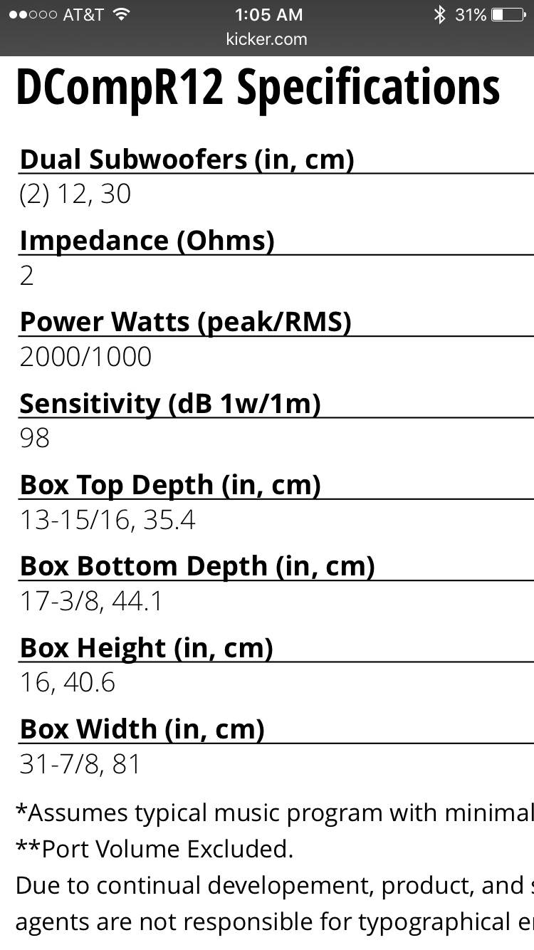

I'm really looking for advice... (now before you judge I got these as a set for a gift I know kicker are not the best but I plan on upgrading someday) I currently have 2 12 Kicker CompR 800 rms powered by a Lanzar 3k watt amp I also have the DD-1, my question is when I set my LPF on my amp to 80 my SS is at 24 and bass boost is off no matter where I turn the gain to it never shows it distorts but if I turn the LPF to 90 it finally shows up but all the way up and you can tell it's to much gain.. what should I do?? I'm confused and would love deeper bass that really hits and I know everyone says put the LPF at 80 to have deep bass but I still can't get it. My power wires are 1/0 gauge the only 4 gauge wires are the ones to the subs till I can order more 1/0 wire. Please help and thank you
is all of the specs I can find the subs came in a kicker ported box
Is your enclosure ported? Sealed? And is it prefab?

Edit: n/m I cannot find what tuning that loaded speaker box is...chances are it's tuned pretty high....maybe 38Hz.

Most prefabs are tuned to like 40hz... u can go on eBay and buy some prefabs that are decent and tuned to 32hz which is lower... if u really wanna slam them lows tune to 25hz
Tuning to low can hurt lowend output. The larger box/port helps tge alignment peak harder at tuning.. The lower the tune the larger the box/port you need..
