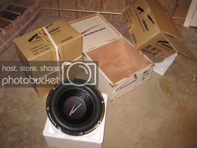

Can you believe? I have a set of BRAND NEW Audiobahn AW1200X woofers still in crate !

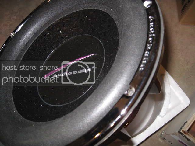

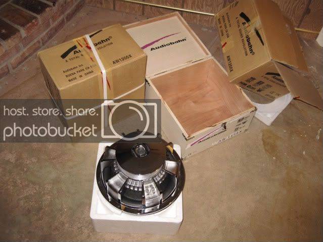

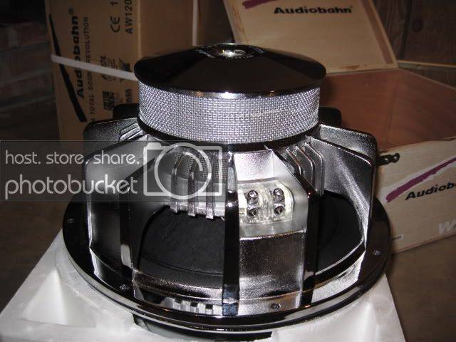

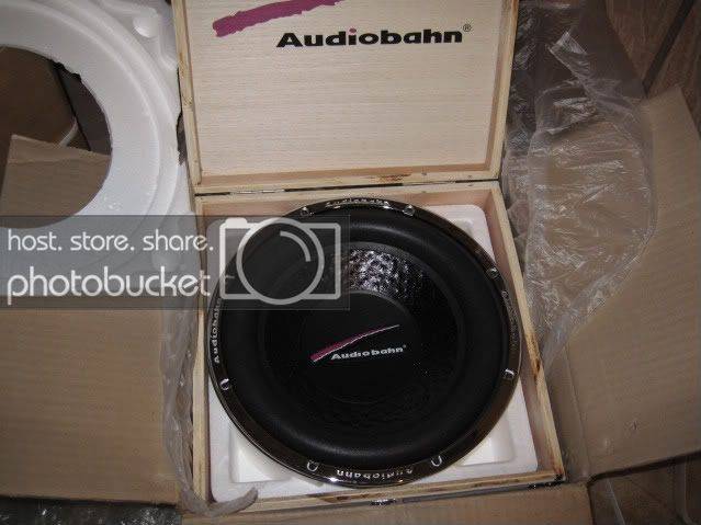

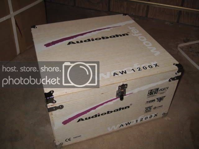

Pix of the Audiobanhs or its lies.
Pics will be coming up before end of today.. in the meantime, can someone help and mock up a box for me using one of those fancy programs so I can know how loud these subs will play... etc.
