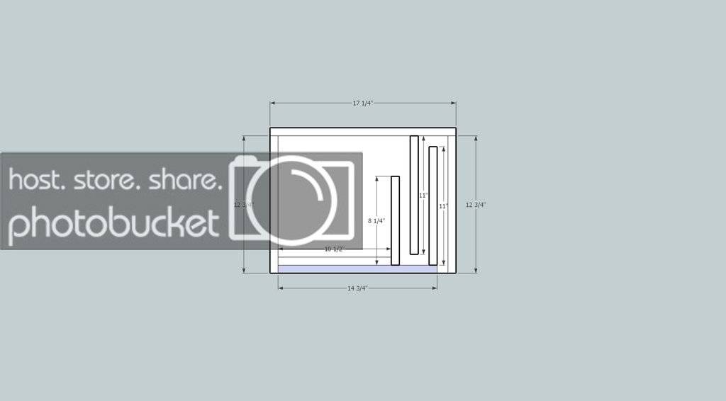

can someone design me a box for an e8?

well my e8 should be here mid of the week and i need a box design if someone could help me out id appreciate it. thanks.i looked in other threads and it looks like they recommend .60 cubic ft. so if someone could do .60 cft to 32hz.sub and port on same panel. thanks. //content.invisioncic.com/y282845/emoticons/smile.gif.1ebc41e1811405b213edfc4622c41e27.gif

Got some dimensions you want?
Rather have it wide? Or what?
And sub / port which way?
EDIT:: Wait... nevermind. Reading > Me. I'll PM it to you in a bit.

how much power are you going to put on it?
you can put it in about half that size box with enough power

are ya talking to me about the power and whatnot?
300RMS. and the box design modeled out pretty well with the e8.
i have a design for an E8, 1 cu ft @ 30hz, 27" wide, 10" tall, 12.5" deep.

cool thanks man. the amp i'm going to be using is rated at 500 at 4 ohm, so i dont know how much power i want to send to it. its rated at 200? so probably like 300. its going in my car temporarily, going to sell my stuff i have now so i can save up for new stuff this summer, and use this to get me by. and then after that ill prob pick up another one and stick it in my brothers car

put it in .3-.4 and give it 400-500
I didn't know what to make the port width, honestly... that's 8 cubic inches (1" wide, 8" high)
EDIT:: BTW: that's a double baffle it you can't tell. It was either that or a recessed baffle. It's nearly exactly at .6 cuft.
