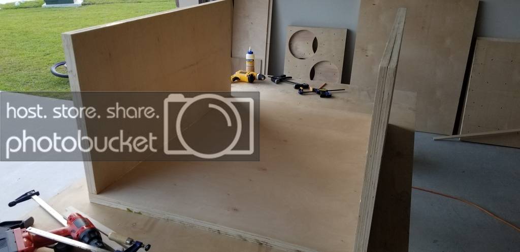

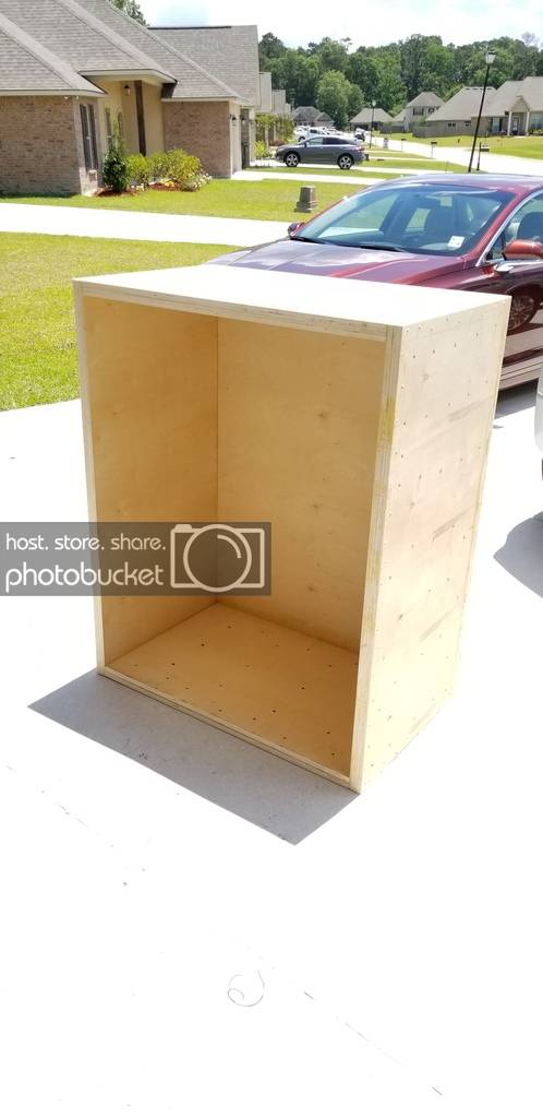

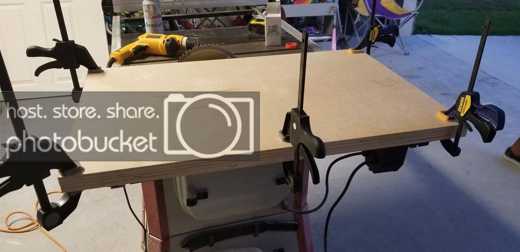

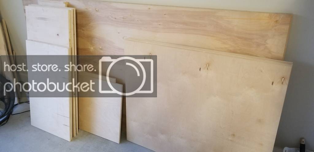

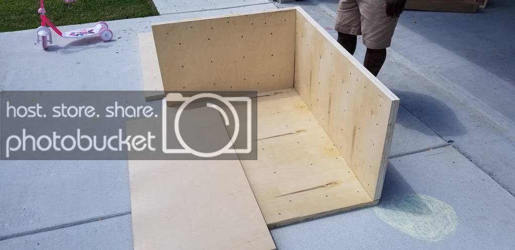

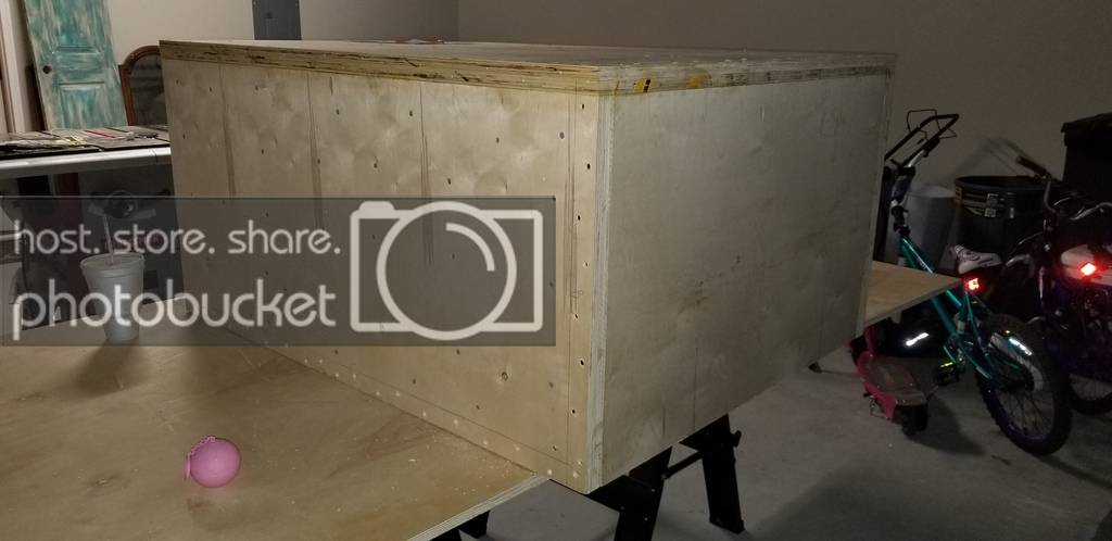

Got the final numbers figured after starting the build. 6 sealed 10.55 ported. Would have liked to have another couple cubes ported but I believe it will be fine. I still think it will be quite a bit louder and perhaps it'll be flatter across the bandwidth. Pics coming in a bit.
Thinking about bumping port area up from 180 to 220. Same tuning. Gonna have to run the port about 2 inches external of the loading wall. Thinking of aesthetic ways to do it so it still looks nice.
