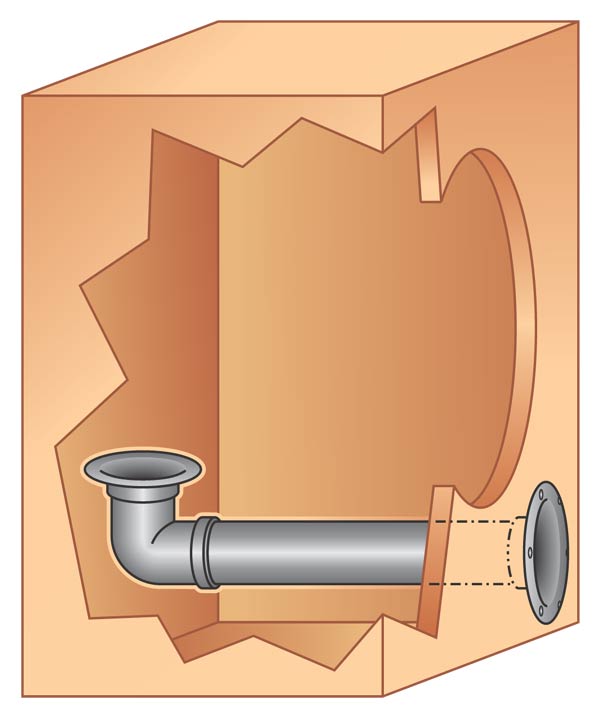

Can I turn my sealed into a ported?

I use PVC to be honest, but flared ports are better. The flare helps with keeping the air flow smooth instead of turbulent. Problem is that the flares might not fit inside of your box. The flare will work for the port exit at the wall of the enclosure but might be too big for the inside. Maybe you can use the flare only on the outside and keep it straight on the inside.

Ya i didnt even think about that, I doubt the flare will fit on the inside of the box without hitting the back of the box. How do you suggest I attach the PVC to the box? Sorry im just a super nube when it comes to aero ports.
All you do is cut the hole big enough for the curve to fit in and then screw the face of the port into the outside wall..
and since you're not using the internal flare, it should just slide all the way in until the outside flare hits the wall. then throw some silicone sealer under the flare against the face of the box and screw it down.
Seems a little small to me for a type R but it should be alright with a little higher tuning...
I figure a 3" aero 9" long should put him at roughly 34-35ish after displacements are subtracted, which I believe is sufficient. Not a whole lot you can do when you're turning a prefab sealed box into a ported one.
I was just going to go with PVC pipe since I can just grab some from my old job.
If mounting PVC, it depends on how good you are with power tools I guess. I have a nack for cutting almost perfect holes with a jigsaw so I just outlined the PVC outer diameter on the enclosure face with pencil and cut the hole just on the inside of that sketch to where the port was snug in the hole, then just slid it in until it was flush with the outer surface and ran some silicone around it for safe measure. If you have a hole saw that is the exact diameter as the port, you can just use that.
