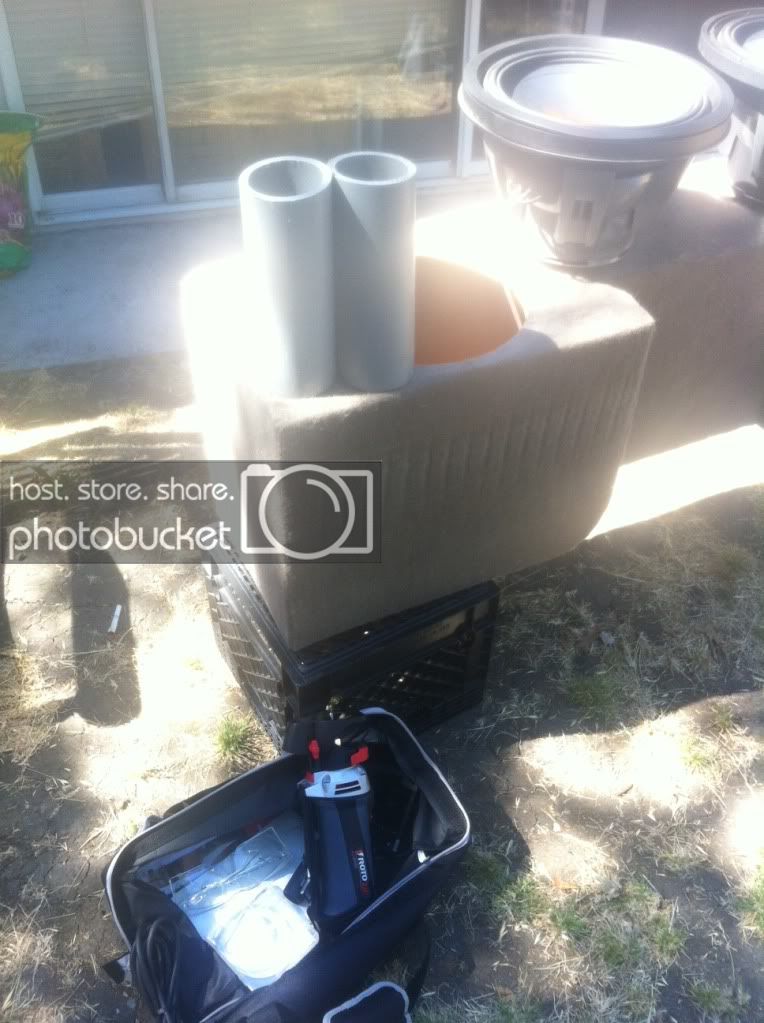

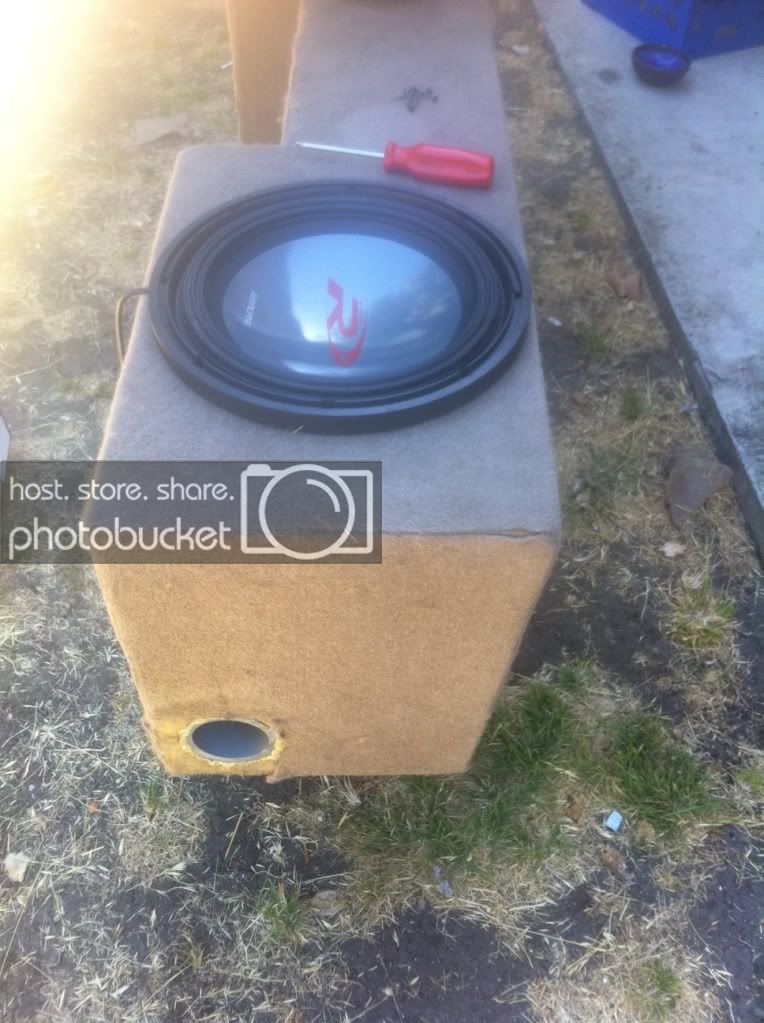

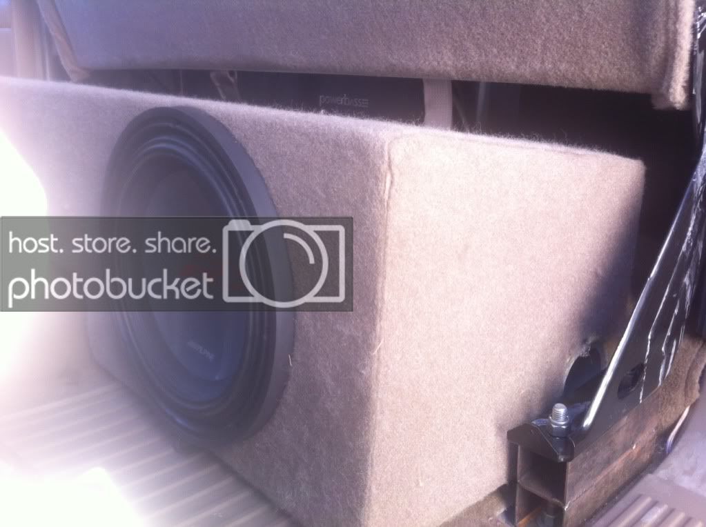

So picked up everything I needed today from my old job and it took me about an hour and a half to finish. Hooked it back up in my truck and just from turning up just a bit I can already tell a huge difference. Just want to wait at least over night before I turn it up to let the sealant to dry. Ill try to get a video together this week.

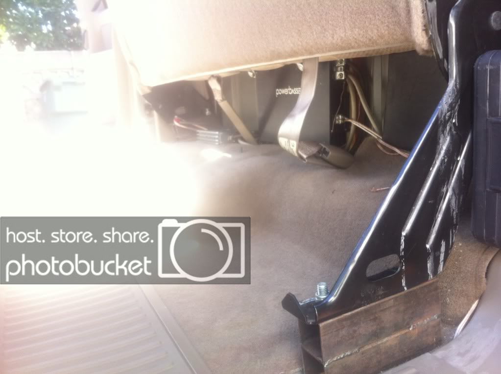

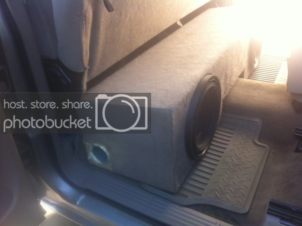

It looks like you should have ported the bottom corner facing forward..that big bracket looks like it is blocking half of the port diameter too close to the port. The ports should not have any obstruction within 3" of them (3" port = 3" clearance) This may be old school theory, but it is a rule of thumb I have always followed. Perhaps others here can offer advice.
da truf. looks like the passenger side is perfectly clear but that one is pusing air into a bracket. might not be too bad afterall though. just crank it a little tomorrow and let us know how it goes. my single cab box is loading into the lowest and deepest corner of the passenger side but it slams.
Ya I was concerned about how close that port was to the bracket, but i guess there isnt much i can do about it now. lol But ill let you guys know how it sounds tomorrow.

Anyway, yea when you have a lifted seat I don't suggest porting out the side really. However, I would bet it won't harm to much in your case.
How it the output now compared to before?

Definitely a huge difference. I am pretty pleased with the difference it has made. Seems its hitting the lows a lot better now. Not just loud obnoxious bass, finally feel the deep tones.
