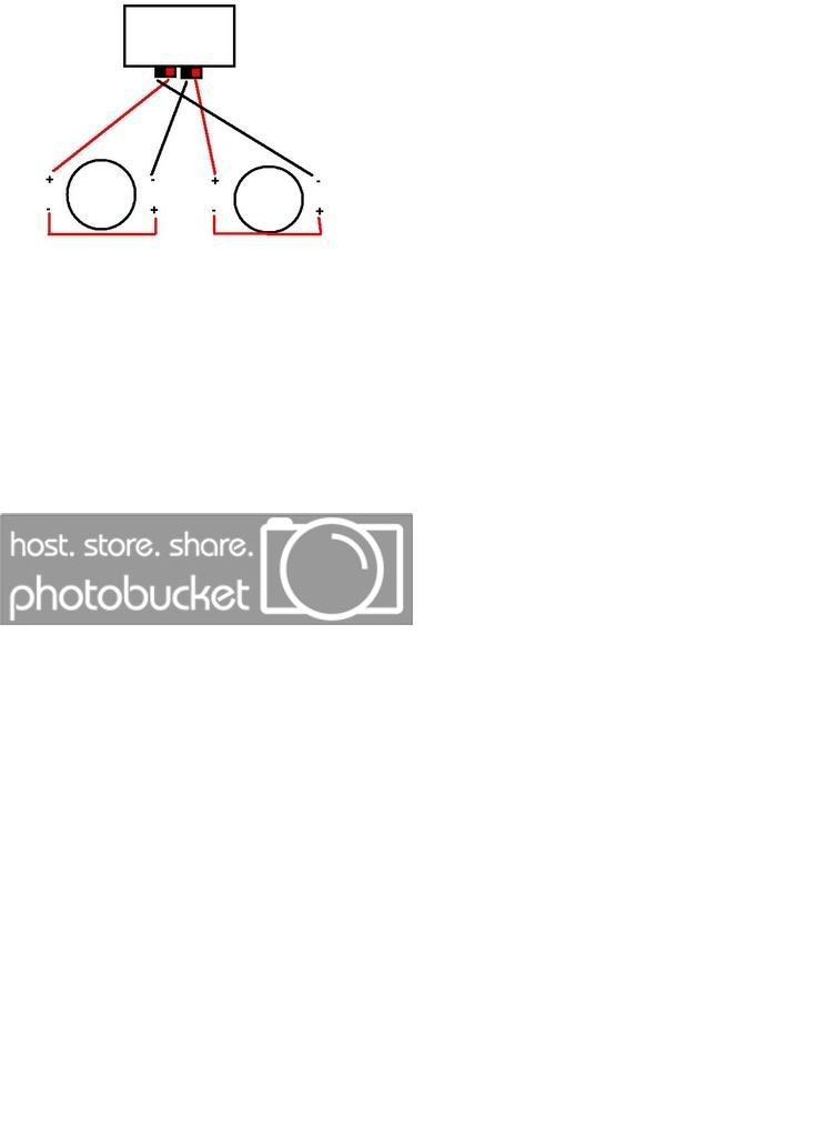

Can I hook up this together?
Octavio
If yes .... please tell me how ............ I wanna get this and hook up ....
1. 200x2 Kickers
2. CVR8 (2 sub)
any help would be apreciated it.
Sub
http://sonicelectronix.com/item_3413.html
Amp
http://sonicelectronix.com/item_6591.html
item_3413.html
what kind od sub would go here?
200W RMS (continuous) x 2 @ 4 ohms
dual vioce coil 2 or dual voice coil 4? I don't get it can someone please explain
If a sub is dual 2 ohms those that mean is a 4 ohms sub? right
But you have two dual 2 ohm subs. In that case, you can wire to 8 ohms, .5 ohms, or 2 ohms.
Series wiring:
R1 + R2 + R3 + R4 = Rtotal; where Rn= each coil.
Parallel wiring 1/R1 + 1/R2 + 1/R3 + 1/R4 = 1/Rtotal
You can use each method together to get different values. For instance, if you wire two dual 4 ohm subs in series and parallel, you will get 4 ohms.
Sub 1 parallel coils:
1/4 + 1/4 = 1/2 = 1/Rtotal... Rtotal = 2ohms
Sub 2 parallel coils:
Now them in series with each other:
2 + 2 = 4ohms final load.
It's simple math. Remember it and never look like an idiot again.
