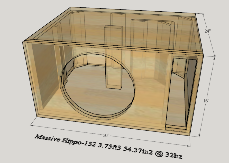

Height limited enclosures can be a challenge, my sons car had 16"h max with the width/depth he needed for 3.75ft3 net to drop into the trunk. The sub was 15.625" OD iirc so I had to change how I usually do the port, instead of "sandwich" construction we had to router out the baffle for the port exit.

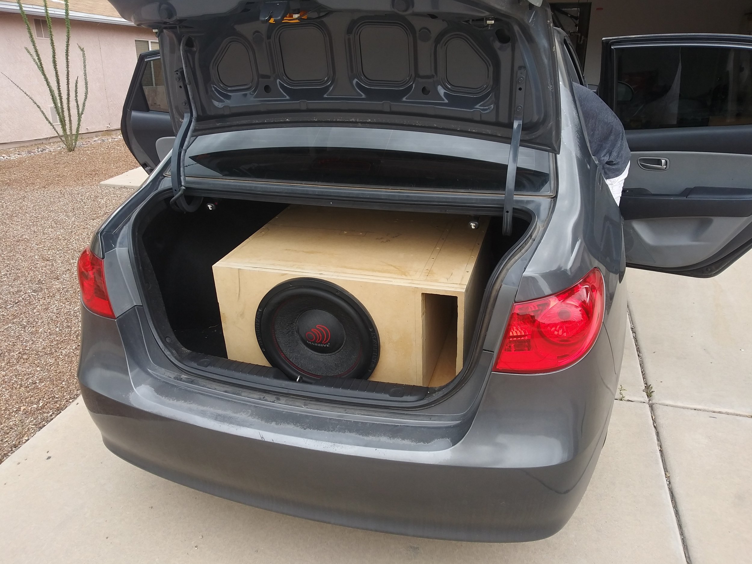

after all the measuring we did I was confident it would drop in there... and voila'...
21165
15" Hippo in an Elantra, he's happy.
