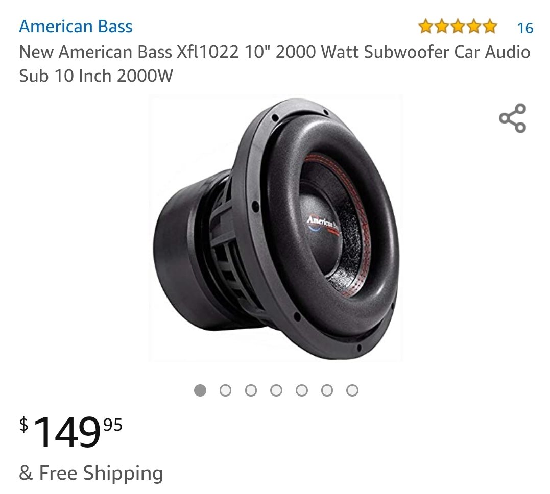

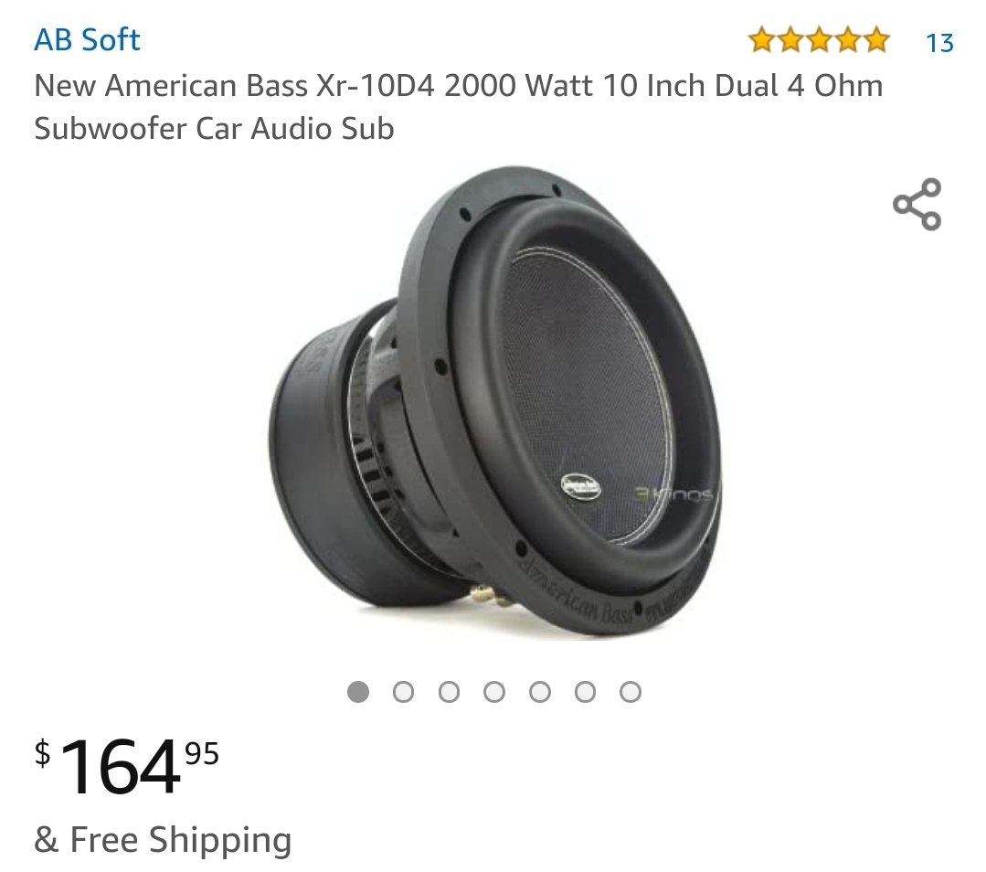

Steer clear of Skar. American Bass or Sundown is a better option.
Preferably less than $150. I want a sub for sq and to bring out the bass in my daily music. I listen to folk, pop, rock, jazz, kinda everything
One of these should work for you. I don't know which amp you are using. Buy a DVC2 if your amp is one ohm stable.
Skar likes to lie about their TS specs. Be aware.
